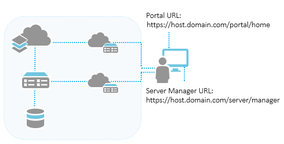

When the components are fully configured, you will see an ArcGIS Enterprise status page indicating that the deployment has been successfully configured.

Example portal and Server Manager URLs after configuration
Using the links provided in the configuration summary, you can begin to customize your portal, add members and content, and configure security. Additionally, use Server Manager to manage published services. To access ArcGIS Server Manager after the builder is complete, use the full URL, which is formatted as https://gisserver.example.com:6443/arcgis/manager/.
