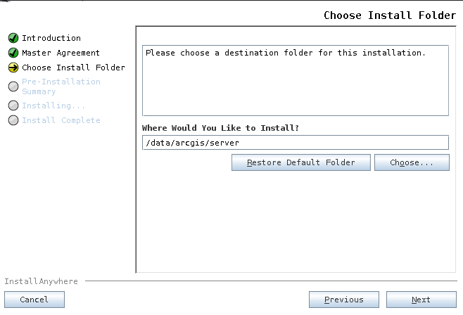

On the Choose Install Folder dialog box, specify the installation location.
Note:
The name of the installation directory must be lowercase. The samples and data bundled with the installation require the data path to be lowercase.

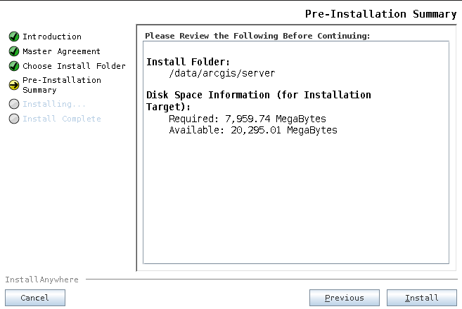

On the Pre-Installation Summary dialog box, click Install to start the installation.
Note:
Approximately 1.5 GB of the required disk space is used only during the installation of the product. This temporary disk use ceases at the end of the installation.

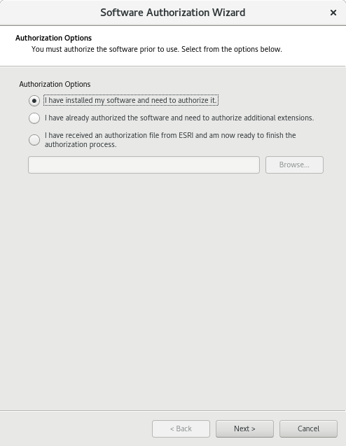

You can configure your machine using three methods:

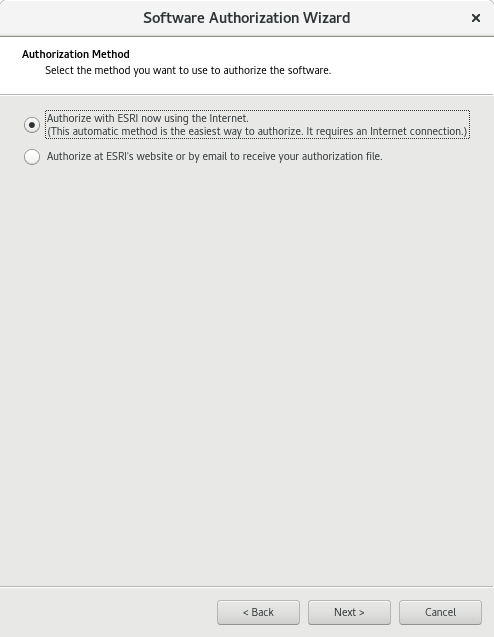

I have installed my software and need to authorize it.
Select this option if you do not already have an authorization file. When this option is selected, there are several methods to provide your authorization information. Select the authorization method you want to use (see the Authorization Method screenshot below). This is the method by which you will provide your authorization information.
I have already authorized the software and need to authorize additional extensions.
Select this option if you have already authorized ArcGIS Server but want to authorize additional extensions (if available). When this option is selected, there are several methods to provide your authorization information. Select the authorization method you want to use (see the Authorization Method screenshot below). This is the method by which you will provide your authorization information.
Tip:
Authorizing now using the internet allows you to receive the authorization file immediately. It requires an internet connection.

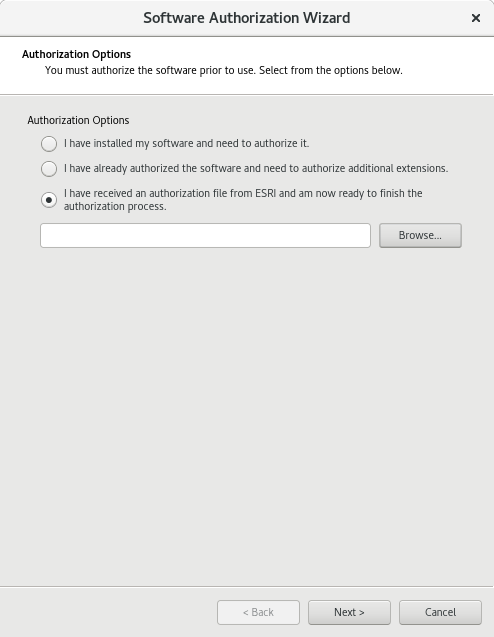

I have received an authorization file from Esri and am now ready to finish the authorization process.
Select this option if you have already received your authorization file from Esri Customer Service. With this option, you can browse to the location of the file received from Esri Customer Service to complete your authorization.

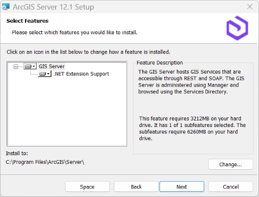

The setup program displays the features that will be installed.
GIS Server—Hosts GIS services that can be accessed through REST and SOAP. It is administered using ArcGIS Server Manager and its services are browsed through the Services Directory. This feature is required and includes support for publishing and hosting ArcGIS Pro-based services.
.NET Extension Support—Supports the development and deployment of .NET server object extensions (SOEs) and server object interceptors (SOIs). This feature is optional. The appropriate version of Microsoft .NET is required for the .NET Extension Support feature to be displayed as a feature to be installed.
Note:
See the ArcGIS Server system requirements for the currently supported version of Microsoft .NET.

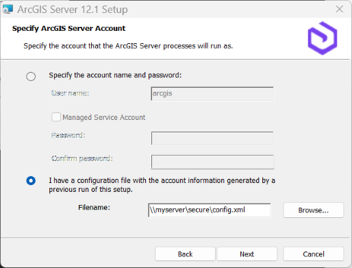

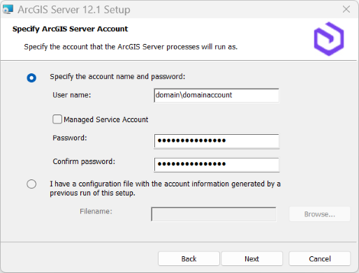

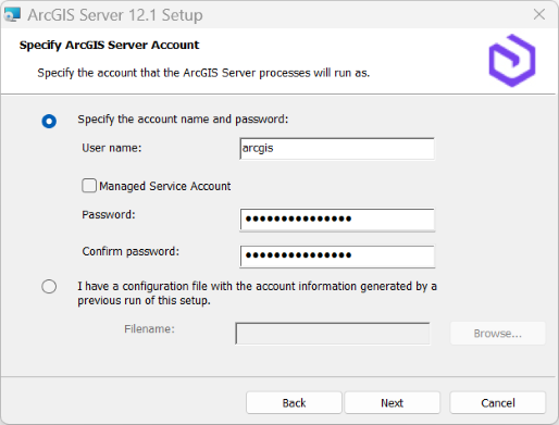

Specify the account to be used by ArcGIS Server to perform a variety of functions.
You are presented with two options: Specify the account name and password and I have a configuration file with the account information generated by a previous run of this setup.
The first option, Specify the account name and password, allows you to directly specify the account name and password. The account can be a local account, domain account, or Managed Service Account. It is recommended that you use an account that is not a member of the Administrators group and that has minimal privileges. If you use a Managed Service Account, the account must already be configured for your machine. If you use a local operating system account, the account is created if it does not already exist. The default account name is arcgis. For more information, see ArcGIS Server account.
Note:
For production systems, it's recommended that you use a preexisting account that resides in your domain or active directory and follows your organization's security policy. Creating a local account during the installation is primarily for the convenience of quickly installing ArcGIS Server.
If you provide a domain account, it must already exist on the domain and must be entered using the following format:
If you have a server configuration file generated by previously running the ArcGIS Server setup, choose the I have a configuration file option. Browse to the location of the server configuration file. The ArcGIS Server account is automatically configured with account information stored in the configuration file.

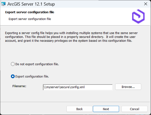

If you chose Specify the account name and password and manually entered the ArcGIS Server account information, the next dialog box presents you with the option to export a server configuration file. If you do not want to export a configuration file, click Next and accept the default Do not export configuration file option. If you want to export a server configuration file for future installations, choose Export configuration file, browse to a secure folder, and enter a name for the configuration file.
The ArcGIS Server account information is exported to the specified server configuration file.
Note:
There are several reasons you may want to export a server configuration file, including the following:
Create the same ArcGIS Server account when installing on multiple machines.
Store the account for use when upgrading to a newer version.
Perform a silent installation in which the username and password are encrypted.
Caution:
When exporting a server configuration file to a network share, the Local System account on the machine where ArcGIS Server is being installed must have write permissions to the network share. For example, if you're installing ArcGIS Server on a machine named Quick, the Local System account on Quick must have write permission to the network share. If the permissions are not set, the server configuration file may not export successfully. If you are unsure how to correctly set permissions for the network share, contact your system administrator or export the server configuration file locally and copy it to the network share.
