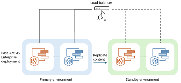

This downtime can be avoided for organizations with an identical, isolated standby environment. As an administrator, you can upgrade your standby environment while your production environment remains accessible, reducing risk and minimizing the time your organization is unavailable. If something unexpected occurs, you can spend time investigating rather than rolling back to the previous version.
Standby environment
Once the upgrade is complete and you have performed any necessary quality assurance on the environment, you can send traffic to the standby environment and users can use the new functionality and features while you upgrade the primary.
Optionally, you can put your production environment in read-only mode, ensuring that your organization remains accessible while also eliminating the risk of managing data differences and the potential of data loss.
If your organization has not implemented a replicated environment, you can set one up by migrating to a new machine or set of machines using the WebGISDR tool.
