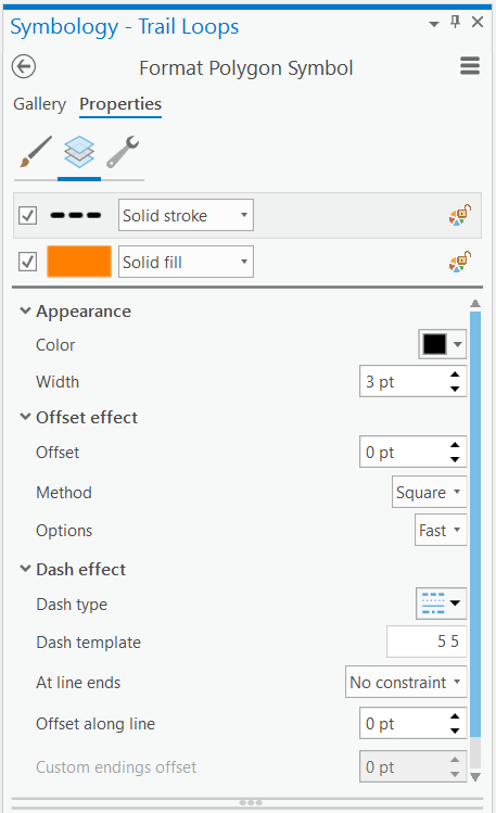

Example 3: Modify layer symbology
This example demonstrates how further nested the CIM object model can be and also shows the advantage of CIM-level access. The managed arcpy.mp API has limited access to renderers and depth of properties. It can only modify simple properties and only for the default layer of a symbol. However, the CIM can access a symbol with multiple layers. The following screenshot shows settings in the application that are not available to the arcpy.mp API:
The Symbology pane for a polygon feature layer
Below is an edited and simplified JSON file that only displays the renderer information for a layer's symbology. The renderer, which is a CIMSimpleRenderer, has a symbol property that represents a CIMSymbolReference and has a symbol property which is a CIMPolygonSymbol and it has two symbolLayers: CIMSolidStroke and CIMSolidFill, each of which displays the properties that are available in the Symbology pane.
  "layerDefinitions" : [
      "renderer" : {
        "type" : "CIMSimpleRenderer",
        "patch" : "Default",
        "symbol" : {
          "type" : "CIMSymbolReference",
          "symbol" : {
            "type" : "CIMPolygonSymbol",
            "symbolLayers" : [
                "type" : "CIMSolidStroke",
                "effects" : [
                    "type" : "CIMGeometricEffectDashes",
                    "dashTemplate" : [ 5, 5],
                    "lineDashEnding" : "NoConstraint",
                    "controlPointEnding" : "NoConstraint"
                "enable" : true,
                "capStyle" : "Round",
                "joinStyle" : "Round",
                "lineStyle3D" : "Strip",
                "miterLimit" : 10,
                "width" : 3,
                "color" : {
                  "type" : "CIMRGBColor",
                  "values" : [0, 0, 0, 100]
                "type" : "CIMSolidFill",
                "enable" : true,
                "color" : {
                  "values" : [ 255, 127, 0, 100 ]
The following Python code uses CIM access to modify the layer's symbology. Both symbol layers are modified.
# Reference a project, map, and layer using arcpy.mp
p = arcpy.mp.ArcGISProject('current')
m = p.listMaps('Trail Routes')[0]
lyr = m.listLayers('Loops')[0]
# Return the layer's CIM definition
cim_lyr = lyr.getDefinition('V3')
# Modify the color, width and dash template for the SolidStroke layer
symLvl1 = cim_lyr.renderer.symbol.symbol.symbolLayers[0]
symLvl1.color.values = [250, 250, 40, 50]
symLvl1.width = 8
ef1 = symLvl1.effects[0]    #Note, deeper indentation
ef1.dashTemplate = [20, 30] #Only works if there is an existing dash template
# Modify the color/transparency for the SolidFill layer
symLvl2 = cim_lyr.renderer.symbol.symbol.symbolLayers[1]
symLvl2.color.values = [140, 70, 20, 20]
# Push the changes back to the layer object
lyr.setDefinition(cim_lyr)

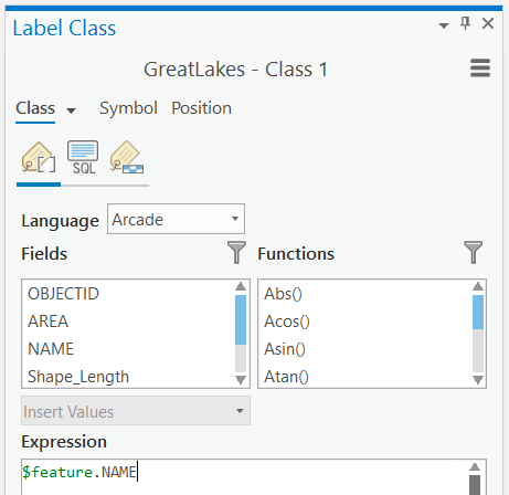

Example 2: Don't get the application into an odd state
In this example, the expression engine associated with a layer's labeling properties is modified in the CIM. In the screenshot below, the expression engine is changed from Arcade, the default, to Python. Below are graphics of what it looks like in the UI and how the JSON portion appears.
The Label Class expression pane for a feature layer
      "labelClasses" : [
          "type" : "CIMLabelClass",
          "expression" : "$feature.NAME",
          "expressionEngine" : "Arcade",
          "featuresToLabel" : "AllVisibleFeatures",
          "maplexLabelPlacementProperties" : {
          "name" : "Class 1",
          "priority" : -1,
          "standardLabelPlacementProperties" : {
          "textSymbol" : {
          "useCodedValue" : true,
          "visibility" : true,
          "iD" : -1
The following is a Python script that changes only the expressionEngine and not the expression. This causes the application to behave erratically. For example, after running the code below, when you review the label properties for the layer, the expressionEngine is properly set to Python, but the expression still appears in Arcade format. In the user interface, when you change the expression engine back to Arcade, the expression displays in Python format, the opposite of what it should be. To avoid this, it is important that you update both the expressionEngine and expression properties.
# Update the label expression engine from Arcade, the default, to Python.
# You must also update the expression otherwise the UI won't behave correctly after.
m = p.listMaps('Map')[0]
l = m.listLayers()[0]
l_cim = l.getDefinition('V3')
lc = l_cim.labelClasses[0]
lc.expressionEngine = 'Python'    #From 'Arcade'
lc.expression = '[STATE_NAME]'    #From '$feature.STATE_NAME'
l.setDefinition(l_cim)

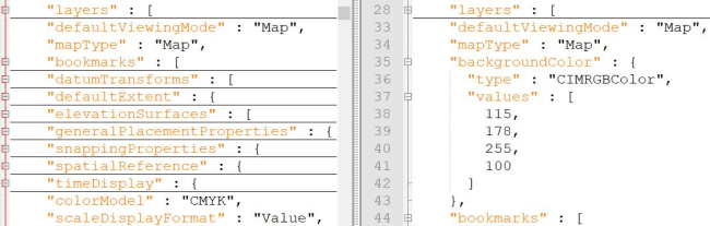

Example 1: Single Class - RGB Color
If you insert a new, default map and return the map's CIM backgroundColor, the value will be a NoneType because the value is not defined in the CIM. By default, a new map's background color is set to No color". You won't even see that member defined in the JSON file. A straightforward way to determine what needs to be done is to author the map with the background color and save the before and after changes as map files (.mapx) and compare the differences. The graphic below, on the left, represents a screenshot of the JSON before changes were made, and the after changes on the right. They are being viewed by a text comparison application called WinMerge. Notice, on the right, that the backgroundColor member has been inserted between the mapType and bookmarks properties. To set a map's backgroundColor, you need to create a color object—in this example, a CIMRGBColor object. The color could have been defined using other color models and the CIM object type, which represents the class type, would be different.
A screenshot of the before and after results of background color being inserted into a JSON file
The following code will create a CIMRGBColor class that is used to set the background color for a map. Note, you may need to turn off your basemap or other layers to see the changes.
m = p.listMaps()[0]
m_cim = m.getDefinition('V3')        #Get the map's CIM definition
#Check to see if a background color exists, if not create a color
if m_cim.backgroundColor is None:
  RGBColor = arcpy.cim.CreateCIMObjectFromClassName('CIMRGBColor', 'V3')
  RGBColor.values = [115, 178, 255, 100]
  m_cim.backgroundColor = RGBColor   #Set the property to the new object
m.setDefinition(m_cim)               #Set the map's CIM definition

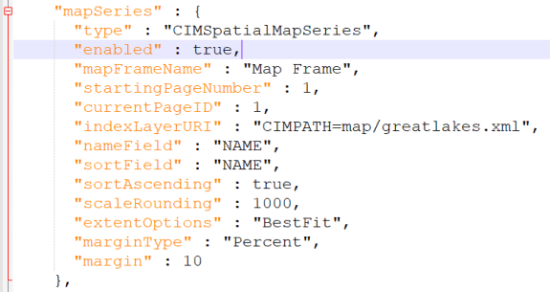

Example 2: Single Class - Spatial Map Series
Creating a spatial map series using the CIM is almost as straightforward as creating an RGB color. A spatial map series is also a single object but with more properties. The graphic below represents a screenshot of how a spatial map series is persisted in a JSON file. The indexLayerURI is a concept that is unique to the CIM that is not exposed as a setting in the user interface. The URI is a unique identifier for an object persisted in the CIM to assure reference uniqueness. In the case of the layer, the URI won't change even if you change the layer name. The only way to get the indexLayerURI value is through the layer's CIM definition.
A screenshot of the results of a spatial map series being inserted into a JSON file
The following code will create a CIMSpatialMapSeries class that is used to author a new spatial map series for a layout. The example includes the extra lines of code to get the layer's URI value. Note, the get/setDefinition functions need to be called a second time to ensure the Map Series Pages tab refreshes in the Contents pane.
m = p.listMaps('GreatLakes')[0]
l = m.listLayers('GreatLakes')[0]
l_cim = l.getDefinition('V3')         #Get layer's CIM / Layer URI
lURI = l_cim.uRI                      #Needed to specific the index layer
lyt = p.listLayouts('GreatLakes')[0]
lyt_cim = lyt.getDefinition('V3')     #Get Layout's CIM definition
#Create CIM Spatial Map Series Object and populate its properties
ms = arcpy.cim.CreateCIMObjectFromClassName('CIMSpatialMapSeries', 'V3')
ms.enabled = True
ms.mapFrameName = "Great Lakes MF"
ms.startingPageNumber = 1
ms.currentPageID = 2
ms.indexLayerURI = lURI               #Index layer URI from Layer's CIM
ms.nameField = "NAME"
ms.sortField = "NAME"
ms.sortAscending = True
ms.scaleRounding = 1000
ms.extentOptions = "BestFit"
ms.marginType = "Percent"
ms.margin = 10
lyt_cim.mapSeries = ms                #Set new map series to layout
lyt.setDefinition(lyt_cim)            #Set the Layout's CIM definition
#Force a refresh of the layout and its associated panes

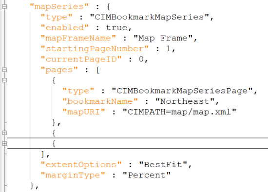

Example 3: One Dependent Class - Bookmark Map Series
The previous two examples showed CIM classes with simple properties. As stated earlier in this topic, there will be times when a newly created CIM object has property values that are dependent on other CIM objects. The CreateCIMObjectFromClassName function does not automatically create all dependent subclasses, and it is up to you to use the same method to create those dependent objects as well. The CIMBookmarkMapSeries class is an example. It has a property called pages, which is a collection of individual CIMBookmarkMapSeriesPage objects. The following is a screenshot of how a Bookmark Map Series is persisted in a JSON file. You should notice that the CIMBookmarkMapSeriesPage class is nested inside of the CIMBookmarkMapSeries class. Each page is defined by its bookmarkName and each bookmark has a mapURI that is a unique identifier for the map with which the bookmark is associated.
A screenshot of the results of a bookmark map series being inserted into a JSON file
The following code will create a CIMBookmarkMapSeries class and multiple CIMBookmarkMapSeriesPage classes that are used to author a new Bookmark Map Series for a layout. A bookmark map series requires a reference to a map's URI and similar to a layer's URI, you can only get that value from the map's CIM definition.
#Get map URI from map CIM
mURI = m_cim.uRI
#Get Layout CIM
lyt = p.listLayouts('No Map Series')[0]
#Create the CIMBookmarkMapSeriesPage(s) necessary for creating the CIMBookmarkMapSeries
#Iterate through each bookmark in the order you want them added to the map series
bkmkNames = ["Northeast", "Southeast", "Northwest",]
pageList = []
for bkmk in bkmkNames:
  bkmkPage = arcpy.cim.CreateCIMObjectFromClassName('CIMBookmarkMapSeriesPage', 'V3')
  bkmkPage.bookmarkName = bkmk
  bkmkPage.mapURI = mURI
  pageList.append(bkmkPage)
#Create a Bookmark Object and populate
bmMS = arcpy.cim.CreateCIMObjectFromClassName('CIMBookmarkMapSeries', 'V3')
bmMS.enabled = True
bmMS.mapFrameName = "Map Frame"
bmMS.startingPageNumber = 1
bmMS.currentPageID = 0
bmMS.extentOptions = "BestFit"
bmMS.marginType = "Percent"
bmMS.pages = pageList
#Set map series to layout and set the layout CIM definition
lyt_cim.mapSeries = bmMS
