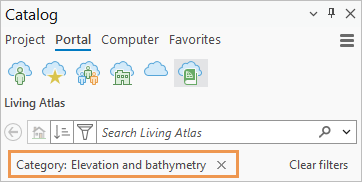

  3. Click the Living Atlas tab .
  4. Next to the search box, click Filter .
  5. In the drop-down list, expand Categories and expand Environment. Click Elevation and bathymetry.
    Living Atlas categories menu
  6. At the top of the drop-down list, click Close.
    In the Catalog pane, the list of ArcGIS Living Atlas items is filtered to show maps and layers related to elevation. Above the list of items, a filter chip labeled Category: Elevation and bathymetry appears.
    Catalog pane showing the filter chip
    If the Catalog pane is too narrow to display the name, the label on the filter chip is +1.

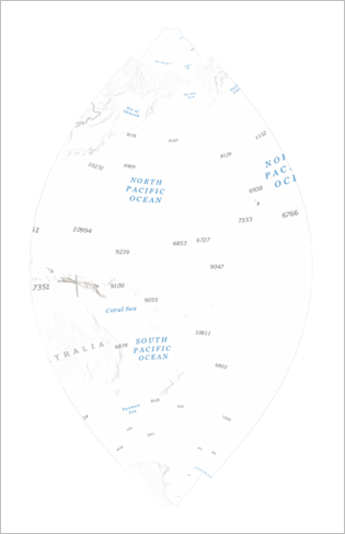

  9. Right-click the World Hillshade layer and click Add To Current Map .
    By default, the map zooms to the extent of the World Hillshade layer, which covers the whole world. However, the extent is constrained by the local New Zealand map projection that has been set for the map.
  10. On the ribbon, click the Map tab. In the Navigate group, click Previous Extent to return to Wellington.

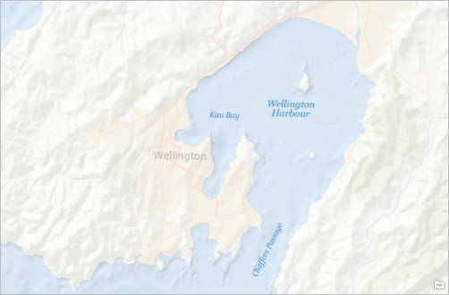

  14. In the search box, type light gray canvas reference and press the Enter key.
    A vector tile layer named Light Gray Canvas Reference (Local Language) appears at or near the top of the search results.
  15. Right-click the Light Gray Canvas Reference (Local Language) layer and click Add To Current Map .
  16. In the Contents pane, right-click the World Ocean Reference layer and click Remove .
    Now you have just one layer of place-names in the map.
  17. In the Contents pane, click the Light Gray Canvas Reference (Local Language) layer to select it.
  18. On the ribbon, click the Vector Tile Layer tab.
  19. In the Effects group, in the Transparency box , highlight the default value of 0.0% and type 25. Press the Enter key.
    Tip:
    Alternatively, click the Transparency drop-down arrow and set the value with the slider.
    At very large map scales, the place-names are not necessary. You'll set a visibility range so the layer doesn't display when you zoom in beyond a specified scale.
  20. In the Visibility Range group, click the drop-down arrow next to Maximum Scale and click 1:24,000.
    The place-names won't display when you zoom in closer than 1:24,000.

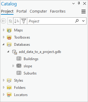

Every ArcGIS Pro project has a default geodatabase for storing project data. In a new project, the default geodatabase is empty until you add data to it—for example, by running a geoprocessing tool. The default geodatabase in this project already contains a few datasets.
  1. In the Catalog pane, click the Project tab. Browse to Databases > add_data_to_a_project.gdb.
    Catalog pane with Databases folder expanded
    The geodatabase contains two feature classes (Buildings and Suburbs) and a raster dataset (slope). You'll add the Suburbs data to the map.

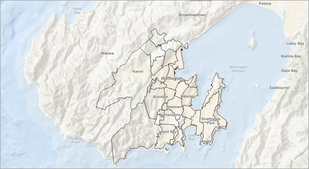

    The Suburbs layer has a solid fill color that prevents you from seeing the basemap under it. You'll change the symbol fill color and outline.
  5. In the Contents pane, right-click the Suburbs layer and click Symbology .
    The Symbology pane appears. At the top of the pane, the Primary symbology tab is selected. The primary symbology method is Single Symbol, which means that all features in the layer have the same symbol.
  6. In the Symbology pane, click the symbol for the layer.
    The pane changes to show symbol formatting options. On the Gallery tab, you can browse or search for symbols. On the Properties tab, you can change the properties of the current symbol.
  7. In the Symbology pane, under Format Polygon Symbol, click the Properties tab.
  8. On the Symbol tab , under Appearance, click the Color drop-down arrow and click No color.
  9. Click the Outline color drop-down arrow and click Black.
    Color palette with Black indicated (row 10, column 1).
  10. At the bottom of the pane, click Apply.
    Map of suburb boundaries

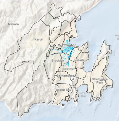

  2. Right-click Flood_Zone_Wellington.shp and click Add To Current Map .
  3. In the Contents pane, drag the Flood_Zone_Wellington layer under the Suburbs layer.
  4. In the Contents pane, click the symbol for the Flood_Zone_Wellington layer.
    Tip:
    Clicking a symbol in the Contents pane opens the Symbology pane to symbol formatting options.
  5. In the Symbology pane, under Format Polygon Symbol, click the Properties tab if necessary.
  6. On the Symbol tab , under Appearance, click the Color drop-down arrow and click Big Sky Blue.
    Color palette with Big Sky Blue indicated (row 3, column 9).
  7. In the Outline width box, highlight the default value and type 0. Press the Enter key and click Apply.
    The map shows that most of the flood risk zone lies within one suburb.
    Map of suburb boundaries and flood risk zone

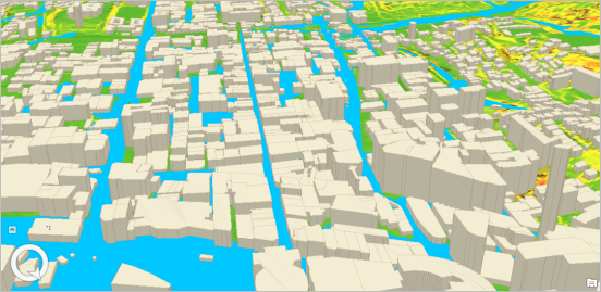

    The project contains two bookmarks to help you explore the flood zone.
  9. On the ribbon, click the Map tab if necessary. In the Navigate group, click Bookmarks . Under Wellington 3D Bookmarks, click Flood View 1.
    Buildings and flood zone in Te Aro suburb
    The scene zooms to the bookmark. In the lower left corner of the view, notice the direction of the north arrow on the on-screen navigator . Your view faces south, or slightly southwest. It looks like a flood would affect most of the buildings in the foreground of the view.
  10. Click Bookmarks again and click Flood View 2.
    This view shows how floodwater may flow through the landscape at the western end of the suburb. Use the Explore tool on the Map tab or the on-screen navigator to continue exploring the suburb.
