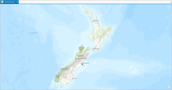

    The project opens with a map view of New Zealand. You'll zoom in to the study area of Christchurch. With a population of about 400,000, Christchurch is the second-largest city in New Zealand.
    Map of New Zealand
  7. On the ribbon, click the Map tab if necessary. In the Navigate group, click Bookmarks and click Christchurch Urban Area.
    The map zooms in to the urban area. The Urban Area layer is symbolized with a light-green fill color and a black outline.

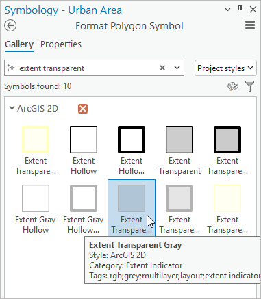

  7. In the search box, type extent transparent and press the Enter key.
    In the ArcGIS 2D style, several symbols are available with different colors and outlines. You can hover over the symbols to get more information.
  8. Click the Extent Transparent Gray symbol to select it.
    Note:
    You may have fewer results if semantic search is not enabled.

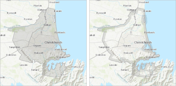

    The symbology for the Urban Area layer updates on the map and in the Contents pane. You can see through the symbol to the basemap underneath. This is a good start, but your goal is to create the effect of a shaded boundary with a transparent interior.
    Side-by-side examples of symbology for the Urban Area layer
    First image: The urban area is currently symbolized with a partly transparent gray fill. Second image: The desired effect is a shaded boundary with a fully transparent interior.

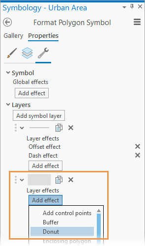

  12. On the Structure tab, under Layers, under the gray fill symbol layer, click Add effect. On the drop-down menu, click Donut.
    Structure tab of the Symbology pane
    The effect is previewed in the window at the bottom of the pane. Now that you have applied the effect, you'll specify its width on the Layers tab.
  13. Click the Layers tab .
  14. Click the Solid fill symbol layer to work with its properties. Expand the Donut effect heading and change the Width setting to 6 pt.
    Layers tab of the Symbology - Format symbol pane
    The symbol preview is updated at the bottom of the pane.

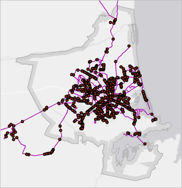

  16. In the Contents pane, turn on the Bus Stops and Bus Routes layers.
    You'll change the symbology of both layers in the next sections. First, you'll choose a more neutral basemap.

The current symbol for the Bus Stops layer is a small dark circle. You'll replace it with a more appropriate symbol.
  1. In the Contents pane, click the Bus Stops layer to select it.

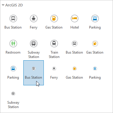

  3. At the top of the pane, click the Gallery tab.
  4. In the search box, type bus and press the Enter key.
    Bus station symbols
    In the ArcGIS 2D style, several symbols are found. You'll use a bus station symbol to represent bus stops.
    Note:
  5. Click the smallest bus station symbol to select it.
    The map and Contents pane update with the new symbol. You'll change the symbol properties.

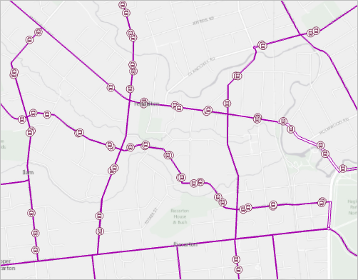

    The symbol is updated on the map and in the Contents pane. At the current map scale, the symbols clutter the map. You'll set a visibility range for the layer so the symbols display only when the map zooms in.
  14. In the Contents pane, select the Bus Stops layer if necessary.
  15. On the ribbon, click the Feature Layer tab. In the Visibility Range group, click the drop-down arrow next to Minimum Scale and click 1:24,000. (If this value doesn't appear in the list, you can type it in the box.)
    The symbols disappear from the map. In the Contents pane, the layer's check mark is gray. This means that the layer is turned on but not visible at the current map scale.
  16. In the Contents pane, right-click the Bus Stops layer and click Zoom To Make Visible .
    Map with bus stops symbolized
    The map zooms in to a scale of 1:24,000 and the bus stops display.

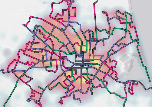

Symbolize the bus routes
The bus routes are currently drawn with a single symbol. The attribute table for the layer contains attributes such as route names, route directions, and route types that can be used to symbolize the features in more meaningful ways.

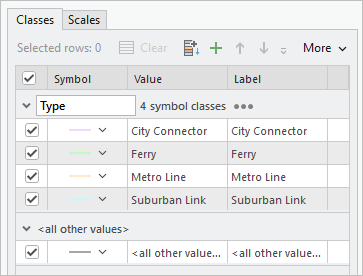

  5. In the Symbology pane, click the Primary symbology drop-down arrow and click Unique Values.
  6. Click the Field 1 drop-down arrow and click Type.
    In the lower half of the pane, on the Classes tab, symbols are assigned to the unique values in the Type field. The map and the Contents pane are updated with these symbols.
    Unique value symbols for bus routes
    Your symbol colors may be different.
    There is also a gray symbol representing all other values. You don't need this symbol for this layer.
  7. In the Symbology pane, on the Classes tab in the lower half of the pane, click More and uncheck Include all other values.
    The <all other values> symbol is removed.

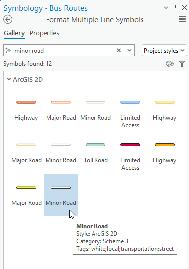

  9. At the top of the pane, click the Gallery tab. In the search box, type minor road and press the Enter key.
  10. In the ArcGIS 2D style, click the Minor Road symbol with the black outline.
    Minor road symbols in the symbol gallery
    Note:

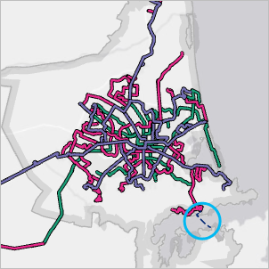

    You'll change the Ferry symbol because ferry routes are conventionally symbolized with dashed lines.
  14. In the lower half of the pane, click the line symbol for Ferry to show the symbol gallery.
  15. In the search box, type ferry and press the Enter key. In the ArcGIS 2D style, click the Ferry symbol.
    Ferry symbol selected in the Symbology pane
    Note:
    On this map, the ferry symbol would look better if it were darker.
  16. At the top of the pane, click the Properties tab. On the Symbol tab , under Appearance, click the Color drop-down arrow and click Dark Navy. Click Apply.
    Color palette with Dark Navy indicated (row 6, column 10).
    The symbol updates in the Contents pane and on the map.
    Map with updated ferry symbol

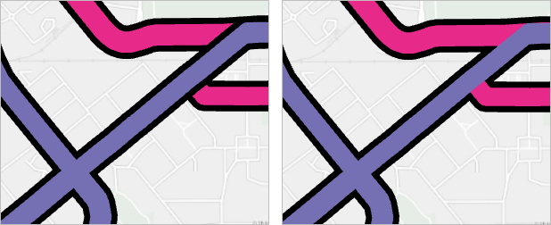

Improve the symbology with symbol layer drawing
The bus route symbology can be further improved. You'll use symbol layer drawing for more control over the symbology at road crossings and overlaps. For example, in the first image below, suburban link routes cross each other. You'll remove the road casings (black outlines) at the intersections. In the second image, a blue metro line and a red suburban link share the same route, and a suburban Link crosses a city connector. You'll specify which features in the layer draw on top of which others.
Examples of road intersections and overlaps
  1. At the top of the Symbology pane, click Return to primary symbology page .
  2. At the top of the pane, click the Symbol layer drawing tab .
  3. Click Enable symbol layer drawing.
    Enable symbol layer drawing setting
  4. On the Basic tab, drag Metro Line to the top of the Drawing Order list.
  5. Drag Ferry to the bottom of the list.
    Bus route symbols in assigned drawing order
    The map updates as you change the drawing order. Metro line features now draw on top of other bus routes, which means that a metro line is never visually interrupted by another route. Likewise, city connector features draw on top of suburban link features.
    Note:
    Symbol drawing order is independent of the order of symbol classes in the Contents pane. In the Contents pane, the symbol classes, representing the four unique route types, are still in their default alphabetical order. You can change this order by dragging symbol classes up and down on the Primary symbology tab .
    In the Symbology pane, notice that three of the routes are set to Join. This setting removes road casings where features of the same route type intersect. You'll change the setting to Join and Merge to remove road casings at intersections between different route types.
    Examples of the Join setting and the Join and Merge setting
    In the first image, the Join setting removes road casings where features of the same route type intersect. In the second image, the Join and Merge setting also removes road casings where features of different route types intersect. (The casings are not actually removed—they are drawn over.)
  6. Click the drop-down arrow next to City Connector and click Join and Merge. Click the drop-down arrow next to Suburban Link and click Join and Merge.
    The map updates to reflect the settings. You don't see a close-up view of the effect because symbols and text, by default, remain the same size on your map as you zoom in and out. Optionally, you can set a map reference scale to make symbols increase or decrease in size as you zoom the map. However, this tutorial assumes that no reference scale is set.
    Note:
    The Join and Merge setting affects the drawing behavior of a symbol in relation to the symbol above it. There is no Join and Merge setting for the Metro Line symbol because it is at the top of the drawing order. Both the Join and Join and Merge settings affect the drawing relationship of a symbol's component symbol layers (in this case, the two stroke layers, representing roads and casings, that make up the bus route symbols). The only available setting for the Ferry symbol is No Join because this symbol is composed of a single stroke layer. For more information, see Symbol layer drawing.

  9. In the Contents pane, drag the Population layer under the Bus Routes layer. (Drag it under the chart associated with the Bus Routes layer.) Ensure that the Population layer is still selected in the Contents pane.
  10. On the ribbon, click the Feature Layer tab. In the Effects group, in the Transparency box , type 65 and press the Enter key.
  11. In the Visibility Range group, click the drop-down arrow next to Maximum Scale and click 1:50,000 to set the maximum display scale for the heat map.
    At scales larger than 1:50,000, the pattern is too local and the heat map looks bubbly.
  12. Zoom and pan to explore the map.
    Map of population density and bus routes
    The bus routes correspond well to the populated parts of the urban area.
