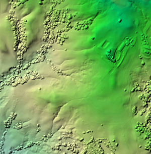

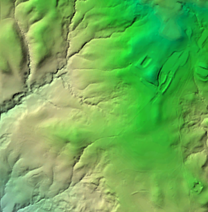

The following graphics show hypsometric hillshade representations of a highest return surface, or DSM, on the left and a bare earth model, or DEM, on the right.
DSM raster DEM raster

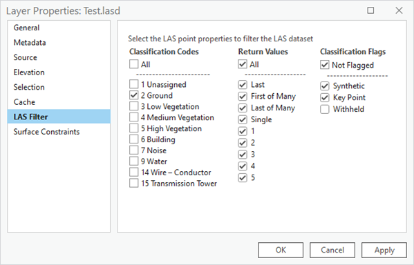

  2. Right-click the LAS dataset layer in the Contents pane, and select Properties.
    The Layer Properties dialog box appears, as shown in the image below.
    LAS dataset Layer Properties dialog box
  3. Click LAS Filter and set the filter properties to be used to generate the DEM or DSM.
  4. Click Apply and OK to close Layer Properties.

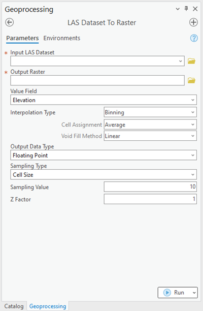

  6. From the Geoprocessing pane, search for the LAS Dataset To Raster geoprocessing tool.
  7. On the LAS Dataset To Raster geoprocessing tool, add the LAS dataset as the Input LAS Dataset value.
  8. Set the Output Raster value.
  9. Set the interpolation parameters.
    Note:
    Binning will produce quicker results. Using the Average cell assignment type is best for bare earth points when producing a DEM. The Maximum option is best for biasing the result to higher elevations when making a DSM. Use either linear or natural neighbors for Void Fill Method. Natural neighbor interpolation exhibits a longer processing time; however, the generated surface is much smoother than that produced with a linear interpolation. It is also less susceptible to small changes in the triangulation. The triangulation interpolation methods derive cell values using a TIN based approach while also offering the opportunity to speed up processing time by thinning the sampling of LAS data using the window size technique.
  10. Set the Sampling Type and Sample Value.
    These options are used to define the resolution of the output raster.
  11. Click Run to run the tool.
