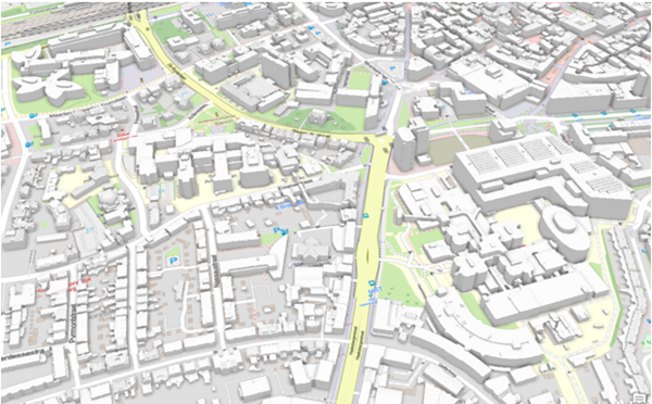

Building shells
An example set of building shells are extracted for an urban area.
The benefit of this approach is positional accuracy of the rooftops, since they are made directly from the lidar points. It can also model some unusual and unique rooftop forms, as it isn't restricted to a limited set of typical roof forms. Disadvantages include noisy results when viewed up close, interior building corners that are rounded rather than sharp, a potentially output higher vertex count, and lack of multiple levels of detail.

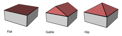

Standard roof types
Standard roof types and examples using a procedural approach are shown.

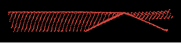

The distance-based clustering is most useful for larger structures in urban areas because they’re more likely to have parts at distinctly different heights. Rooftops with parts that meet one another at common junctures, as is more common with single-family residential homes, will not end up in different clusters.
Roof points
A cross-sectional view of roof points with different sections that meet each other is shown. Consequently, they will combine into one roof cluster.

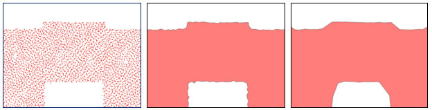

The 2D boundary of each cluster is used as a roof part and is extruded to the ground, forming the walls of the building shell. Cluster boundary polygons, which are concave hulls, are defined using a concept called alpha shapes. A key parameter that defines how tight the boundary is fit around the cluster is called the alpha radius.
Top-down view of points
From left to right, a top-down view of a point set for a portion of a building, a corresponding portion of an output roof polygon made with an alpha radius of 0.5m, and a result using an alpha radius of 1.0m. Note how certain corners are sharper with the smaller alpha radius, while the building sides are cleaner using the larger value.

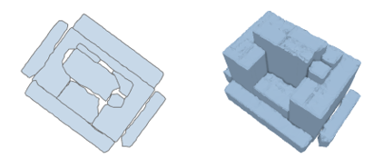

The different cluster boundaries for a building do not meet cleanly and this is arguably a weakness of the approach, as there are gaps between parts. This isn’t much of a problem except when viewing from a close distance.
Top-down view of rooftop part polygons
A top-down view of rooftop part polygons for a building is shown on the left and the corresponding building shell, in perspective, on the right.

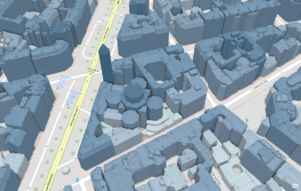

While this approach to building shell modeling has its limitations, the results can often be sufficient for the job and provide for closer approximation than techniques that rely on modeling based on roof types.
Building shells
