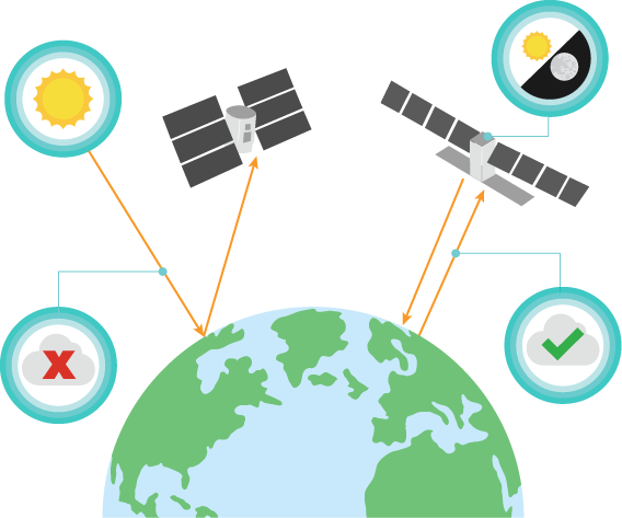

Active sensing
A sensor can be classified as either passive or active. A passive sensor, using optical systems, records electromagnetic waves emitted by the sun and reflected from the ground surface. An active sensor, used by SAR systems, functions as both the source and the receiver. This means the sensor transmits the electromagnetic waves and also records the reflected waves. Unlike an optical sensor, a SAR sensor can operate during the day or night, independent of the sun, since it transmits its own signal.
Active sensing
An optical sensor (left) only works with clear, sunny skies. A SAR sensor (right) can work day and night, and even when clouds are present.

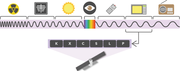

Microwave wavelength
Through active sensing, a SAR sensor can collect imagery using longer wavelengths compared to an optical sensor. While an optical sensor uses wavelengths from visible (4x10-7 meters) to thermal infrared (15x10-6 meters), a SAR sensor uses microwave wavelengths, ranging from K-band (7.5x10-3 meters) to P-band (1 meter).
The microwave wavelengths allow SAR to be an all-weather imaging system for most bands. The longer wavelengths of C-, S-, L-, and P-bands enable the SAR sensor waves to penetrate clouds, fog, dust, smog, and smoke, making it better suited for monitoring humid tropics and high latitudes. Both precipitation and clouds reduce the strength of a K-band signal, while only precipitation reduces an X-band signal. Rain cores and hydrometeors from severe storms can reduce the strength of K-band, X-band, and C-band signals. A SAR image for these bands will have a weakened backscatter for the pixels where the signal interfaced with these severe storm features. Rain cores occur during heavy rain rates (above 125 mm/h), while hydrometeors are clouds of raindrops in both the liquid and melting phases.

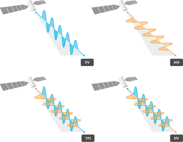

Polarization
In addition to sensing longer wavelengths, active sensing also allows you to control the polarization of the transmitted electromagnetic waves. By having the SAR sensor define both the transmitted and received polarization, the resulting SAR image can highlight features on the earth's surface based on the backscatter. The SAR data polarization is denoted by two letters, the first corresponding to the transmitted polarization and the second corresponding to the received polarization.
Dual-polarized SAR images feature either VV, VH polarized data or HH, HV polarized data. For VV, VH products, the sensor transmits vertically polarized waves and receives vertically polarized (VV) or horizontally polarized (VH) waves. Similarly, for HH, HV products, the sensor transmits horizontally polarized waves and receives horizontally polarized waves (HH) or vertically polarized waves (HV). If the transmitted and received waves share the same polarization, the data is described as copolarized. If the transmitted and received waves do not share the same polarization, the data is considered cross-polarized. As with the wavelength, the transmitted and received polarization used strongly impacts the features captured in the SAR image and must be taken into consideration.
Polarizations

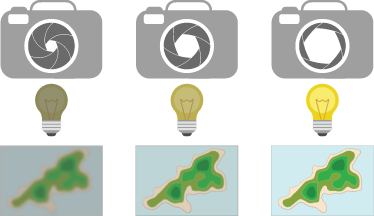

Spatial resolution
Active sensing enables a SAR sensor to synthetically increase its spatial resolution. A SAR sensor emits electromagnetic waves with a chirp of varying frequency that serves as a marker in the received waves. As a satellite orbits or an aircraft flies along its track, the SAR sensor images a point on the ground surface multiple times. The chirp marker is used to identify the location of the received waves. This feature, combined with signal processing techniques, enables a SAR sensor with a short antenna to synthetically elongate its antenna, which enhances its spatial resolution. To identify the location of the received wave on the ground, the SAR sensor must be side looking. If a SAR sensor is nadir looking (pointed straight down), it cannot use the travel time to distinguish between features that are an equal distance from the sensor on opposite sides.
Increasing spatial resolution
Increasing the camera aperture size for a given sensor allows for more light to enter, thereby increasing the resolution of the pictures.
