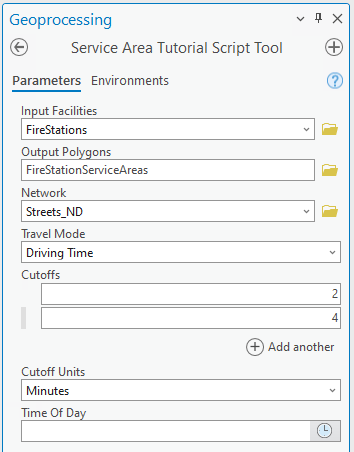

Shows the dialog for the script tool you will create in this tutorial populated with valid inputs.

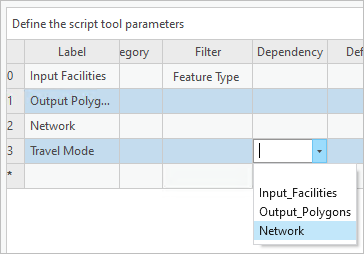

    3. Click the cell in the Dependency column. Scroll to the right to find this column if necessary.
    4. From the drop-down menu in the Dependency column cell, select the Network option.
      Select the Network parameter in the drop-down menu in the Dependency column of the Travel Mode parameter.
      The Travel Mode parameter is now linked to the Network parameter. The tool dialog box automatically updates the choice list in the Travel Mode parameter according to the value set in the Network parameter.

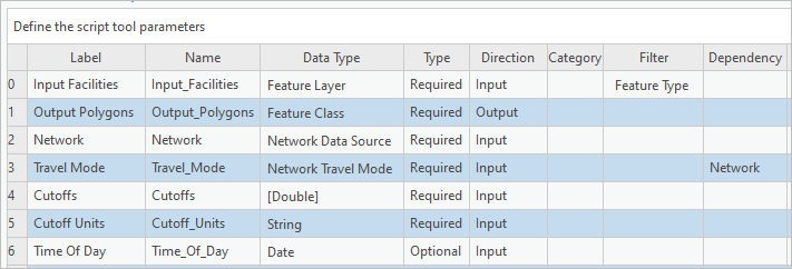

  9. Check the parameter configuration. It should look similar to the following image:
    The full parameter configuration for the script tool

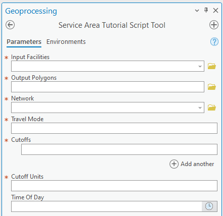

  2. Double-click the tool to open it.
    The Service Area Tutorial Script Tool opens in the Geoprocessing pane. The seven parameters you created in the previous section are visible.
    The script tool dialog box in the Geoprocessing pane showing all the parameters.
  3. Examine each parameter and confirm that the behavior is as expected.

    4. Choose a value for the Network parameter.
      The Travel Mode parameter choice list updates automatically to include the list of available travel modes associated with the Network value.
    5. Examine the Cutoffs parameter.
      You can enter more than one numerical value.
      Currently, you can enter negative numbers or 0, and the parameter does not display an error. Later, you will use tool validation to update this behavior.
    6. Examine the Cutoff Units parameter.
      Currently, the parameter does not display a choice list. Later, you will use tool validation to provide a list of choices depending on the Travel Mode value.
    7. Examine the Time Of Day parameter.
      Unlike the other parameters, this parameter does not display a red asterisk when empty because it is optional. You can use the date and time selector utility or enter a date and time manually.

Run the tool
You have created and configured the script tool, written the tool's code, and customized the tool's validation. It is now ready to run and can be used like any other geoprocessing tool. In addition to running the tool from the Geoprocessing pane, you can add it to a model, call it from a Python script, and share it as a web tool.
  1. If necessary, open the tool by double-clicking it in the Catalog pane.
  2. Choose valid options for each of the tool's parameters.
    Make sure the points you use for the Input Facilities parameter are in the same geographic area as the network you use for the Network parameter.
    Tip:
    If you're using the provided tutorial data, use the datasets in the SanFrancisco.gdb geodatabase to test the tool. The point feature class of fire stations, SanFrancisco.gdb/Analysis/FireStations, can be used for the Input Facilities parameter, and the network dataset, SanFrancisco.gdb/Transportation/Streets_ND, can be used for the Network parameter. You can use the catalog paths to the data, or you can add the data to the map first and use the layers as inputs for the tool. A good cutoff for modeling fire station response time is two to four minutes.
  3. Click the Run button at the bottom of the tool.
    The tool runs successfully and adds a polygon layer to the map.
    Note:
    The tool may produce warning messages.
