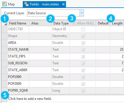

Work with data in fields view
In the Catalog pane, you can use the fields view to do the following in a table or feature class in SQLite or a GeoPackage (the numbers in the list correspond to the numbers in the image below):
  1. View field names.
  2. View field data types.
  3. Determine whether a field allows null values.
  4. View text field lengths.
  5. Add fields.
    Tip:
    Do not use field names that contain spaces or nonalphanumeric characters. See Database and cloud data warehouse data in ArcGIS for information about field name length.
Use the fields view to view field properties and add fields to SQLite or GeoPackage tables.

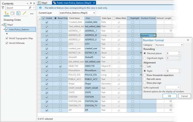

In the Contents pane, you can use the fields view to modify the following layer properties highlighted in the image below.
Fields view from the Contents pane
Caution:
To add a field to a table or feature class in an SQLite database or a GeoPackage, you must open the fields view from the Catalog pane.
Regardless of how you open the fields view, you cannot use it to delete or rename a field in a table or feature class in an SQLite database or a GeoPackage.
Instead, you can use the Alter field geoprocessing tool to rename a field, or the Delete field geoprocessing tool to delete a field in a table or feature class in an SQLite database or a GeoPackage.
