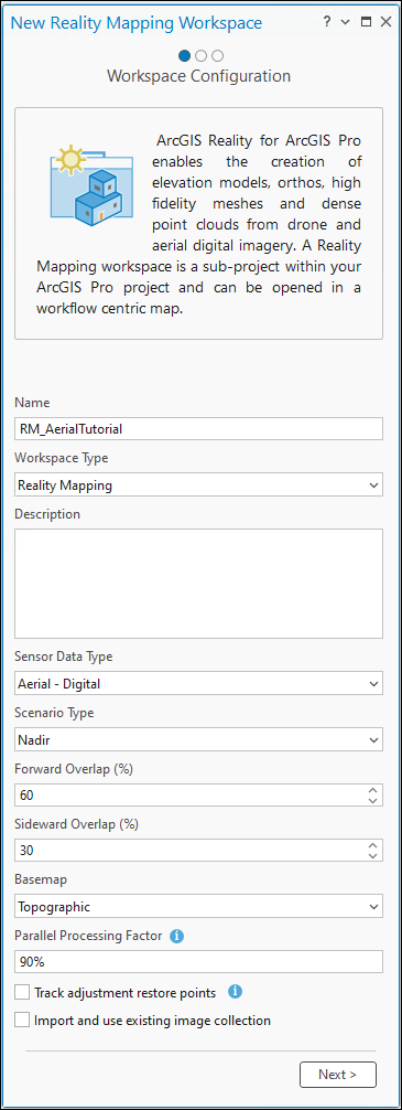

  4. In the Workspace Configuration window, provide a name for the workspace.
  5. Set Workspace Type to Reality Mapping.
  6. In the Sensor Data Type drop-down menu, choose Aerial - Digital.
  7. Set Scenario Type to Nadir.
    This setting is recommended when working with nadir imagery.
  8. In the Basemap drop-down menu, choose Topographic.
  9. Set the Parallel Processing Factor value of the workspace to 90%.
    Setting the Parallel Processing Factor value to 90% means that 90% of total CPU cores will be used to support Reality mapping processing. The Parallel Processing Factor value can also be changed in Properties in the Workspace group in the Imagery tab after the workspace is created.
    Setting the Parallel Processing Factor value higher than what your system can accommodate will lead to parallel processing failures. A common requirement is that for each logical processor, you need 2GB of RAM. For example, if you are working with a system that has 6 cores, 12 logical processors, and 16 GB RAM, setting the parallel processing factor to 100 percent would require a minimum 24 GB of RAM for the process to run successfully. A more appropriate Parallel Processing Factor value based on this example would be 50 percent. which would require approximately 12 GB of RAM.
  10. Accept all the other default values and click Next.

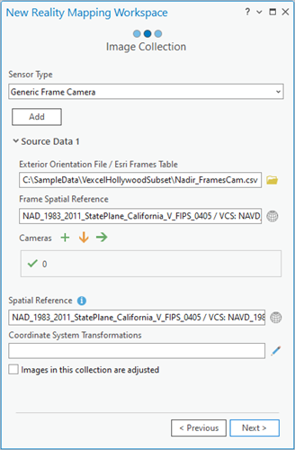

  11. In the Image Collection window, under Exterior Orientation File / Esri Frames Table, browse to the tutorial data folder on your computer and the Nadir_FramesCam.csv frames table file.
    This table, which contains the frames and cameras information, specifies parameters that are used to compute both the IO and EO for the camera and the imagery. In the block adjustment process, these approximate values are refined for greater accuracy.
    Ensure that the data paths listed in the raster column in the frame table file match the location of the image files on your computer.
  12. Under Cameras, click the Import button , browse to the tutorial data folder on your computer, and select the Nadir_FramesCam.csv file .
    For this tutorial, the Esri frame and camera tables are provided as a single file in the proper format. For other datasets, you may need to build and format the tables. For more information, see Frames table schema.

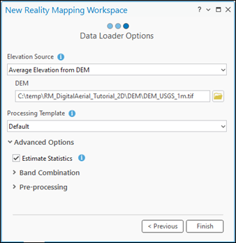

  15. In the Data Loader Options window, under DEM, click the browse button, browse to the tutorial data folder on your computer, and select the DEM_USGS_1m.tif file.
  16. Accept the other default values and click Finish.

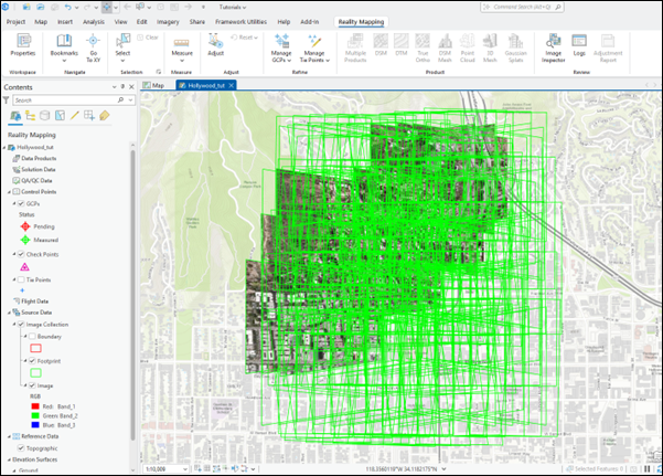

Once you create the workspace, the images and image footprints display. The Reality Mapping category has also been added to the Contents pane. The source imagery data and derived Reality mapping products will be referenced here.
The initial display of imagery in the workspace confirms that all images and necessary metadata were provided to initiate the workspace. The images have not been adjusted, so the alignment is only approximate at this time, and the mosaic may not look correct.

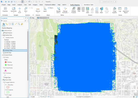

  3. After the adjustment is complete, turn on the Tie Points layer in the Contents pane to view the distribution of generated tie points on the map.
    Tie point distribution

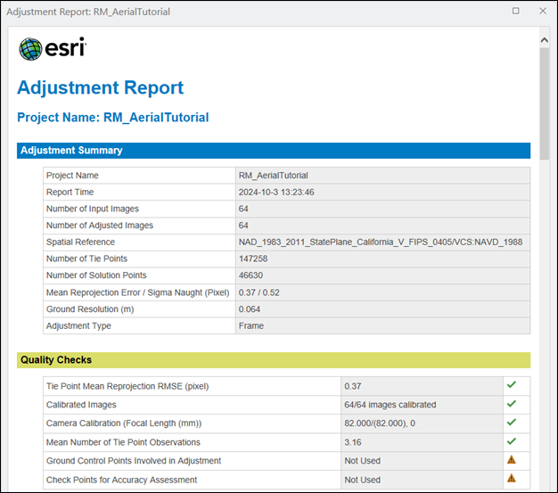

Review the adjustment results
After performing a block adjustment, review the adjustment results and assess the quality of the adjustment. On the Reality Mapping tab, in the Review group, click Adjustment Report to generate adjustment statistics. The adjustment report provides a record of the adjustment and overall quality measures of the process.
Tip:
Using ground control points (GCPs) to improve the absolute accuracy is a best practice. However, GCPs were not available and are not included in this adjustment.
Adjustment report

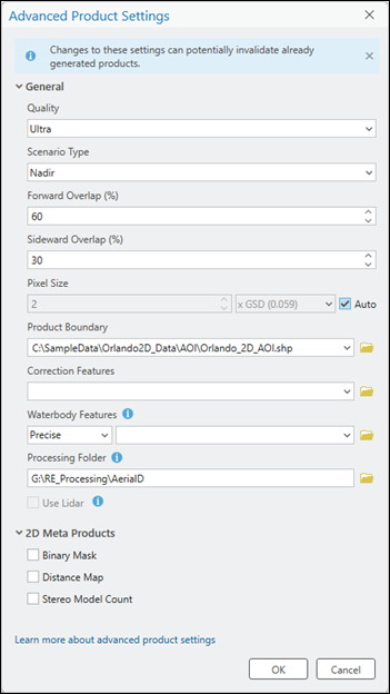

  4. Click the Shared Advanced Settings button.
    The Advanced Products Settings dialog box appears, where you can define parameters that will impact the Reality mapping products to be generated. For details of the advanced product settings, see Shared Advanced Settings option.
    The Quality and Scenario values are automatically set to Ultra and Nadir, respectively, and should not be changed to ensure optimum performance and product quality.
  5. Accept the Pixel Size default settings to generate products at source image resolution.
  6. Change the Forward Overlap (%) and Sideward Overlap (%) values to 80 and 60, respectively.
  7. For Product Boundary, click the Browse button , browse to the file geodatabase in the tutorial data location, select 2D_Pro_bdry, and click OK.
    It is recommended that you provide a product boundary for the following reasons:
    • Define the proper output extent—When you do not define a product boundary, the application automatically defines an extent based on various dataset parameters that may not match the project extent.
    • Reduce processing time—If the required product extent is smaller than the image collection extent, defining a product boundary reduces the processing duration and automatically clips the output to the boundary extent.
    Advanced settings for multiple products

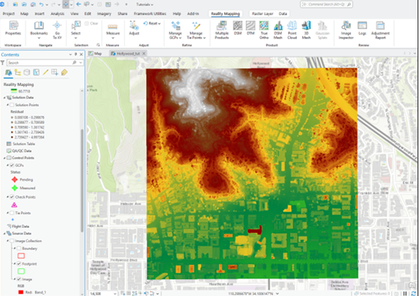

    Once processing is complete, the DSM product is added to the Contents pane, the Data Products category, and the 2D map view. It is also added to the Catalog pane, the Reality Mapping container, and the DEMs folder.
    Generated DSM

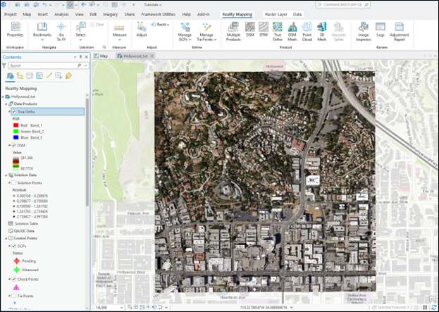

    Once processing is complete, the true ortho product is added to the Contents pane, the Data Products category, and the 2D map view. It is also added to the Catalog pane, the Reality Mapping container, and the Ortho folder.
    Generated true ortho
