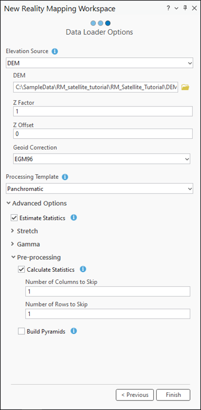

  17. On the Data Loader Options page, under Elevation Source, choose DEM.
  18. Under DEM, browse to the DEM provided with the tutorial dataset.
    Note:
    This DEM will be used to support the block adjustment process.
  19. Set the Geoid correction parameter, to EGM96. Most elevation data uses orthometric heights, so you will need to apply a geoid correction.
    Note:
    The DEM used in this tutorial has orthometric heights. However, if your DEM has ellipsoidal height, set Geoid Correction to None.
  20. Set the Processing Template parameter to Panchomatic.
  21. Expand the Advanced Options section.
  22. Ensure the Estimate Statistics check box is checked.
  23. Accept all other defaults and click Finish.

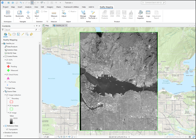

    Once the workspace has been created, the images and image footprints will be displayed in the map. A Reality Mapping category has also been added to the Contents pane, where the source imagery data and derived Reality mapping products will be stored.
    The initial display of imagery in the workspace confirms that all images and necessary metadata were provided to initiate the workspace. The images have not been aligned or adjusted, so the mosaic may not appear geometrically correct.
    A new Reality Mapping tab will be added to the ArcGIS Pro main menu. Clicking this tab will expose a series of tools and workflows dedicated to Reality mapping. In the Product category, all the buttons are unavailable because the images are not yet adjusted.
    Satellite Workspace

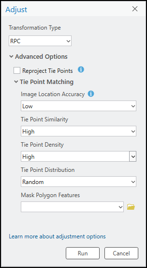

After you have created your Reality mapping workspace, the next step is to perform block adjustment using the tools in the Adjust and Refine groups. The block adjustment will first calculate tie points, which are common points in areas of image overlap. The tie points will be used to calculate the orientation of each image, known as exterior orientation in photogrammetry.
  1. On the Reality Mapping tab, in the Adjust group, click Adjust .
  2. In the Adjust window, set the Transformation Type parameter to RPC. The Rational Polynomial Coefficients (RPC) transformation will be applied in the adjustment, which is used for satellite imagery that contains RPC information within the metadata.
  3. Expand the Advanced Options section.
  4. Expand the Tie Point Matching section and ensure the parameters are set to the following, as shown in the image below:
    1. Set Image Location Accuracy to Low.
    2. Set Tie Point Similarity and Tie Point Density to High.
    3. Set Tie Point Distribution to Random.
    Adjustment settings for satellite imagery
  5. Click Run to perform the block adjustment.

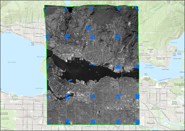

  6. After the adjustment is complete, turn on the Tie Points layer in the Contents pane to view the distribution of generated tie points on the map.
    Your tie point distribution may differ from that shown below.
    Tie points distributed on satellite imagery

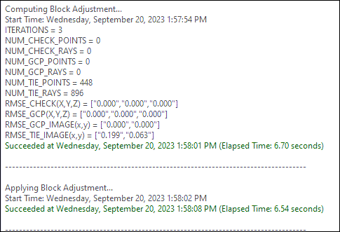

  7. On the Reality Mapping tab, in the Review group, click Logs Logs to access the logs file. The tie point residuals or accuracy reporting can be viewed in the logs file. The tie point residuals are displayed in the row labeled RMSE_Tie_Image(x,y). The units for tie point RSME is in pixels.
    Your residual may differ slightly from the example below.
    Tie point log

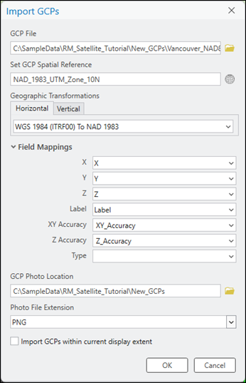

To import GCPs, complete the following steps:
  1. On the Reality Mapping tab, in the Refine group, click Manage GCPs to open the GCP Manager window.
  2. In the GCP Manager window, click the Import GCPs button Import GCPs.
  3. In the Import GCPs window, browse to and select the GCP file (Vancouver_NAD83-UTM10N.csv). Click OK.
  4. Under Set GCP Spatial Reference, click the Browse button .
  5. For Current XY, expand Layers, and choose NAD 1983 UTM Zone 10N (WKID 26910).
  6. Accept all other defaults, and click OK to accept the changes and close the Spatial Reference window.
    The Current Z value, or vertical coordinate system (VCS), was not set because the digital elevation model used to extract height values for the GCPs did not have a VCS defined. If the DEM you used had a defined VCS, the Current Z (VCS) value would have been set with matching coordinates.
  7. For Geographic Transformations, ensure Horizontal is set to WGS 1984 (ITRF00) To NAD 1983.
  8. For Field Mappings, set X to X, set Y to Y, set Z to Z, set Label to Label, set XY Accuracy to XY_Accuracy, and set Z Accuracy to Z_Accuracy.
  9. Under GCP Photo Location, click the Browse button and browse to and select the folder containing the images of the GCP locations. Click OK.
  10. Set the Photo File Extension parameter to PNG.
    Import GCPs
  11. Click OK to import the GCPs.

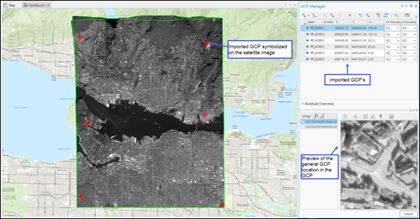

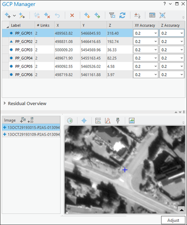

    Once the GCPs have been imported, the table in the GCP Manager window will be populated.
    GCPs added to the projects
    In GCP Manager, the first GCP in the list will be selected by default, and a preview of the image where the GCP is located is displayed in the Preview section.
  12. To add tie points for the selected GCP, in the Preview section, click the View GCP Photo button View GCP Photo to display the GCP image chip. Use the mouse wheel to zoom in on the image chip to see the GCP location indicated by a red arrow.
  13. Click the Add Tie Point button Add Tie Point to add a tie point in the image viewer for each image. The tie points for other images will be automatically calculated by the image matching algorithm where possible, although each tie point should be checked for accuracy. If the tie point is not automatically identified, add the tie point manually by selecting the appropriate location in the image.
  14. After each GCP has been measured with tie points, select point PP_GCP02, right-click, and select Check Point.
    This point will not be used in the adjustment process due to uncertainty of its exact location.

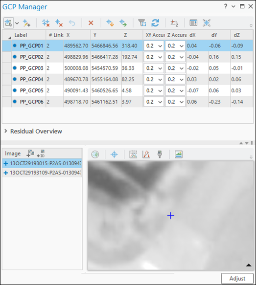

  15. After adding GCPs and checkpoints, click Adjust to run the adjustment again to incorporate these points.
    GCP Manager
Review adjustment results
Adjustment quality results can be viewed in GCP Manager by analyzing the residuals for each GCP. Residuals represent the difference between the measured and computed position of a point. They are measured in the units of the project spatial referencing system. After completing adjustment with GCPs, three new fields—dX, dY, and dZ—are added to the GCP Manager table and display the residuals for each GCP. The quality of the fit between the adjusted block and the map coordinate system can be evaluated using these values. The root mean square error (RMSE) of the residuals can be viewed by expanding the Residual Overview section of the GCP Manager window.
Review satellite adjustment results

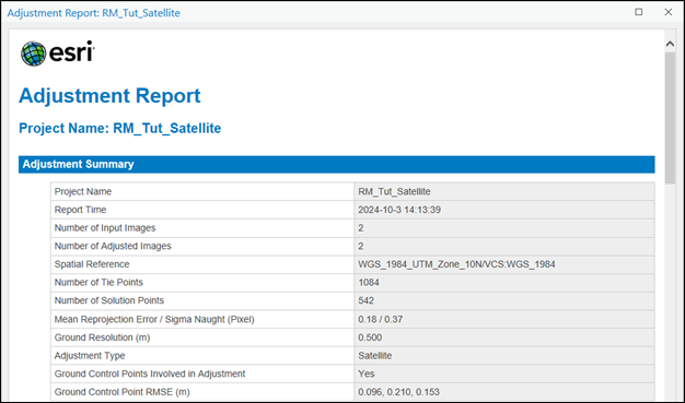

Additional adjustment statistics are provided in the adjustment report. To generate the report, on the Reality Mapping tab, in the Review group, click Adjustment Report.
Adjustment report for satellite imagery

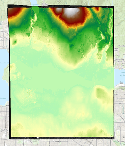

    Once processing is complete, the DSM product is added to the Contents pane in the Data Products category and to the 2D map view. It is also added to the Catalog pane in the Reality Mapping container, and the DEMs folder.
    DSM product
