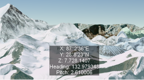

    The default text that appears reports the full camera position (X, Y, and Z ) and rotation values (heading and pitch).
    This is what you see when the overlay is first added to the view:
    Viewpoint overlay tags
    This is what you see after applying the overlay:
    Viewpoint overlay dynamic text

Edit a viewpoint overlay
Selection is an important part of editing an overlay element in animation. The overlay must be active or selected to edit, and only one overlay can be active at a time.
The viewpoint overlay adds all the camera's properties as dynamic text. You can delete the pieces you don't need and add any preferred text. One scenario is an animation depicting the path of the ascent up Mount Everest. Displaying the elevation values from the starting base camp to the summit can add useful and interesting information. For example, to display only the camera's z-property, you'd make the following changes:
  1. Set the animation to the current time your overlay will display.
    For example, you can drag the current time indicator (red vertical bar) on the keyframe gallery, or type in the Current Time text box for the animation on the Animation tab.
  2. Choose the overlay you want to edit in one of the following ways:
    • On the Overlay Timeline in the Animation Timeline pane, click Select Next , which allows you to browse through all the overlays.
    • Click to select an overlay from the overlays list in the Animation Properties pane.
    Overlays that appear in gray are not visible at the current time, but they are part of the entire list of overlays for the animation.
  3. In the Overlay group on the Animation tab, click Edit Text to access on-screen editing for the overlay. When you're finished, click the close button to commit the changes made through on-screen editing.
  4. To edit an overlay using the Animation Properties pane, hover over the list of overlays to give focus to the one you want to edit. Click the Edit button to activate an editing text box. Click the Edit button again to commit the changes from the Animation Properties pane.
    Your changes are reflected in the view as you type in the edit box in the Animation Properties pane.

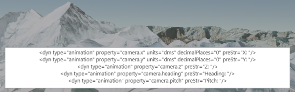

To customize the viewpoint display to include a title and only the elevation value, make the following changes:
Original tags for Viewpoint dynamic text
Example of changes
Example of edited tags
Displayed text
<dyn type="animation" property="camera.x" units="dms" decimalPlaces="0" preStr="X: "/>
<dyn type="animation" property="camera.y" units="dms" decimalPlaces="0" preStr="Y: "/>
<dyn type="animation" property="camera.z" preStr="Z: "/>
<dyn type="animation" property="camera.heading" preStr="Heading: " decimalPlaces="0"/>
<dyn type="animation" property="camera.pitch" preStr="Pitch: " decimalPlaces="0"/>
  • Add a static title or description of what the values represent.
  • Remove all other values and keep only the camera's z-property.
Meters: <dyn type="animation" property="camera.z"/>
Meters: 11,650.37

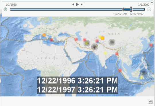

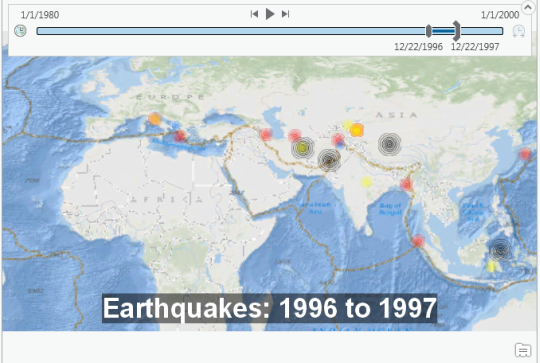

Edit a map time overlay
The map time overlay adds the start and end time properties as the default dynamic time text. You can delete pieces you don't need and add any preferred text. One example, shown here, is displaying a history of earthquake incidents symbolized by magnitude range. To display a specific date format and add a title, you would make the following changes:
Original tags for Map Time dynamic text
Example desired changes
Displayed text
<dyn type="animation" property="startTime" format="short|long"/>
<dyn type="animation" property="endTime" format="short|long"/>
  • Add a title or description of what the values represent.
  • Format the time property to only show the year as a one-year span.
Earthquakes: <dyn type="animation" property="startTime" format="yyy"/> to <dyn type="animation" property="endTime" format="yyy"/>
Earthquakes: 1988 to 1989
The images below show the before and after editing of the dynamic time text for an animation.
Map time dynamic text as default format
Customized dynamic time text
Other custom formats are included in the table below. For a complete list, see Format date and time dynamic text.

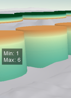

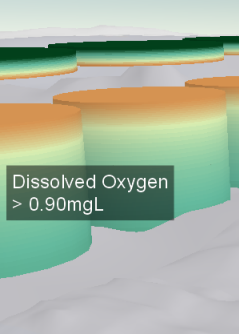

Edit a map range overlay
The map range overlay adds the minimum and maximum range properties as the default dynamic range text. You can delete the pieces you don't need and add any preferred text. One scenario is water column data that is thematically colored to show the level of dissolved oxygen at different ocean depths. For example, if you want to display only the minimum value, update the decimal places for accuracy, and add a title or description about what the value represents, you would make the following changes:
Original tags for Map Range dynamic text
Example changes
Displayed text
Min: <dyn type="animation" property="rangemin" decimalPlaces="0"/>
Max: <dyn type="animation" property="rangemax" decimalPlaces="0"/>
  • Update the value to show two decimal places for accuracy.
  • Remove maximum value because it does not change in the animation.
`Dissolved Oxygen
> <dyn type="animation" property="rangemin" decimalPlaces=" 2 "/> mgL
Dissolved Oxygen
> 0.90mgL
The images below show the before and after editing of the dynamic range text.
Map range dynamic text as default format Customized dynamic range text

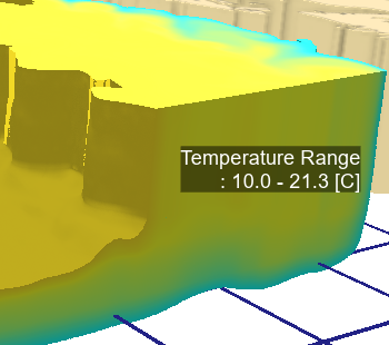

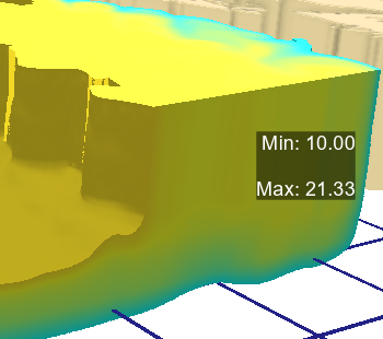

Edit a voxel data overlay
There are two dynamic text overlays for voxel data: one for the optional data filter used for a volume sublayer, and one for the data value for an isosurface sublayer. Voxel dynamic text includes a layer name property to support scenes that contain multiple voxel or isosurface layers.
The voxel filter overlay is used for the volume sublayer of a voxel layer and adds the minimum and maximum data filter properties as the default dynamic text. You can delete the pieces you don't need and add any preferred text. One scenario is water volume voxel data that is thematically colored to show the temperature of the water. To display the current temperature range with a reduced number of decimal places, and add a title and a temperature unit, make the following changes:
Original tags for Voxel Filter dynamic text
Example changes
Displayed text
Min: <dyn type="animation" layer="WaterTemp Voxel" property="voxelfilter.min" decimalPlaces="2"/>
Max: <dyn type="animation" layer=" WaterTemp Voxel" property="voxelfilter.max" decimalPlaces="2"/>
  • Add a title or description of what the values represent, including a temperature unit.
  • Update the value to show one decimal place for easier reading.
Temperature Range: <dyn type="animation" layer="WaterTemp Voxel" property="voxelfilter.min" decimalPlaces="1"/> - <dyn type="animation" layer="WaterTemp Voxel" property="voxelfilter.max" decimalPlaces="1"/> [C]
Temperature Range: 10.0 - 21.3 [C]
The images below show the before and after editing of the dynamic voxel filter text.
Voxel Filter overlay as default text Customized dynamic Voxel Filter text
