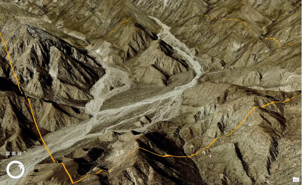

A simple scenario is to model how water from rainfall will flow and accumulate within an area of interest. This scenario can be run anywhere in the scene, in either local or global view mode. Begin with a scene containing relevant layers, such as a ground surface and buildings, and navigate the camera to the location you want to analyze.
Rain water flowing downhill within a flood simulation

    The simulation runs with extreme rainfall for 15 minutes, followed by reducing rates of water flow over the remaining 15 minutes as the hypothetical storm passes by. The roughness of the surface impacts how fast the water moved over the ground.

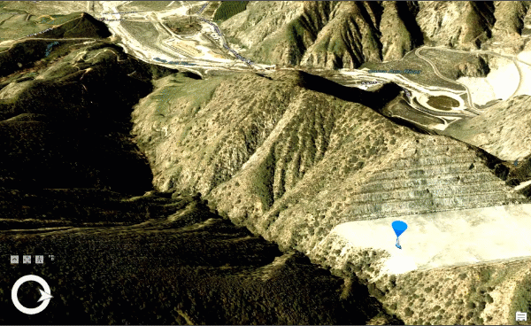

Model the controlled venting of a dam
In this scenario, you will use a water source point to create a specific location where water flow is added into the simulation. This is useful for many use cases, such as venting a dam at a particular rate, representing a broken water pipe, or modeling the arrival of water from regions upstream from the area of interest.
Water flowing downhill from a single water source point.

    Water starts emerging from the point location at 200 cubic meters per second.
    Note:
    Water sources are handled as a single cell. For a 1-meter cell size simulation, a flow rate of 200 cubic meters per second is applied as a tall column of water onto a single square meter of space. For a less dramatic addition of water, add multiple nearby water source points and configure each to contain some fraction of the total required flow rate.

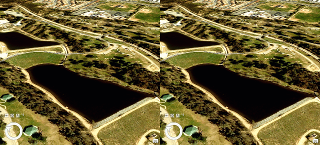

Review potential futures from a partially flooded state
In this scenario, you will use an initial-state water depth raster to load water on to the surface and then simulate potential futures from that state. This can be useful for what-if scenarios, such as modelling a potential levee burst or comparing the results from the worst-case and best-case rainfall predictions. This scenario requires a water depth raster, which can be modeled in a variety of ways. One option is to calculate the elevation surface difference between the terrain and a fixed elevation, such as filling up a dam, or using the output from another simulation run, such as the output from a rainfall simulation scenario or the predicted water levels from another flood simulation engine.
The following example shows exported results of the heavy storm scenario run above and will use its final state as the starting point for two new simulations. The original simulation layer is still in the active scene and the exported final-state analysis raster has also been added into the scene.
Side-by-side images show the difference between a best case and worst case rainfall scenario involving a dam.
Two potential futures: On the left, the best-case result of only a light rain, and on the right, the worst-case result of heavy rain with a channel symbolizing dam overflow.

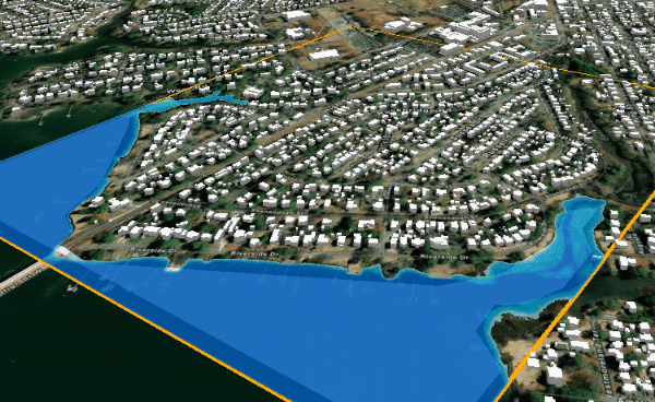

Model sea level rise
In this scenario, you will use a water source area to continuously add water into the simulation within a defined area. This can be useful for cases where you need to model how rising water encroaches into higher terrain, such as sea-level rise or catchment areas that exceed their capacity. Begin with a scene containing relevant layers, such as a ground surface and buildings, and navigate the camera to the location you want to analyze.
Water filling a flood simulation area of interest.
To model sea level rise, complete the following steps:

    Water emerges evenly across the area at 500m³/sec.
  16. After the simulation has fully played, use the Step Backward and Step Forward buttons in the Playback group to move through and explore the cached moments for the simulation.
  17. Optionally, export the analysis to raster data by clicking the Analysis Results button in the Export group.
  18. In the Export Simulation pane, set the Location value to a folder on your local machine.
  19. Click Export.
You now have a visual representation of where incoming water will encroach into the surrounding terrain. Most coastal communities are resilient to incoming sea level rise, but only up to a specific elevation. Once this level is exceeded, it is not unusual to have many structures impacted in quick succession. You may discover entire neighborhoods being cut off by rising water, as well as identifying high ground for potential evacuation zones.
