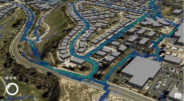

Flood simulation uses shallow water equations within a defined area of interest to model how water moves and accumulates in a scene. You create one or more flood simulation layers in a scene, run the scenario, and review the visual results. You can adjust the scenario, such as increasing the rainfall or blocking a waterway, and see what impact it has on the results.
A moving image showing water flowing down streets and around buildings.

After each iteration of calculations is completed, the updated distribution of the water is rendered on top of the content in the 3D view. The level of detail used for the simulation analysis is used to lock a matching level of detail for the underlying ground surface. You can pause and continue to play the simulation using the playback controls and interactively navigate within the scene while it is running.
The simulation layer’s symbology defines which property—water flow rate (in cubic meters per second), water depth (in meters), or water speed (in meters per second)—is used to colorize the display of the water, which is rendered as a display shader in the 3D view.
