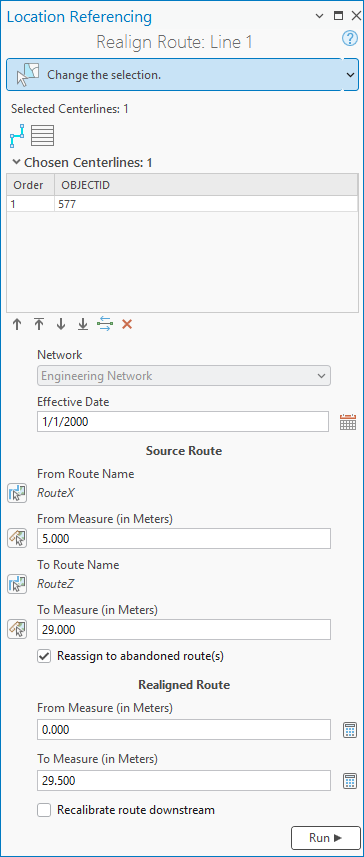

  3. On the Location Referencing tab, in the Routes group, click Realign .
    Realign button
    The Realign Route pane appears with the Select By Rectangle tool active by the default.
  4. Select one or more centerlines by rectangle at the location of the new route.
    You can also click the Select one or more centerlines drop-down arrow and choose one of the other selection tools: Select By Polygon , Select By Lasso , Select By Circle , Select By Line , or Select By Trace .
    The selected centerlines are highlighted on the map, and the Allow choosing of one or more centerlines button appears in the Realign Route pane. The selected centerlines count is shown above the table.
    Note:
    • The direction of digitization of the centerline, depicted by the direction of the arrowhead on the selected centerline, also determines the direction of increasing measure calibration. You can reverse direction for the chosen centerlines using the Flip the direction of the centerlines button . This leads to an in-memory flip of the centerline's direction and the change in direction is not permanent.
    • The Keep centerlines chosen and selected option in the Location Referencing options is useful if you're realigning a route in the engineering network and want to realign another route in the continuous network using the same centerlines, or vice versa.
    • If the centerline was created as a curve, Pipeline Referencing will convert the curve into a densified polyline feature.
  5. Click the Allow choosing of one or more centerlines button .
    A table appears in the Realign Route pane with each selected centerline in a numbered row that corresponds to the selection order. The selected centerlines are numbered on the map and highlighted. The count is shown above the table.
    Realign Route pane
  6. Optionally, choose one or more rows from the Order column, and use the buttons below the table to change the centerline selection order. You can also drag rows to change the order.
    Changes in the table selection order are also shown on the map.

  7. In the Realign Route pane, choose the network in which you want to realign a route.

  8. Specify an effective date for the realignment by doing one of the following:
    • Provide a date in the Effective Date text box.
    • Click Calendar and choose a date.
    • Double-click the empty Effective Date text box to populate today's date.
  9. Optionally, if the centerline doesn't touch the route, use the pickers to populate the From Route Name, To Route Name, From Measure, and To Measure parameters.
    If the centerline touches the routes, the From Route Name, From Measure, To Route Name, and To Measure parameters in the Source Route section are automatically populated.
    Note:
    After clicking the Choose route from map button or the Choose measure from map button , you can hover over the routes to see the route and measure at the location of the pointer.
    If only one applicable route exists at the edit location, click to select it. If multiple routes are applicable, click to select one of the applicable routes using the Select Route dialog box.
    Note:
    In this example, the Reassign to abandoned route(s) option is checked. Routes that represent assets that are present but not in use will be created.
    Learn more about reassigning to an abandoned route
    Note:
    For an engineering network, the measures can be entered as station values in 00+00.00 or 00+00.000 format.
  10. Optionally, provide a start measure value.
    The From Measure value in the Realigned Route section is automatically populated if the centerline touches the route.
    Note:
    Z-values are considered when calculating the geometric length of the centerlines.
    Learn how centerlines and routes support z-values
  11. Optionally, provide an end measure value of your choice.
    The To Measure value in the Realigned Route section is automatically populated if the centerline touches the route.
    Note:
    In this example, the Recalibrate route downstream option is not checked. A new route will be created in the realigned portion.
  12. Click Run.
    The Realign Route pane transitions to the next page, in which the routes to be abandoned due to the realignment are listed.
  13. Click Next.
  14. Provide a name for the new route that will be created in the realigned portion.
    Note:
    To copy attributes from an existing route, click Copy attribute values by choosing route from map and choose an existing route.
  15. Click Next.
  16. Provide a name for each abandoned route.
    You can also provide any required attributes for the abandoned route or routes at this time, or check the Apply values to all routes check box to provide the same values for all abandoned routes.
  17. Click Run.
    Route realignment is complete.
