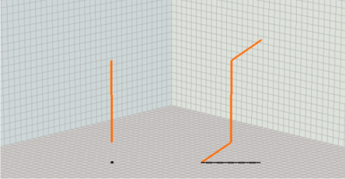

A vertical line segment is a portion of a line that is entirely vertical; that is, both vertices that compose the segment's endpoints have the same x- and y-coordinates but different z-coordinates. Vertical line segments may be individual features, or they may be contained in features that have other segments that are not vertical, composing a hybrid polyline.
In the image above, the orange feature on the left represents an individual polyline feature that is composed of a vertical segment. The black dot below the feature shows how this vertical polyline is represented in 2D the x- and y-coordinates for both segment endpoints are the same, so in 2D, the vertical line only appears as a point). The orange feature on the right represents a hybrid polyline feature in which one segment of the line is vertical but other line segments are horizontal or sloping (not vertical). The black line below this feature shows how this hybrid polyline is represented in 2D.
