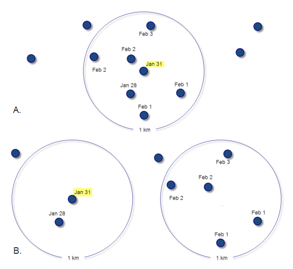

One common approach to understanding spatial and temporal trends in your data is to break it up into a series of time snapshots. You might, for example, create separate datasets for week one, week two, week three, week four, and week five. You could then analyze each week separately and present the results of your analysis as either a series of maps or as an animation. While this is an effective way to show trends, how you decide to break up the data is somewhat arbitrary. If you are analyzing your data week to week, for example, how do you decide where the break falls? Should you break the data between Sunday and Monday? Perhaps Monday through Thursday, and then again Friday through Sunday? And is there something special about analyzing the data in week-long intervals? Maybe daily analysis or monthly analysis would be more effective. The implications may be important if the division (dividing Sunday events from Monday events for example) separates features that really should be related. In the example below, 6 features fall within a 1-kilometer and 7-day space-time window of the feature labeled Jan 31. Only one feature will be included as a neighbor, however, if the data is analyzed using monthly snapshots.
Data snapshots can artificially separate features close to each other in space and time.
When you define feature relationships using the Space time window, you are not creating snapshots of the data. Instead, all the data is used in the analysis. Features that are near each other in space and time will be analyzed together, because all feature relationships are assessed relative to the location and time stamp of the target feature. In the example above, (A.), a 1-kilometer, 7-day space-time window, finds 6 neighbors for the feature labeled Jan 31.

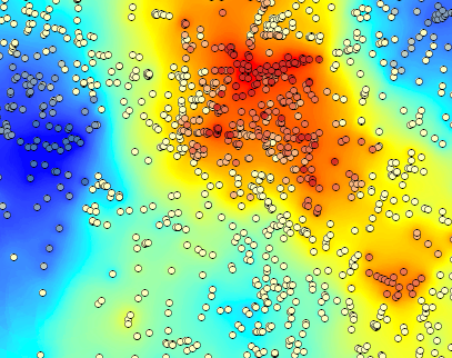

Heat maps typically show high-intensity areas (hot spots) in red and low-intensity areas (cold spots) in blue. In the graphic below, for example, the red areas are places getting the largest number of 911 emergency calls. The blue areas are locations getting relatively few calls. How might you add information about the temporal dimension of 911 call frequencies to the map below? How might you effectively map things such as individual outbreaks, a series of crime sprees, reverberations in the adoption of a new technology, or the seasonal oscillations of storm patterns?

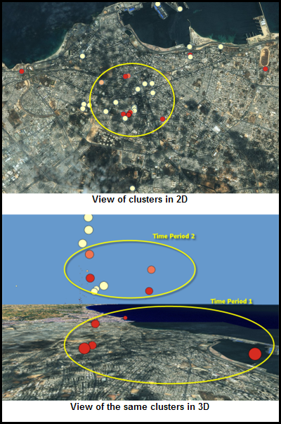

Representing three-dimensional data (x and y location, plus time) is difficult to do with a two-dimensional map. Notice that in the example below, you can't discern that there are two distinct hot spots (near each other in space but separated by time) until the data is viewed in three dimensions. By extruding the features based on a time field, it becomes clearer which features are related and which are separated by time.
2D versus 3D clusters
These are identical clusters viewed in two and three dimensions.

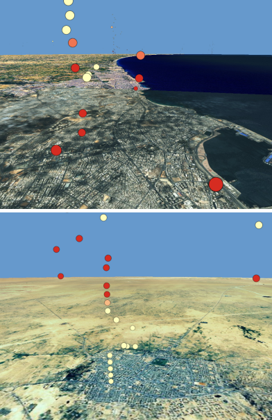

Another way to visualize the results of a space-time cluster analysis is to use 3D visualization. With this method, time becomes the third dimension, with point features extruded to reflect temporal progression. In the 3D graphic above, for example, the oldest events are nearest to the ground, and the more recent events hover at higher elevations (appearing closer to the viewer).

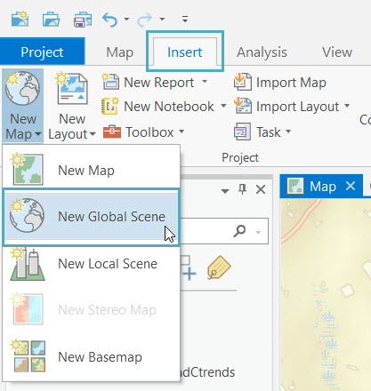

  1. Open a scene. To open a scene, on the Insert tab, click New Map, and choose New Local Scene.
    Open New Scene

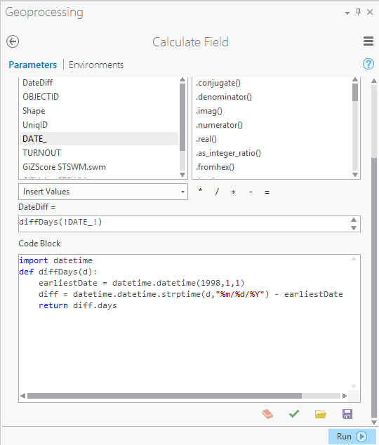

  2. Open the attribute table of your output feature layer and sort your features by date so that you can identify the earliest date. Create a new field called DateDiff to calculate the time lapse values that will be used to project the height of each feature. For this example, the heights will be based on the number of days that have passed since the first event in the dataset occurred.
  3. Use a Python script to calculate the time lapse values. Right-click the new field that you just created and choose Calculate Field. In the Geoprocessing pane, fill in the parameters and code block as shown below, replacing the date in the code block with the earliest date for the features in your output feature layer.

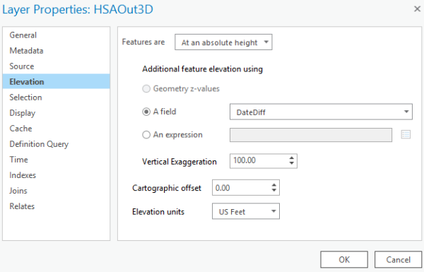

  5. Right-click the output feature layer, select Properties and browse to the Elevation tab. Change the setting for the Features are parameter to At an absolute height and set the field to be the DateDiff field you created. You will likely need to experiment with different Vertical Exaggeration values to create the visualization that works best for you.
