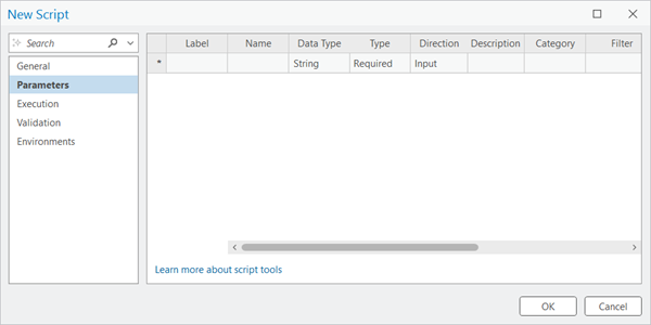

To add a parameter, click the first empty cell in the Label column and type the name of the parameter. This is the name that will be displayed in the Geoprocessing pane and can contain spaces. In the Name column, a default parameter name will be created based on the Label value but can be changed. The parameter name is needed for Python syntax and will be validated (including the removal of spaces).
Parameters tab with script tool properties
After providing the display name of the parameter, choose a data type for the parameter by clicking in the Data Type cell as shown below.
Parameter data types
To create a parameter that will accept multiple values, check the Multiple values check box. To create a parameter that accepts different data types, that is, a composite data type, click the Add button .

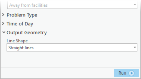

Category
Parameters can be grouped into various categories to minimize the size of the Geoprocessing pane or to group related parameters that will be infrequently used. You can provide either a new category name or choose from a list if you have set a category for other parameters. Several ArcGIS Network Analyst extension tools use categories, as shown in the image below.
Parameter categories
Categories are shown after noncategorized parameters. Do not put required parameters into categories, as they are hidden from view in the Geoprocessing pane.
