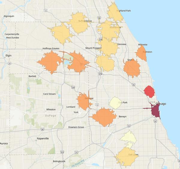

  6. View the results of the analysis.
    The suitability scores are automatically calculated and displayed in four places:
    • Suitability analysis layer polygons are shaded in the map, illustrating score rankings.
    • The suitability analysis layer in the Contents pane returns hierarchal shading that corresponds with the map results, along with value ranges.
    • Right-click the Candidate Sites layer to open the layer's attribute table, which shows scores for individual criteria, as well as the overall scores, returned as new fields. Each row in the table represents a different site.
