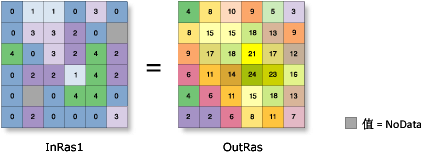

插图
OutRas = FocalStatistics(InRas1, NbrRectangle(3,3,"CELL"), "SUM", "DATA")
