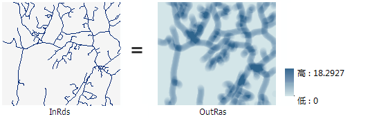

插图
OutRas = LineDensity(InRds, None, 30)
