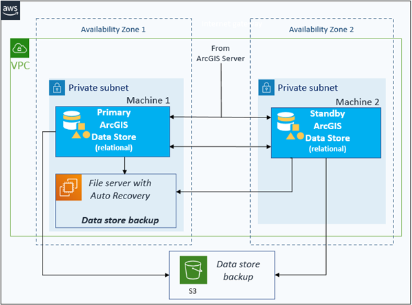

This template can create the following architecture in Amazon Web Services:
Relational store on two EC2 instances: one primary and one standby
In the diagram above, backups are in an S3 bucket. Automatic backups can be created in an S3 bucket or an EC2 file server.
License:
Certain icons in the diagram are used with permission from Amazon Web Services.
