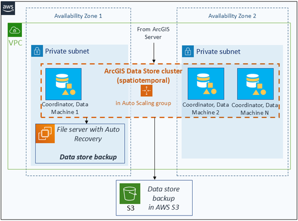

The following architecture diagram provides an example of the resources that are created when you use this template to create a spatiotemporal big data store in AWS:
Spatiotemporal big data store with machines in an Auto Scaling group
In the diagram above, backups are in an S3 bucket. Automatic backups can be created in an S3 bucket or an EC2 file server.
