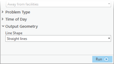

Category
Parameters can be grouped into various categories to minimize the size of the tool dialog box or to group related parameters that will be infrequently used. Parameters that set the category property to the same string value will be grouped together. Several ArcGIS Network Analyst extension tools use categories as shown below.
Parameter categories
Categories are shown after uncategorized parameters. Do not put required parameters into categories, as they are hidden from view on the tool dialog box.
