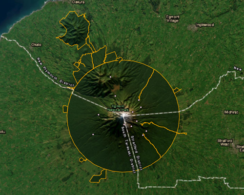

    The project opens to the Taranaki region on New Zealand's North Island. The boundary of Egmont National Park is drawn with an orange outline. Mount Taranaki is in the center of the park.
    The active view is a 2D map named Egmont. The project also contains a 3D scene named Egmont 3D, which is not currently open.
    Imagery map of Taranaki region in New Zealand

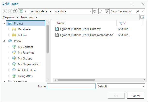

  1. On the Map tab, in the Layer group, click Add Data .
  2. On the browse dialog box, in the navigation pane, under Project , click Folders .
  3. In the file list on the right, browse to Create_points_from_a_table > commondata > userdata.
    Browse dialog box
    The userdata folder contains a .csv file and a text file with metadata.
  4. Click Egmont_National_Park_Huts.csv to select it and click OK.

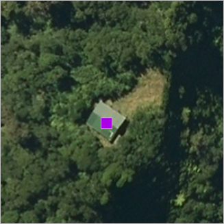

You'll zoom in on the map to confirm that the point features are located on actual buildings. You'll also change the layer's name.
  1. On the Egmont map, zoom in close on any point feature.
    Point located on hut

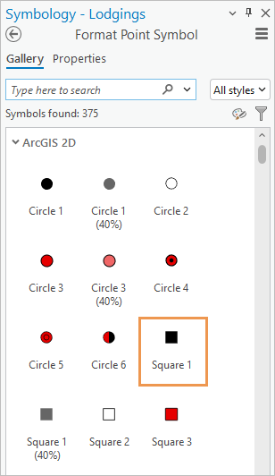

  4. At the top of the pane, click the Gallery tab, if necessary. In the scrolling box of symbols, under ArcGIS 2D, click Square 1. (Choose the solid black symbol, not Square 1 40%.)
    Symbology pane showing Square 1 in the symbol gallery

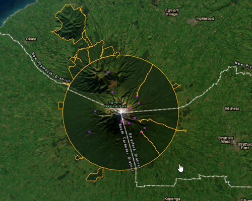

  16. On the ribbon, click the Map tab. In the Navigate group, click Bookmarks . Under Egmont Bookmarks, click Taranaki Region.
    The map zooms out to a regional scale and the symbols do not display on the map.
  17. In the map scale box at the bottom of the map view, click the drop-down arrow and click 1:500,000.
    The layer displays and the features appear at their minimum size.

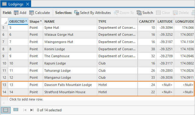

The Lodgings layer has 12 features: nine huts that belong to the Department of Conservation and three that belong to alpine clubs. In addition, there are two resort hotels inside the park that aren't included in the .csv file. In this section, you'll locate the first of these hotels, Dawson Falls Mountain Lodge, and add a feature to the ENP_Lodgings feature class.

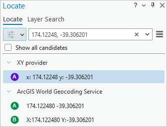

  4. In the Locate pane, in the search box, type Dawson Falls Mountain. Do not press the Enter key.
    As you type, a list of suggestions appears and updates.
  5. Hover over the first entry for Dawson Falls Mountain Lodge (there may be more than one) and confirm that the address is Dawson Falls Mountain Lodge, Manaia Road, Egmont National Park, Taranaki, 4391, NZL.
    Locate pane showing suggestions for Dawson Falls Mountain Lodge
  6. Click the highlighted entry.

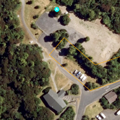

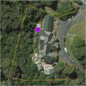

    The map zooms in and a marker is placed at the end of Manaia Road.
  7. In the map scale box at the bottom of the view, click the drop-down arrow and click 1:1,000.
    The marker is placed about 70 meters to the north of the lodge building.
    Map zoomed to the end of Manaia Road

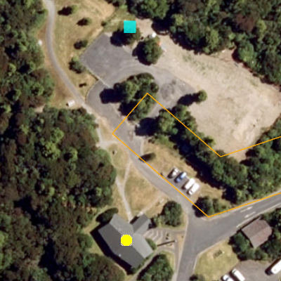

  8. In the Locate pane, right-click the marker and click Add To Feature Class .
  9. On the Add To Feature Class dialog box, expand Lodgings and click the Lodgings feature template.
    Add To Feature Class dialog box with Lodgings feature template selected
  10. Click OK.
  11. In the Locate pane, in the search box, click Delete to clear the address.
    The temporary marker is removed from the map. The new feature is added to the Lodgings layer and is selected. It is not saved to the feature class until you save edits.
    Selected feature on map

You'll move the feature from its current location and place it directly on the building. Then you'll edit its attributes.
  1. On the ribbon, on the Edit tab, in the Features group, click Modify .
    The Modify Features pane appears. At the top of the pane, the All Tools tab is selected.
  2. In the Modify Features pane, under Alignment, click Move .
    The pane updates and the Move tool is selected. On the map, the selected feature is highlighted in yellow. At the bottom of the view, the editing toolbar appears.
    Tip:
    You can configure the editing toolbar to change its size and position, and you can turn it on or off.
  3. On the map, hover over the selected feature. When the mouse pointer changes to a four-headed arrow, drag the feature to the building and release the mouse button.
    Feature moved on top of building
    The yellow highlight now appears on the building. The original feature location remains visible in case you decide not to commit the edit.
  4. On the editing toolbar, click Finish .
    On the map, the selected feature moves to the building. If the feature placement isn't right, click Undo on the Quick Access Toolbar. In the Modify Features pane, click Move and repeat the operation.

The second hotel in the park is the Stratford Mountain House on Pembroke Road. You'll locate it by its latitude-longitude coordinates.
  1. Make the Locate pane active. In the search box, type (or copy and paste) 174.12248, -39.306201 and press the Enter key.
    Locate pane showing candidate locations
    Results are found by both the XY provider and the ArcGIS World Geocoding Service. The map zooms to the XY provider location highlighted in the pane and a marker is added.
  2. In the Locate pane, right-click the highlighted candidate and click Add To Feature Class .

  10. In the Contents pane, right-click the Lodgings layer and click Attribute Table . Scroll to the bottom of the table.
    Attribute table of the Lodgings layer
    The table has 14 records, including records for the two features you just created.
  11. Close the table.

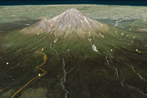

View the layer in the 3D scene
You can display 2D layers in 3D scenes. The scene's elevation surface correctly positions the 2D features in a 3D landscape. You'll copy the Lodgings layer from the Egmont map to the Egmont 3D scene, apply 3D drawing properties, and change the symbol.
  1. In the Contents pane, right-click the Lodgings layer and click Copy .
  2. Make the Catalog pane active and expand Maps . Right-click Egmont 3D and click Open Local View .
    The Egmont 3D scene opens and becomes the active view.
    Tip:
    You can open any scene in global or local view mode. This scene has a relatively small extent and uses a projected coordinate system, so a local view is appropriate. To change the view mode of an open scene, click the View tab on the ribbon. In the View group, click Global or Local .
  3. In the Contents pane, right-click the scene name, Egmont 3D, and click Paste .
    The Lodgings layer appears in the 2D Layers category of the Contents pane and the features draw on the map.
  4. On the ribbon, on the Map tab, in the Navigate group, make sure the Explore tool is selected.
  5. Use the mouse buttons and wheel button to zoom, pan, tilt, and rotate the scene. Alternatively, use the on-screen navigator in the scene.
    The features display in their correct locations on the 3D surface, but the symbols lie flat on the surface—like bits of paper stuck to the mountain.
    Tip:
    If you get lost while navigating, go to any of the Egmont 3D bookmarks.
  6. In the Contents pane, drag the Lodgings layer from the 2D Layers category to the 3D Layers category.
    The layer now uses 3D drawing properties.
  7. In the Contents pane, double-click the Lodgings layer to open its properties.
  8. On the Layer Properties dialog box, click the Display tab. Under Display symbols in scene, confirm that the Screen units option is selected. Click the Improved perspective check box and click OK.
    The symbols now stand up on the surface and display at an appropriate size.
  9. In the Contents pane, click the symbol for the Lodgings layer.
  10. In the Symbology pane, under Format Point Symbol, click the Gallery tab, if necessary.
  11. In the list of symbols, under ArcGIS 3D, click Standing Cube.
    Standing Cube symbol selected in the symbol gallery
    The symbols are updated on the map.
  12. At the top of the pane, click the Properties tab. Click the Symbol tab under it, if necessary.
  13. Click the Color drop-down arrow and click any color. Change the Size setting to 9 pt and click Apply.
    Note:
    Scale-based sizing is not available in scenes. For this scene, a 9 point symbol works well at most scales but may be too small at some scales and too large at others.
  14. Continue to explore the scene using navigation tools and Egmont 3D bookmarks.
    View of scene with 3D lodging symbols
