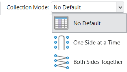

CollectionMode
Specifies if the location is picked up by a vehicle servicing both sides of the street at once or by a vehicle servicing the two sides separately with different passes down the street edge.
The possible values are listed below (use the name, not the code in parenthesis):
  • Null—The stop does not have a specified collection mode. This is the default value.
  • (1) One side—The two sides of the street on which this stop is located are collected separately with different passes down the street edge.
  • (2) Both sides—Both sides of the street on which this stop is located are collected at once with a single pass down the street edge.
Either this field or the layer property Collection Mode must be populated. If this field is left null the Collection Mode will be used for the stop.
All stops on a street edge must have the same CollectionMode value.

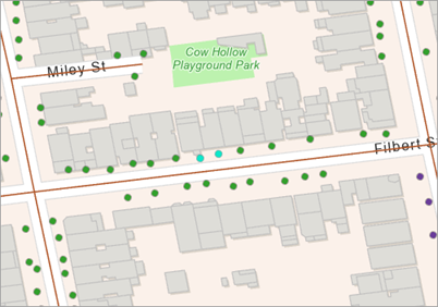

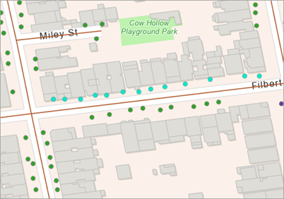

If the stop is additionally constrained to a specific route, that can be controlled using the AssignmentRule field.
A single stop on a collection edge is sufficient to indicate the edge should be collected first/last. If more than one stop on a collection edge indicates first/last, they must match.

Select By Streets
Use this tool to select all the stops on a collection edge.
If you already have a selection set in Stops layer, toggling the Select By Streets will select all the stops that belong to the same collection edge.
While already toggled on, selecting a set of stops in the Stops layer will expand the selection to the whole collection edge and the stops that belong to the same collection edge will be selected. The selection can be across one or more collection edges.
A few stops selected All stops selected on the same edge

Use the option in the Advanced section to specify the collection mode.
Collection mode
Collection mode
This property can be used to specify if the location is picked up by a vehicle servicing both sides of the street at once or by a vehicle servicing the two sides separately with different passes down the street edge.
The following options are available from the drop-down list:
  • No default—No default collection mode is specified. This means that the CollectionMode field in the Stops feature class must be specified for all stops. This is the default property value.
  • One side at a time—The two sides of the street on which this stop is located are collected separately with different passes down the street edge.
  • Both sides together—Both sides of the street on which this stop is located are collected at once with a single pass down the street edge.
