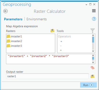

Raster Calculator
The Raster Calculator tool runs map algebra expressions. The tool has a calculator interface from which most map algebra statements can be created by clicking buttons. Raster Calculator can be used as a stand-alone tool, but it can also be used in ModelBuilder. As a result, the tool allows map algebra to be integrated into ModelBuilder.
Raster Calculator user interface
The Raster Calculator user interface is shown.
In the above expression, three rasters are combined by multiplying the second and third rasters together and adding that result to the first. Note that operators follow a defined order of precedence.
The Raster Calculator tool is not intended to replace other Spatial Analyst tools. Continue to use the other tools for the appropriate calculations. For example, use the Slope tool to perform the slope calculations. The Raster Calculator tool is designed to run single-line algebraic statements.

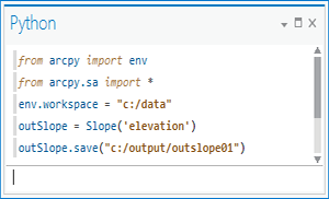

Python window
The Python window allows you to use geoprocessing tools and Python functionality from within ArcGIS Pro. The Python functionality you run from this window can range from a single line to complex multiline blocks of code. The Python window also provides a place to access additional functionality using third-party Python modules and libraries.
To launch the Python window, on the Analysis tab, click the Python drop-down menu, and choose the Python window button . Alternatively, on the View tab, in the Windows group, click the Python window.
Example of the Python window
In the above sequence of statements, the ArcPy site package, the geoprocessing environments, and the Spatial Analyst modules are imported; the workspace is set; the Slope tool is run; and the output is permanently saved. Once you press Enter at the end of a statement, that statement is immediately run.
Some features of the Python window include built-in line automatic completion, use of variables, and access to Python and ArcPy functionality.
