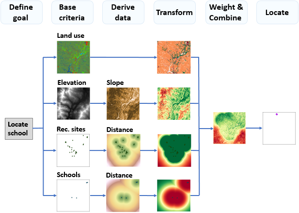

The following is a general process diagram for this example of identifying the ideal location for a proposed new school. The accompanying text will go into more detail for each of the steps.
Process diagram for identifying the preferred location for a new school
A process diagram for identifying the preferred location for a new school is shown.

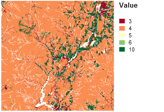

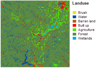

Rank the areas on suitable land-use types
To rank the map representing land-use types, use the Reclassify tool. As it is preferable to build on certain land-use types due to the costs involved, you need to decide how to rank the values.
Here you have to decide which land-use types are preferable. This is subjective depending on your study. The easiest way to decide what type of land is preferable for building on and what is not is to decide on the most preferable and the least preferable. Then, out of the land-use types left, again decide on the most and least preferable. Do this until you have put the land-use types in order of preference. Land uses of water and wetlands have been excluded from the analysis, as you cannot build on water and there are restrictions against building on wetlands. The illustration below shows how the land-use types have been ranked.
Input raster of land-use types Ranked land-use types

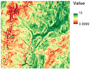

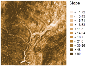

Rank the areas on relatively flat land
To avoid steep terrain and find areas that are relatively flat to build on, you need to know the slope of the land. The Slope tool will create such a map, identifying for each cell the maximum rate of change in value from each cell to its neighbors. The resulting raster records the slope as continuously changing floating-point values. Because the preference is considered to vary directly with changes in the slope value, the Rescale by Function tool will be used to rank this map, by applying the Linear function. Since it is preferable to locate on relatively flat areas, give a value of 1 to locations with steep slopes and 10 to locations with the shallow slopes. The values in between will be adjusted in a linear fashion, as the following illustration shows.
Input slope raster Ranked slope raster

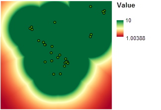

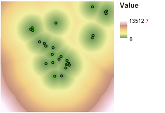

Rank the areas close to recreation sites
To site the school close to recreational facilities, you need to know the distance to them. The Distance Accumulation tool will create such a map, calculating the straight-line (Euclidean) distance from any location to the nearest recreation site. The result is a raster dataset in which every cell represents the distance to the nearest recreation site. Since the input values represent continuous distances, to rank this map, use the Rescale by Function tool. As it is much more preferable to locate closer to recreation sites, the MSSmall function is applied. This will assign much higher preference values to the locations closer to the recreation sites, with locations farther away being far less preferred. With each meter change in distance from the recreation sites, the preference continuously changes, as the following illustration shows.
Distance to recreation sites input Ranked distances to recreation sites

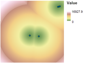

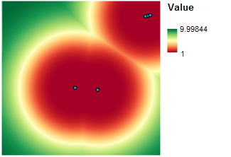

Rank the areas away from existing schools
To avoid the catchment areas of the other schools, you need to know the distance to them. The Distance Accumulation tool will create such a map, calculating the straight-line distance from any location to the nearest school. The result is a raster dataset in which every cell represents the distance to the nearest school. To rank this map, once again use the Rescale by Function tool. As it is preferable to locate away from existing schools, the Large function is used to give a value of 1 to distances closest to existing schools and a value of 10 to distances farthest away from existing schools. With the Large function, the preferences continuously increase with each meter the location is from the school, as the following illustration shows.
Distance from existing school locations input Ranked distances from existing schools

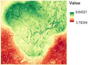

Combine the suitability maps
The last step in the suitability model is to combine the transformed outputs (the suitability maps) of land-use types, slope, distance to recreation sites, and distance to schools.
To account for the fact that some objectives have more importance in the suitability model, you can weight the datasets, giving those datasets that should have more importance in the model a higher percentage influence (weight) than the others. If all datasets are of equal importance, you can assign the same weight to each one.
In the example, you know from breaking down the problem that the most preferable objective to satisfy is to locate the school close to recreational facilities, and the next is to locate it away from existing schools. The following percentage influences will be assigned to the suitability maps. The values in parentheses are the percentage divided by 100 to normalize the values. This normalized value will be used as the multiplier for each suitability map.

The distance to the recreation sites suitability map has an influence of 50 percent (0.5) on the final result, and the distance to schools has an influence of 25 percent (0.25). Slope and land-use types both have a 12.5 percent (0.125) influence. Like assigning scales of suitability, assigning weights is a subjective process, depending on what objectives are most important to your study.
The final suitability map is produced by combining all the maps. Weights can be assigned at the same time as combining the suitability maps. The final suitability map for locating sites for the school is shown below. Most suitable locations are in the darkest green color. The least suitable locations are in red shades.
Output suitability map
The output suitability map is shown.
You can use Map algebra to weight and combine datasets. Alternatively, you can use the Weighted Overlay or Weighted Sum tool. If you use a tool in a model, you have the option of going back and easily altering weights (percent influence) and any scale values you may have set. Connecting geoprocessing tools inside a model means you only need to create the model once, then you can alter parameter values to experiment with different outcomes.
