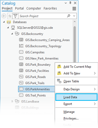

    • Catalog pane—Right-click the feature class or table that you want to append data to and choose Load Data.
      Load Data on context menu

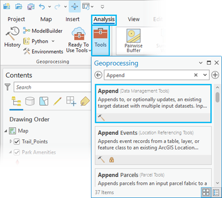

    • Ribbon—Select a layer in the Contents pane. Click the Analysis tab and click Append from the drop-down menu in the Tools group.
      Append tool under Analysis tab in the Tools group

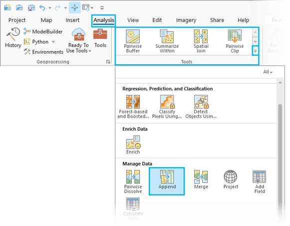

    • Ribbon—Click the Analysis tab and click Tools in the Geoprocessing group. Search for or browse to the Append tool in the Data Management Tools toolset, in the General toolbox.
      Append tool under Analysis tab, Tools, and Geoprocessing

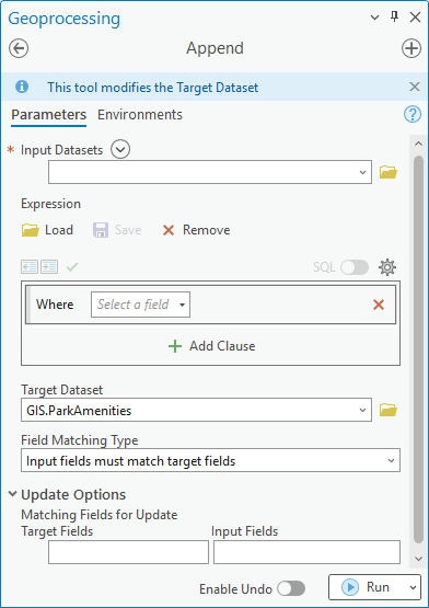

    The Append geoprocessing tool dialog box appears with default settings.
  2. For Input Datasets, use the browse button to select one or more datasets containing the data to be appended to the target dataset.
    Note:
    • There must be at least one layer in the map for the Add Many button to appear.
    • Use Add Many next to Input Datasets to add multiple datasets at once.
  3. Optionally, load an expression file or manually create your own SQL query expression to select a subset of the dataset's records.
    If an input dataset was selected from the map and has selected records, the Append tool will process those selected records as a subset.
  4. For Target Dataset, use the browse button to select the existing dataset where the data from the input dataset will be appended.
  5. Optionally, for Field Matching Type, from the drop-down menu, choose the option that specifies whether the fields of the input datasets must match the fields of the target dataset for data to be appended.
    • Input fields must match target fields—The schema of the input datasets must match that of the target dataset to append features.
    • Use the field map to reconcile field differences—The schema does not need to match. Fields from the input datasets that do not match the fields of the target dataset will not be mapped to the target dataset unless the mapping is set in the Field Map parameter. Fields in the target dataset that are not mapped to fields from the input datasets will contain null values.
    • Skip and warn if schema does not match—The schema of the input datasets must match that of the target dataset for features to be appended. If an input dataset contains fields that do not match fields in the target dataset, that input dataset will be omitted.
  6. Click Update Options to expand an additional option for matching fields for the update. If you do not need to match fields, skip to step 8.
  7. Optionally, under Update Options, for Matching Fields for Update, set the following:
    • Target Fields—From the drop-down menu, select one or more fields from the target dataset that will be used to match fields from Input Fields.
    • Input Fields—From the drop-down menu, select one or more fields from the input dataset that will be used to match fields from Target Fields.
  8. Click Run to append your data.
