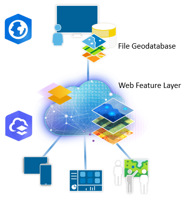

Data management in a file geodatabase
You can use a file geodatabase as your source for editing data. If you shared your indoor data as a hosted feature service, you can make data updates in a geodatabase, and overwrite the existing feature service with ArcGIS Pro. This option allows you to stage edits in the geodatabase and conduct quality control before they are committed to the feature service.
Geodatabase data management diagram
An editor manages all data updates in a file geodatabase before overwriting the existing web layer that is shared with users.
Considerations for geodatabase data management
You can perform quality control workflows on data by staging changes in a geodatabase before overwriting the service. Consider the following when managing data in a file geodatabase:
  • This option is applicable if you are working with hosted feature services. For workflows that require multiuser editing, use branch versioning in ArcGIS Enterprise to manage data.
  • Edits made to the feature service are not preserved when the web layers are overwritten.
    If the feature service has existing edits that must be preserved, you can export the feature service to a file geodatabase, make updates in ArcGIS Pro, and overwrite the web layer. This may result in downtime for users—further edits should not be made on the feature service during this process, as they are lost when the layer is overwritten.
  • You can overwrite feature services with updates from a geodatabase even if the Edit capability is not enabled on the service.

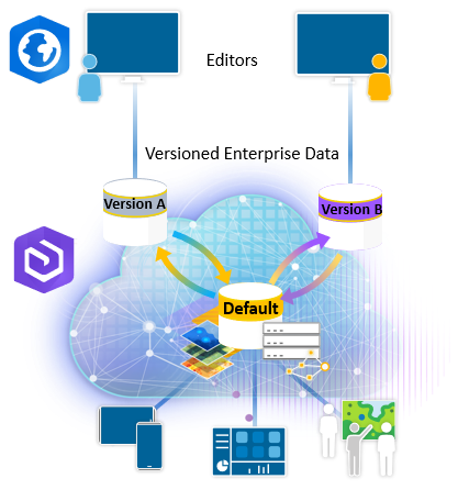

Data management in a branch versioned feature service
For workflows that require multiuser editing, you can manage indoor data using branch-versioned feature services on ArcGIS Enterprise. With branch versioning, users with write access can edit data in different versions of the feature service, allowing for review of any editing conflicts. Quality control workflows, such as validation, can also be applied to versioned data before edits are pushed to the default version, providing protection against unintended edits or data errors.
Branch-versioned feature service data management diagram
Multiple editors contribute to multiple branched versions of a feature service and apply changes to the default version.
Considerations for branch-versioned feature service data management
When data is managed in a branch-versioned feature service, edits can be performed on different versions of the feature service by multiple editors simultaneously, and conflicts can be resolved before changes are posted to the default version. Consider the following when managing data in a branch-versioned feature service:
  • Branch versioning requires ArcGIS Enterprise.
  • Branch-versioned data can only be edited from feature services published from an enterprise geodatabase and cannot be edited directly in the geodatabase.
  • You must stop any running feature services to make schema updates to source layers in the geodatabase. Schema updates cannot be made on branch-versioned feature services.

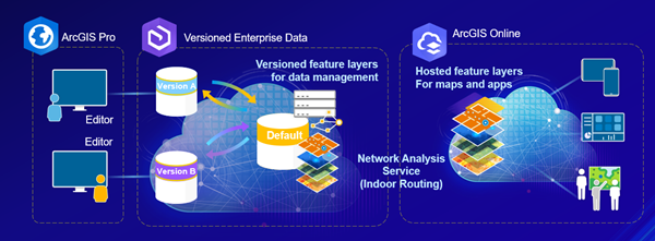

Data management in Enterprise and ArcGIS Online together
For workflows that require multiuser editing and access to ArcGIS Online, you can manage indoor data using a combination of branch-versioned feature services in ArcGIS Enterprise and other feature layers, and use these layers in Indoors maps and apps in ArcGIS Online. Using ArcGIS Online and Enterprise, you can benefit from enhanced data quality control workflows provided by Enterprise as well as enhanced accessibility to users provided by ArcGIS Online.
The combined ArcGIS Enterprise and ArcGIS Online data management workflow
Data is managed in branch-versioned feature services, allowing multiple users to contribute edits and apply changes to a default version. A routable network can be shared from an Enterprise portal to ArcGIS Online, and a workflow can be established to update indoor data in hosted feature services at regular intervals.
Considerations for data management in a combined environment
Managing data in a combined environment allows you to use hosted feature services, referenced data feature services, and branch-versioned feature services to present data to editors based on editing workflow needs. Consider the following when managing feature service data in the Enterprise and ArcGIS Online environments together:
  • For any hosted feature services, edits are applied to live feature service data and are visible to users immediately.
  • When managing data in a branch-versioned feature service and publishing a hosted feature service from the default version of the data, ensure that you have workflows that account for data updates in the enterprise geodatabase and branch-versioned services. For example, if changes are made to a hosted feature service published from the default version, you must integrate the changes back into any branch-versioned feature services. If changes are made to the data in the enterprise geodatabase, you must publish an updated hosted feature service.
  • When editing data shared in hosted feature services, if there are multiple shared services that contain your indoor data, edits must be made to each hosted feature service separately.
  • Edits can only be made on layers that have the Edit capability enabled in the feature service.
  • You must configure the ArcGIS Server instance to be accessible to your users if using Enterprise services in ArcGIS Online maps. Consider how you want to configure security on your ArcGIS GIS Server site to best suit your organization's needs.
  • You can publish a network service in Enterprise and consume the service in ArcGIS Online web maps and apps.
