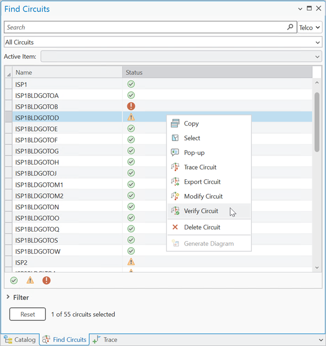

Circuit status
In the circuits list, an icon in the Status column indicates whether the circuit is clean, dirty, or invalid. This value comes from the STATUS field on the Circuit table and is displayed as follows:
  • A green icon indicates that the circuit is clean and has been verified.
  • A yellow warning icon indicates that the circuit is dirty. This means that the circuit has not been verified since its creation, or that changes have been made to the circuit since the last time it was verified.
  • A red exclamation icon indicates that the circuit is invalid. This is displayed when an error is identified while verifying the circuit such as an invalid start or stop location, or if multiple paths are found between the locations that define the circuit. The error returned for an invalid circuit by the verify operation is stored in the Error message field on the Circuit table.
  • Circuits with a Status of Deleted are not displayed with an icon in the list of circuits. These are instead listed separately when filtering for Deleted Circuits.
Find Circuits pane
A context menu can be accessed by right-clicking circuits in the grid view of the Find Circuits pane. This menu provides access to various operations for the circuit including trace, export, verify, and delete. Some options such as Export Circuit and Verify Circuit can be used with a selection of multiple circuits.

  6. Optionally, right-click a circuit in the list to access the context menu and perform circuit management tasks.
    These tasks include the following:
    • Copy —Copies the circuit name to the clipboard for pasting elsewhere.
    • Select —Selects the circuit record for the specified circuit in the Circuit table. Associated records from the Circuit Section and Subcircuit table are also selected (when applicable).
    • Trace Circuit —Performs a circuit trace to visualize the circuit in the map.
      Note:
      When a circuit trace is performed in the Find Circuits pane, the features returned by the trace may differ from the same trace using the Trace tool. This is because traces run from the pane include containers in the result to aid visualization of circuits composed of nonspatial objects in the map.
    • Export Circuit —Opens the Export Circuits tool with the selected circuit details prepopulated. You can select multiple circuits for export from the grid by holding Ctrl or Shift to perform a multi-select followed by right-clicking the context menu option.
    • Modify Circuit —Opens the Modify Circuit pane to allow modifications to the circuit, circuit sections, or subcircuits.
    • Verify Circuit —Verifies a dirty circuit and updates the Status attribute value to Clean. This option is unavailable when the circuit’s status is clean or invalid. When verifying a single circuit from the pane, this does not use the geoprocessing framework. You can verify multiple circuits from the grid by holding Ctrl or Shift to perform a multi-select followed by right-clicking the context menu option. This will open the Verify Circuits tool with a comma delimited list of the selected circuits prepopulated for the Circuits parameter.
    • Delete Circuit —Logically deletes the circuit from the network by updating the Status attribute value to Deleted.

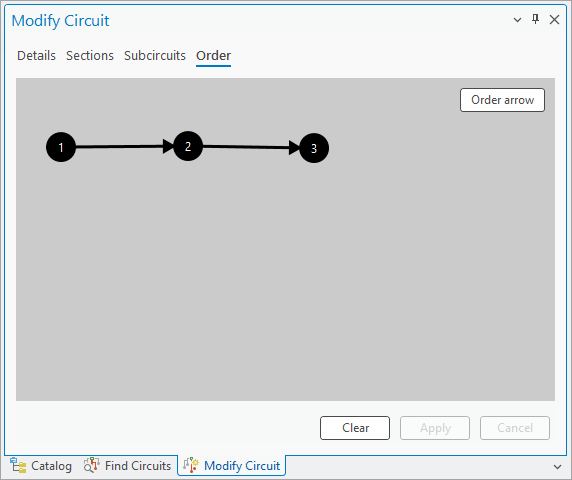

Modify a nonsectioned circuit in the pane
To modify an existing nonsectioned circuit using the Modify Circuit pane, complete the following steps:
  1. Click the Utility Network tab.
  2. In the Telecom Circuits group, click Find Circuits .
    The Find Circuits pane appears.
  3. Right-click a circuit listed on the grid to display the context menu, and click Modify Circuit.
    The Modify Circuit pane appears with the Details tab active and populated with details for the selected circuit.
    Nonsectioned circuits display the Details, Subcircuits, and Order tabs, and sectioned circuits display the additional Sections tab. All attributes for a circuit can be modified except Name.

Modify a sectioned circuit in the pane
To modify an existing sectioned circuit using the Modify Circuit pane, complete the following steps:

Configure section order
In the Circuit table, the Section order attribute field stores the logical connectivity graph between sections for a circuit. The Create Circuit and Modify Circuit panes allow you to graphically model the section order for a circuit using junctions to represent the circuit section and edges to represent the directed adjacency of sections.
The circuit illustrated in the image below has been modeled with three sections (1, 2, and 3) and modified to represent section 1 connected to section 2, and section 2 connected to section 3.
The Order tab in the Modify Circuit pane representing the section ordering of a circuit
The partial ordering of sections is stored as a JSON string in the Section order attribute field. For example, the section order for the circuit in the image above would be represented as {“1”:[2],“2”:[3],“3”:[]}.
To configure the section order for a sectioned circuit in the Create Circuit or Modify Circuit pane, complete the following steps:
  1. In the Create Circuit or Modify Circuit pane, for a circuit with multiple sections, click the Order tab.
    Each circuit section is represented using a numbered junction, corresponding with the sections defined in the Sections tab.
  2. Optionally, use the Sections tab to perform a path trace and visualize the section in the map by clicking the section, and clicking the Select button .
  3. On the Order tab, click the Order arrow button, and use the crosshairs pointer to select the from and to section junctions to specify connectivity between two sections.
    An order arrow is created to display directed connectivity between the sections.
  4. Optionally, use the Order arrow button to specify the section ordering for other sections in the circuit.
  5. Optionally, on the Order tab, right-click the order arrow, and click Remove to remove the ordering between two sections.
    To remove all ordering for a circuit, click the Clear button.
  6. Click the Apply button.
The circuit is created or modified with the section order specified.
