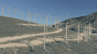

Animated wind turbine symbols in a scene

2D animated symbols contain a picture marker symbol layer that references an animated GIF source file (.gif). These symbols are intended to be used in maps, but they can also be used in scenes. They are animated when placed in the 3D Layers category of a scene. They are draped and static in the 2D Layers category of a scene.
Add the Animated system style to your project to see some 2D animated symbols in the symbol gallery. To create your own animated symbol, add a picture marker symbol layer to a symbol, and use an animated .gif file as the source file.
3D animated symbols
3D animated symbols contain a 3D model marker symbol layer that references a glTF source file with animation (.glTF). These symbols are intended to be used in scenes, but they can also be used in maps. They are animated when placed in the 3D Layers category of a scene. They are draped and static in a map, and in the 2D Layers category of a scene.
Add the 3D Animated system style to your project to see some 3D animated symbols in the symbol gallery. To create your own animated symbol, add a 3D model marker symbol layer to a symbol, and use an animated .glTF file as the source file.
