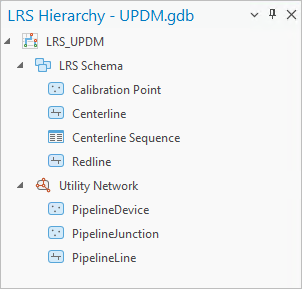

    In a combined LRS and utility network dataset, the Utility Network node is available.
    LRS Hierarchy pane for UPDM
