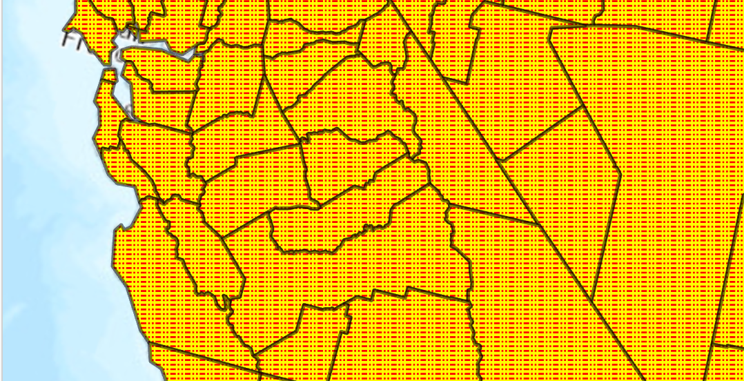

    Dash dot fill
    /// <summary>
    /// Create a polygon symbol with a dash dot fill. <br/>
    /// ![PolygonSymbolDashDot](https://ArcGIS.github.io/arcgis-pro-sdk/images/Symbology/polygon-dash-dot.png)
    /// </summary>
      //Note: Run withing QueuedTask
      var trans = 50.0;//semi transparent
      CIMStroke outline = SymbolFactory.Instance.ConstructStroke(CIMColor.CreateRGBColor(0, 0, 0, trans), 2.0, SimpleLineStyle.Solid);
      //Stroke for the fill
      var dashDot = SymbolFactory.Instance.ConstructStroke(ColorFactory.Instance.RedRGB, 1.0, SimpleLineStyle.DashDotDot);
      //Mimic cross hatch
      CIMFill[] solidColorHatch =
               new CIMHatchFill()
                  Enable = true,
                  Rotation = 0.0,
                  Separation = 2.5,
                  LineSymbol = new CIMLineSymbol(){SymbolLayers = new CIMSymbolLayer[1] {dashDot } }
               new CIMSolidFill()
                  Enable = true,
                  Color = ColorFactory.Instance.CreateRGBColor(255, 255, 0)
      List<CIMSymbolLayer> symbolLayers = [outline, .. solidColorHatch];
      //This is the polygon symbol with a dash dot fill
      CIMPolygonSymbol dashDotFillPolygon = new CIMPolygonSymbol() { SymbolLayers = symbolLayers.ToArray() };
      //To apply the symbol to a polygon feature layer
      //var renderer = theLayer.GetRenderer() as CIMSimpleRenderer;
      //renderer.Symbol = dashDotFillPolygon.MakeSymbolReference();
      //theLayer.SetRenderer(renderer);
