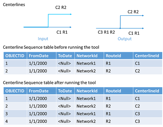

Removes overlapping centerline sections to ensure that there is one common centerline when centerline geometry overlaps.
The ArcGIS Location Referencing minimum schema models route concurrencies by having routes share the same centerline associations in the centerline sequence table. Running this tool may result in centerline changes, such as centerline splitting or deletion of duplicated centerline features. It may also update centerline sequence table records so that routes share centerlines.

Illustration
