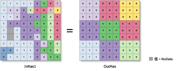

插图
OutRas = BlockStatistics(InRas1, NbrRectangle(3,3,"CELL"), "MAXIMUM", "DATA")
