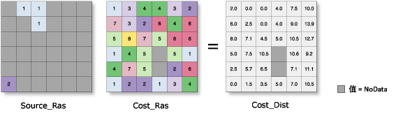

插图
成本距离图示
Cost_Dist = CostDistance(Source_Ras, Cost_Ras)
