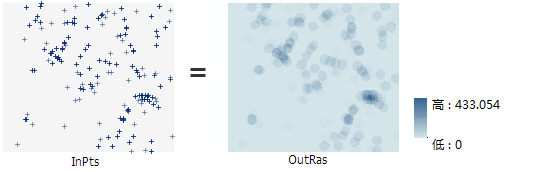

插图
OutRas = PointDensity(InPts, None, 30)
