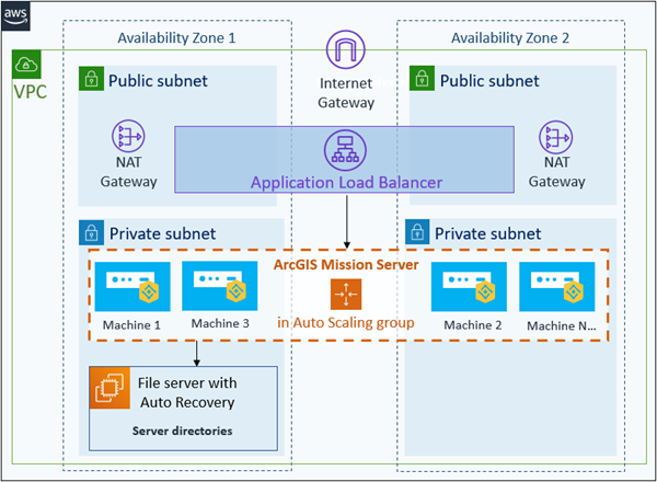

This template can create the following architecture in Amazon Web Services:
ArcGIS Mission Server site on multiple EC2 instances
