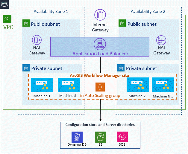

The following is an example of an architecture you can create on AWS using this template:
ArcGIS Workflow Manager site on multiple EC2 instances with CloudStore specified for the Configuration Store Type
