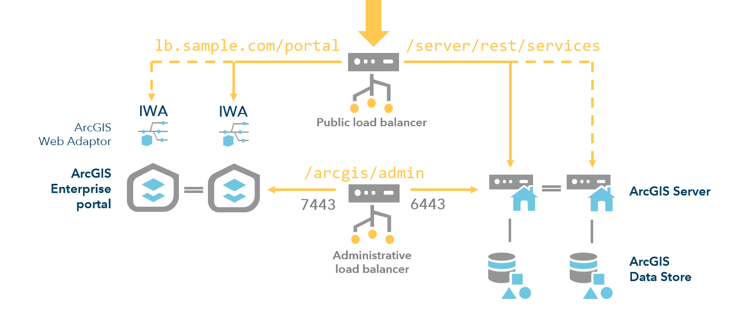

In both patterns, a load balancer is configured and acts as a gateway to the organization. Users other than administrators will always use the URL defined by the load balancer to access the portal and its items. The portal has two machines to ensure high availability.
The first pattern uses web-tier authentication to secure the portal, which requires the inclusion of ArcGIS Web Adaptor. To maintain high availability, two instances of ArcGIS Web Adaptor are configured, one with each portal machine. Traffic to the portal is routed from the load balancer to ArcGIS Web Adaptor, then to the portal.

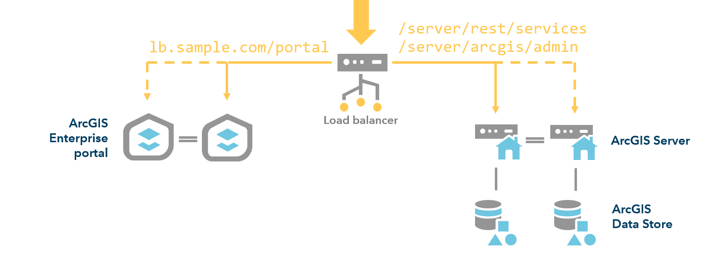

Highly available deployment with two load balancers
In the second pattern, the load balancer used for public, user facing traffic is also used for internal, administrative traffic. This is the pattern used by cloud deployment tooling for ArcGIS Enterprise.
Highly available deployment with one load balancer
