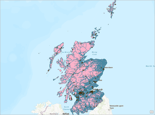

    A map of Scotland opens showing medical facilities, roads, and cities. The map is hard to interpret. The symbol colors are arbitrary, the roads are dense, and some layer names aren't very meaningful.
    Map of Scotland showing roads and medical facilities

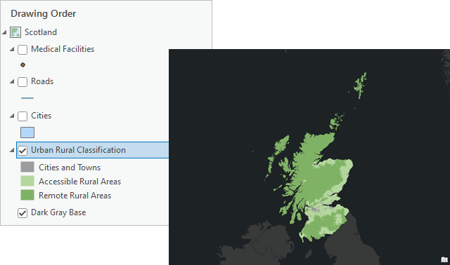

Symbolize the Urban Rural Classification layer
The Urban Rural Classification layer divides Scotland into urban and rural areas, but the current symbology doesn't show this. You'll explore the layer attribute table and change the layer symbology.
  1. In the Contents pane, uncheck the check boxes for the Medical Facilities, Roads, and Cities layers to turn them off. Leave the Urban Rural Classification layer turned on.
  2. On the Map tab, in the Navigate group, click Bookmarks . Click the Full Extent bookmark.

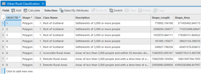

  3. In the Contents pane, right-click the Urban Rural Classification layer and click Attribute Table .
    Urban Rural Classification attribute table
    The layer has three land classifications. The values in the Class field correspond to unique class names and descriptions. People live in accessible rural areas, remote rural areas, or the rest of Scotland (settlements of 3,000 or more people).
    Tip:
    To widen a field, drag the vertical separator between field names.
  4. Close the attribute table.
  5. Right-click the Urban Rural Classification layer and click Symbology .
    The Symbology pane appears.
  6. In the Symbology pane, on the Primary symbology tab , click the Primary symbology drop-down arrow and click Unique Values . Confirm that the Field 1 value is set to Class.
    Unique values in the Class field of the attribute table will be used to symbolize the layer. You could also symbolize on the Class Name or Description fields.
  7. In the lower half of the pane, on the Classes tab, click Add all values .
    The map updates to show the three land classifications in unique colors.
  8. In the Symbology pane, on the Classes tab, in the Symbol column, click the symbol for value 1. This value represents areas defined by settlements of 3,000 or more people.
    The Symbology pane changes to show options for formatting polygon symbols.
  9. At the top of the pane, click the Properties tab. On the Symbol tab , click the Color button and click Gray 40%. Set the Outline width value to 0. At the bottom of the pane, click Apply.
    Color palette with Gray 40% indicated (row 5, column 1).
    The symbol is updated on the map and in the Contents pane.
  10. At the top of the pane, click Return to primary symbology page .
  11. On the Classes tab, in the Symbol column, click the symbol for value 2. This value represents rural areas within a 30-minute drive of a large settlement.
    The Symbology pane presents formatting options.
  12. On the Properties tab, on the Symbol tab , click the Color button and click Sage Dust. Set the Outline width value to 0. Click Apply.
    Color palette with Sage Dust indicated (row 7, column 7).

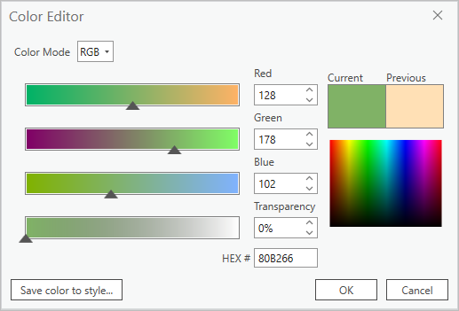

  13. Click Return to primary symbology page and click the symbol for value 3. This value represents remote rural areas.
    This time, instead of choosing a color from the palette, you'll make your own color.
  14. On the Properties tab, on the Symbol tab , click the Color button and click Color Properties.
    The Color Editor dialog box appears.
  15. On the Color Editor dialog box, click the Color Mode drop-down arrow and click RGB. Set the values as shown below, and press the Enter key after each change.
    • Red: 128.
    • Green: 178.
    • Blue: 102.
    Color Editor with applied settings
  16. Click OK on the Color Editor dialog box. In the Symbology pane, set the Outline width value to 0. Click Apply.
  17. Click Return to primary symbology page . On the Classes tab, click More and uncheck Include all other values.
    Tip:
    In a layer with many unique values, you may want to assign unique symbols to a few important features and a generic symbol, such as a gray fill, to the rest. That is the purpose of the Include all other values symbol. However, with only a few unique values, you don't need it.
  18. On the Classes tab, in the Label column, double-click the value 1 to make the label editable. Change the text to Cities and Towns and press the Enter key.
    After you commit the label change, the label for value 2 is automatically editable.
  19. For value 2, change the label to Accessible Rural Areas and press the Enter key. For value 3, change the label to Remote Rural Areas and press the Enter key.
    In the Contents pane, the layer shows the header Class above the updated symbols. The descriptive labels make this header unnecessary.
  20. In the Contents pane, under Urban Rural Classification, click the Class header and click again to make it editable. Press the Delete key and press the Enter key.
    Contents pane and map showing Urban Rural Classification layer
  21. On the Quick Access Toolbar, click Save Project .

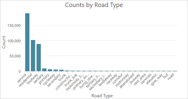

    The status bar at the bottom of the table shows more than 400,000 features in the layer. There aren't actually that many roads in Scotland—many of the features represent different segments of the same road.
  3. In the table, right-click the Road Type field heading and click Visualize Statistics .
    Bar chart showing the count of roads by type
    A bar chart appears showing the counts for each road type. The vast majority are service roads, residential roads, or footways. These are small, local roads that you don't need in the map. Your definition query will include five important road types—motorway, trunk, primary, secondary, and tertiary—and exclude the rest.
    Tip:
    Hover over a data marker to see the exact number of features it represents.
  4. Close the chart view, the Chart Properties pane, and the attribute table.
    In the Contents pane, the Counts by Road Type chart appears under the Roads layer. You can right-click the chart and click Open to reopen it.

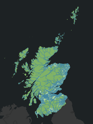

    Scotland map showing the Roads layer with the definition query applied
    There are now fewer than 20,000 road features in the layer.

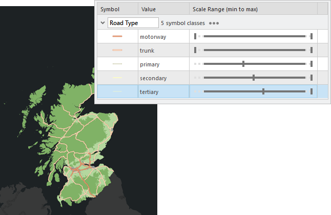

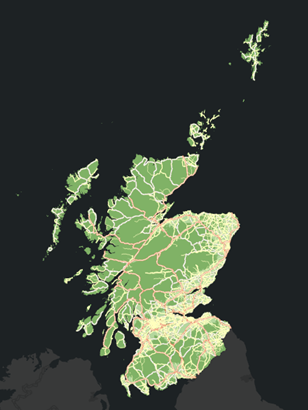

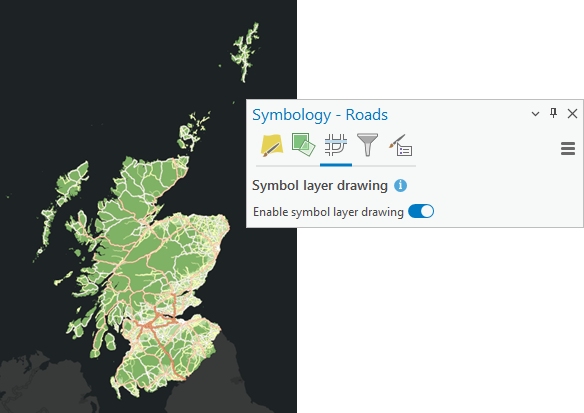

Symbolize the Roads layer
You'll choose unique symbols for the five road types included in your definition query. You'll set the feature drawing order to make major roads display on top of minor roads. Finally, you'll set visibility ranges for the road symbol classes so that smaller roads display only at larger map scales.
  1. In the Contents pane, right-click the Roads layer and click Symbology . In the Symbology pane, on the Primary symbology tab , click the Primary Symbology drop-down arrow and click Unique Values .
  2. Confirm that the Field 1 drop-down list is set to Road Type. If necessary, click the drop-down arrow and select this value.
    You'll symbolize the layer on the attributes in the Road Type field. The available attributes are those you specified in the definition query.
  3. On the Classes tab, click Add all values .
  4. Click More and uncheck Include all other values.
  5. In the list of values, click the row containing the value trunk to select it—but don't click the trunk symbol itself. Click Move selected values up until the row is just under motorway.
    Classes tab showing road types ordered by importance
    Your symbol colors may be different.
    The five road symbol classes are now ordered by importance. This order is reflected in the Contents pane, although not in the display of features on the map.
  6. In the Contents pane—not the Symbology pane—under the Roads layer, click the symbol for motorway.
    The Symbology pane shows options for formatting line symbols

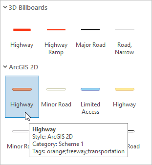

  7. At the top of the pane, click the Gallery tab if necessary. In the search box, type highway and press the Enter key.
  8. In the search results, under ArcGIS 2D, hover over the first Highway symbol. (Its category is Scheme 1.) Click the symbol.
    Symbol gallery showing a selected highway symbol and its ScreenTip
    Note:
    You may have fewer results if semantic search is not enabled.
  9. At the top of the pane, click the Properties tab. Set the Line width value to 2 pt and press the Enter key. Click Apply.
  10. In the Contents pane, click the other Road Type symbols in turn and change their values in the Symbology pane using the table below as a guide.
    Tip:
    Search for symbols by name on the Gallery tab, set their properties on the Properties tab, and click Apply to apply your changes.
    Value Symbol Color Line width
    trunk Major Road (ArcGIS 2D Scheme 1) Default 2 pt
    primary Minor Road (ArcGIS 2D Scheme 1) Default 1.5 pt
    secondary Default Yucca Yellow (row 1, column 5) 1 pt
    tertiary Default Yucca Yellow (row 1, column 5) 0.5 pt
    Map showing roads with symbology changes applied
    The roads don't draw in their symbol class order—if they did, the motorways would be on top of the other roads. By default, features in a layer draw in their database order (the order of their Object ID values in the attribute table). You'll override this behavior by turning on symbol layer drawing.
  11. In the Symbology pane, click Return to primary symbology page . At the top of the pane, click the Symbol layer drawing tab and click Enable symbol layer drawing.
    Symbology pane with symbol layer drawing turned on and updated map
    The road features now draw in the order that corresponds to their position in the Contents pane. Motorways draw on top, trunk roads draw underneath motorways, and so on.

  12. At the top of the Symbology pane, click the Primary symbology tab . In the lower half of the pane, click the Scales tab.
    By default, each road type is visible at all map scales. You may need to widen the Symbology pane to see the full scale range setting.
  13. In the Scale Range (min to max) column, set the slider positions as follows:
    • In the primary road type row, drag the left slider to 1:500,000.
    • In the secondary row, drag the left slider to 1:100,000.
    • In the tertiary row, drag the left slider to 1:50,000.
    On the map and in the Contents pane, only motorways and trunk roads appear. Other roads do not draw until you zoom in to larger scales.
    Scale range settings for symbol classes and updated map

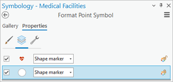

  4. Click the Properties tab and click the Layers tab under it.
    Symbols can be composed of one or more symbol layers. The Hospital symbol is composed of two symbol layers—a red heart on top of a white circle. These symbol layers can be modified independently.
  5. Click the white circle to select the symbol layer.
    Layers tab of the Symbology pane with symbol layers for the Hospital symbol
  6. Under the symbol layers, expand the Appearance section if necessary. Click the Color button and click Color Properties.
  7. On the Color Editor dialog box, change the Transparency setting to 50% and press the Enter key. Click OK on the Color Editor and click Apply in the Symbology pane.
    The white circles are now partially transparent.

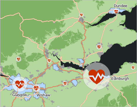

  8. In the Contents pane, ensure that the Medical Facilities layer is selected. On the ribbon, click the Feature Layer tab. In the Drawing group, click Aggregation and click Clustering .
    On the map, clusters of medical facilities are now represented by proportionally sized symbols. The clusters update dynamically as you zoom in and out on the map.

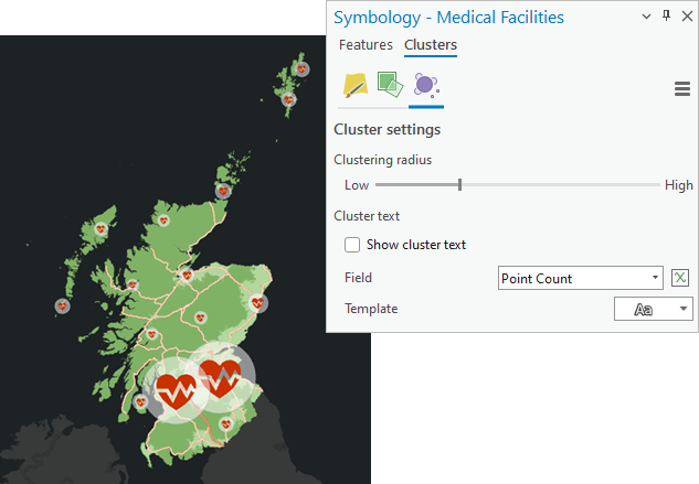

  9. At the top of the Symbology pane, click the Clusters tab and click the Cluster settings tab under it.
  10. Experiment by moving the Clustering radius slider to different positions.
    As the clustering radius becomes higher, more symbols are aggregated into fewer clusters.
  11. Move the slider to a position about one-third of the distance from the low end.
  12. Uncheck the Show cluster text check box to remove the count of medical facilities from the cluster symbols.
    The map with cluster symbols next to the Symbology pane showing the clustering radius setting
    Your results may look different depending on where you placed the Clustering radius slider.
  13. Zoom in and out on the map to see the number and size of clusters change.

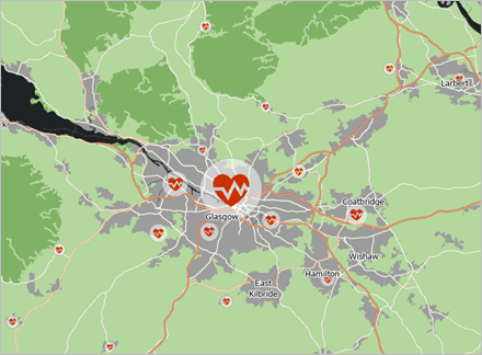

  14. Click the Map tab on the ribbon and go to the Glasgow bookmark.

    Glasgow and the surrounding cities are labeled with their names.

    On the map, only cities with populations of 100,000 or more are labeled. At the current bookmark, this includes Glasgow and Wishaw.

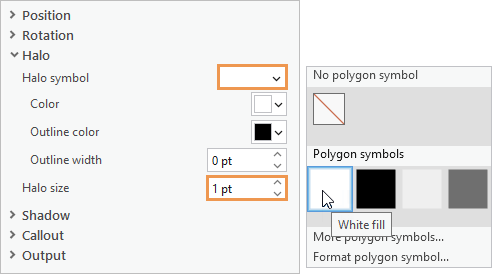

    You'll add a halo to help the labels stand out against different parts of the map. A halo is a background fill color that separates the label text from map features.
  11. Scroll down in the Label Class pane if necessary and expand Halo. Click the Halo symbol drop-down arrow. Under Polygon symbols, click the White fill symbol. Confirm that the halo size is 1 pt.
    White fill selected as Halo symbol
  12. Click Apply.

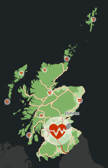

  20. At the bottom of the map view, click the map scale drop-down arrow and click 1:1,000,000.
    Map showing labels for large cities
    At this scale, only labels for large cities display.

    You should see one or more city labels. At the current map scale, the size of the cluster symbols around Glasgow and Edinburgh may suppress the labels for those cities. You can experiment with the clustering radius slider for the Medical Facilities layer to find an optimal setting.

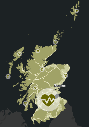

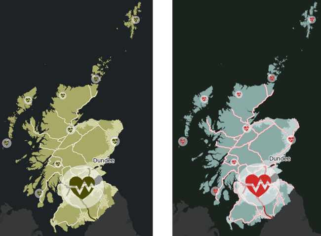

  1. On the ribbon, click the View tab. In the Accessibility group, click the Color Vision Simulator drop-down arrow and click Deuteranopia .
    Map simulating deuteranopia
    Deuteranopia (green blindness) is the most common color vision deficiency and results in confusion between green, red, and yellow hues. These hues are also easily confused by people with protanopia (red blindness). It's important that map symbols can be distinguished from each other in these different color environments.
  2. On the ribbon, click the Map tab and go to the Glasgow bookmark.
    The Urban Rural Classification layer can still be interpreted by a person with deuteranopia. The color of the medical facilities symbol blends in more due to the confusion of red and green hues, but the symbol shape allows it to stand out. The main accessibility issue is with the motorway symbol.
  3. Go to the River Clyde bookmark.
    The trunk, primary, secondary, and tertiary roads preserve adequate contrast with the background.
  4. Go to the Full Extent bookmark.
  5. In the Contents pane, under Roads, right-click the motorway symbol to open the color palette and click Cherry Cola.
    Color palette with Cherry Cola indicated (row 5, column 3).
    Motorways can now be distinguished on the map.
  6. On the ribbon, click the View tab. Click the Color Vision Simulator drop-down arrow and click Protanopia Protanopia (red blindness) and Tritanopia Tritanopia (blue blindness).
    Maps with the Color Vision Deficiency Simulator set to Protanopia (left) and Tritanopia (right)
    The map can be interpreted by viewers with the most common color vision deficiencies.
