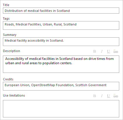

  2. On the Map Properties dialog box, click the Metadata tab.
    Metadata tab of the Map Properties dialog box
    When you share the web map, the information in these fields (except for the title) will be included in the web map's item details page.

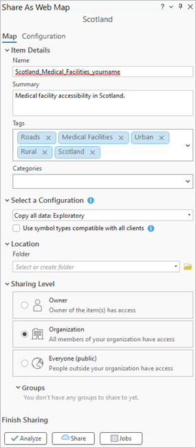

  1. On the ribbon, click the Share tab. In the Share As group, click Web Map .
    The Share As Web Map pane appears. At the top of the pane, the Map tab is selected.
  2. In the Name box, replace the default name with Scotland_Medical_Facilities followed by an underscore and your name or initials.
    Note:
    When you share a web map, a web layer is created with the same name as the map. Web layers in your ArcGIS organization must have unique names; therefore, giving the map a unique name prevents potential layer name conflicts. (Web maps don't need unique names unless they are stored in the same folder.)
    The Summary and Tags fields are filled in with information you saw in the map's metadata.
  3. Under Select a Configuration, click the drop-down arrow, if necessary, and click Copy all data: Exploratory.
    If your active portal is ArcGIS Online, this is the default configuration. If your active portal is ArcGIS Enterprise, you must select this configuration. To learn more about configuration options, see Share a web map.
    Note:
    The Use symbol types compatible with all clients check box converts ArcGIS Pro symbols to web symbols that render in all applications, including older clients like Map Viewer Classic. This may result in downgraded symbology. You'll work with the web map in Map Viewer, which supports ArcGIS Pro symbols, so you'll leave the box unchecked.
  4. Under Location, accept the default blank folder setting.
    When no folder is specified, the map is shared to the root level of your portal content.
  5. Under Sharing Level, click Organization.
    When the map is shared, everyone in your organization can open it in Map Viewer, ArcGIS Pro, and other ArcGIS apps.

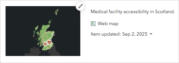

    The map's item page appears with the Overview tab selected at the top of the page.
    Web map item page
    Most of the information on the item details page comes from the map's metadata in ArcGIS Pro. You'll add terms of use.

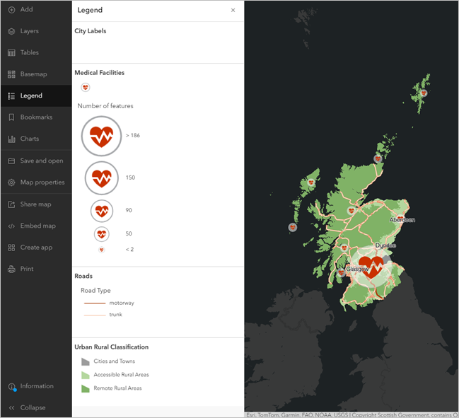

  2. On the Contents (dark) toolbar, click Legend .
    Scotland Medical Facilities web map
    The map legend appears.

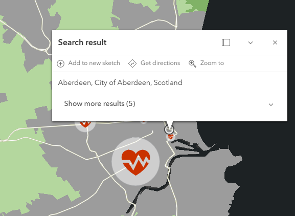

  5. On the map, click Search . In the search box, type Aberdeen, and press the Enter key.
    The map zooms to the location.

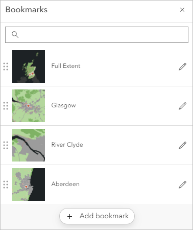

  6. In the Bookmarks pane, click Add bookmark. In the Title box, type Aberdeen and click Add.
    Bookmarks pane showing four bookmarks

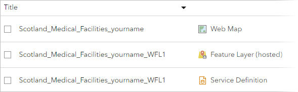

  10. At the top of the page, next to the map title, click the menu button and click Content.
    Items listed on Content page
    In the list of your content, you see the items created when you shared the map: the web map, the web feature layer, and a service definition file.

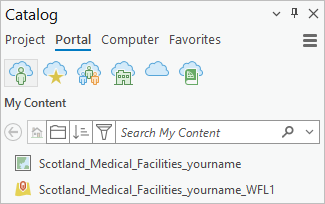

  1. In an open ArcGIS Pro project, in the Catalog pane, click the Portal tab. Under Portal, make sure the My Content tab is selected.
    Catalog pane showing web map
    The web map and web feature layer appear at the top of the content list (after any folders you have created). If you don't see them, click the Menu button and click Refresh .

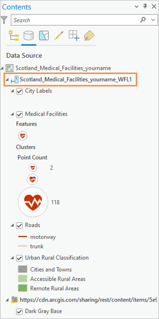

  5. In the Contents pane, click List By Data Source .
    Contents listed by data source
    The source of the map layers (excluding the basemap) is the web feature layer from your portal.

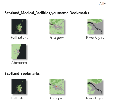

    You'll go to the bookmark you added in Map Viewer.
  7. On the ribbon, click the Map tab. In the Navigate group, click Bookmarks.
    Bookmarks list
    Bookmarks are displayed from both maps in the project.
  8. In the list of bookmarks, under Scotland_Medical_Facilities_yourname Bookmarks, click Aberdeen.

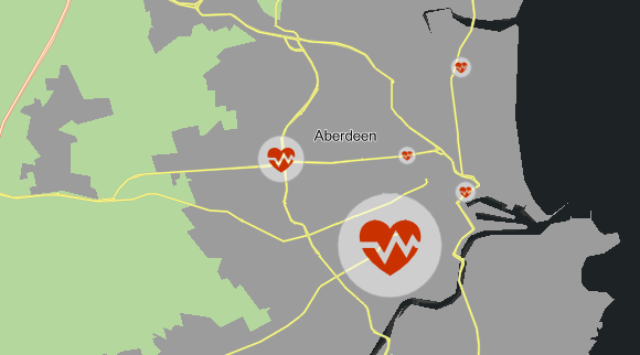

  8. On the web map's item page, click Open in Map Viewer.
    Map showing updated symbology for primary roads near Aberdeen
    The web map reflects the layer symbology and map extent that you saved in ArcGIS Pro.
    Note:
    The primary roads symbol has changed only in the web map. The Scotland_Medical_Facilities_yourname_WFL1 web feature layer itself is not changed. If you or a colleague adds the web feature layer to a new map, either in Map Viewer or in ArcGIS Pro, the primary roads will have the original light gray symbol. To change the web feature layer, you can overwrite it.

    In the list of content, you see the archived web map in addition to the web map. The archived map has a date/time stamp appended to its title and is shared to the map owner.
Web maps can be used to share geographic information within an organization, raise awareness of important topics for the general public, or publish map data for use in other projects. To learn how to share a 3D scene to your portal, try the Author and share a local scene quick-start tutorial.
