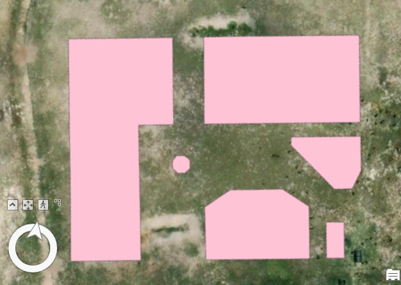

    A scene view zoomed to a proposed construction site in South Africa
    The project opens with a local scene view of building footprints for a proposed mall in Cape Town, South Africa. The scene also includes a default elevation surface layer.

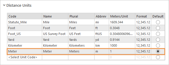

    Since this work takes place in South Africa, which uses the metric system, you'll confirm that the unit settings are correct.
  7. On the ribbon, click the Project tab.
  8. In the list of side tabs, click Options. On the Options dialog box, under Project, click Units.
  9. Expand Distance Units and confirm that the distance units are set to meters.
    Distance Units set to Meter on Options dialog box
  10. Click OK on the Options dialog box.

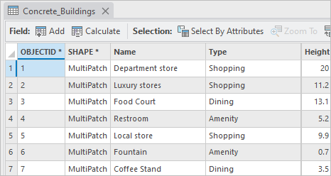

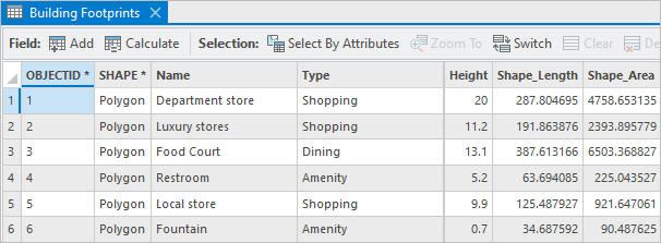

  3. In the Contents pane, right-click the Building Footprints layer and click Attribute Table .
    Building Footprints layer attribute table
    The Height field stores the height of each building in meters.

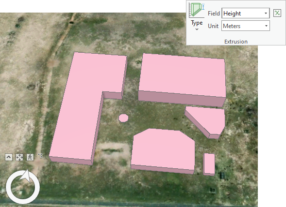

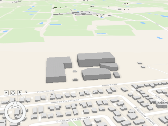

  5. In the Contents pane, confirm that the Building Footprints layer is selected. On the ribbon, click the Feature Layer tab.
  6. In the Extrusion group, click Type and click Max Height .
  7. Click the Field drop-down arrow next to the extrusion type and click Height. Confirm that the Unit setting is Meters.
    Buildings displayed at their actual heights in the scene
    In the scene, the buildings display at the heights stored in the attribute table. Because extrusion is a 3D property, the layer moves from the 2D Layers group to the 3D Layers group in the Contents pane.

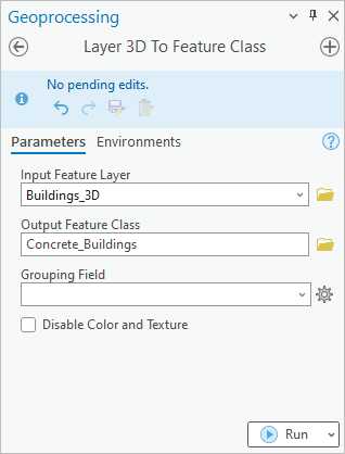

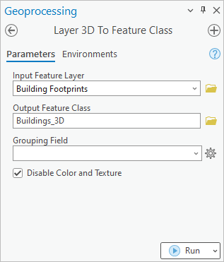

  1. In the Geoprocessing pane, in the search box, type Layer 3D To Feature Class. In the list of search results, click Layer 3D To Feature Class to open the tool.
  2. On the Parameters tab, click the Input Feature Layer drop-down arrow and click Building Footprints.
  3. In the Output Feature Class box, replace the default name with Buildings_3D.
    Tip:
    You can delete the entire path to the output feature class—it will be restored automatically.
  4. Check the Disable Color and Texture check box.
    Layer 3D To Feature Class geoprocessing tool
    When the new layer is added to the map, the pink color of the Building Footprints layer will not be preserved. You'll apply different symbology to the multipatch features later.
  5. Click Run .

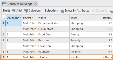

  6. In the Contents pane, right-click the Buildings_3D layer and click Attribute Table .
    In the Shape field, the geometry is MultiPatch. The descriptive attributes are the same as in the Building Footprints layer. Multipatch features don't have Shape_Length or Shape_Area fields.

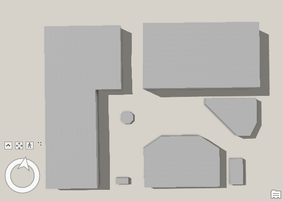

  1. On the Map tab, in the Navigate group, click Bookmarks . Click the Mall bookmark.

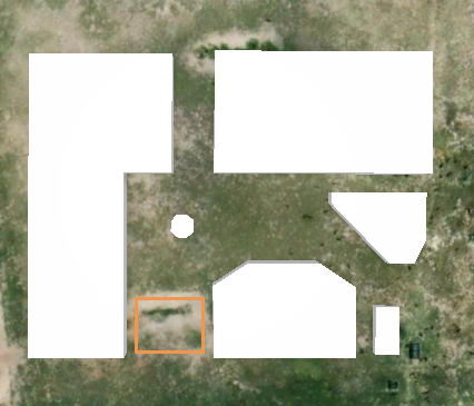

    You'll create a coffee stand feature between the luxury stores and the food court.
    Outline of the new coffee shop building location on the map
  2. Go to the Coffee Shop bookmark.

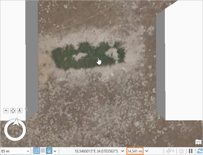

  4. Hover over the area between the two visible buildings.
    On the status bar, the elevation is around 14.5 meters.
    Your values will be slightly different depending on the exact location of the cursor.
    Elevation values for cursor location

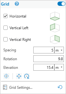

    You'll turn on a reference grid and set the grid rotation to match the scene rotation.
  7. On the status bar, click the Grid button to enable the reference grid.
    Status bar with Reference Grid button indicated
  8. Hover over the button to display the Grid pop-up menu. Make sure the check box next to Horizontal is checked. Set the Spacing to 5 m, and the Rotation to 9.8.
    The grid displays partially or entirely below the surface depending on the default setting in the Elevation text box. You will set the grid elevation to be slightly higher than the average elevation around the coffee shop so that the entire grid displays as close to the surface as possible.
  9. In the Elevation text box, change the value to 15.4 m.
    Grid settings
    The grid now displays above the surface for the area around the feature to be created. The grid lines are faint, but you'll change their color in a moment.

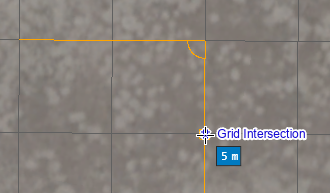

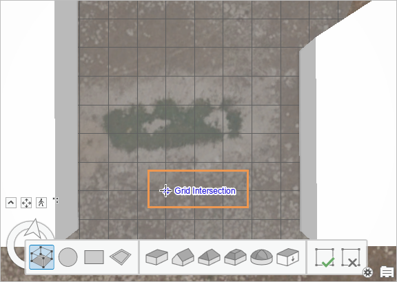

  4. Click the intersection of the grid in the location shown below to add the first vertex.
    Map showing cursor positioned on editing grid
    An on-screen snap tip appears at the grid intersection when you hover over it.
    Note:
    Your grid spacing may look different from the image, depending on the size of your scene view. It doesn't matter if your location matches the graphic exactly. However, if you make a mistake as you follow the next steps and need to start again, click Undo on the Quick Access Toolbar.

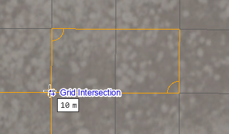

  5. Move the mouse pointer in any direction.
    Map showing cursor, edit sketch line, and constraint value
    As you move the mouse, a blue line connects the cursor to the last vertex you added. The constraint text box shows the distance of the line. You'll set the length to 10 meters.

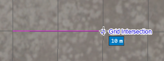

  6. Press the Tab key to highlight the current value in the constraint text box. Type 10 and press the Enter key to fix the distance.
  7. Following the grid line, move the mouse pointer to the right of the first vertex. Click the intersection of the grid lines to add a second vertex.
    The first side of the feature

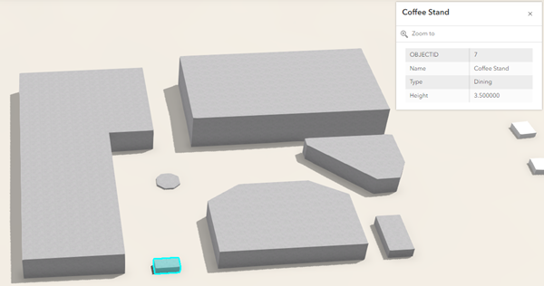

    3D building
    The building is now 3D and displays with a height of 3.5 meters.
  15. On the editing toolbar that appears near the bottom of your scene, click Finish .
    Note:
    If the editing toolbar is turned off, press the F2 key to finish.
    The new feature is selected in the scene.

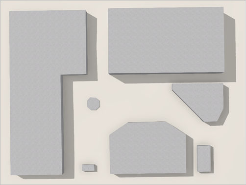

  5. Click the Multipatch Textures symbol.
    You'll change the default brick texture.

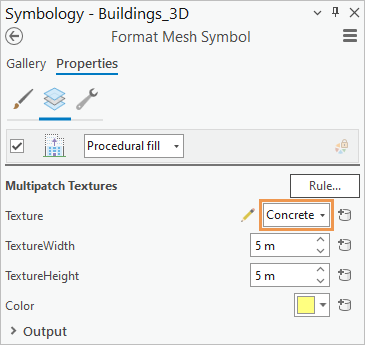

  6. At the top of the Symbology pane, click the Properties tab. Under it, click the Layers tab .
  7. Click the Texture drop-down arrow and click Concrete.
    The Layers tab of the Symbology pane
  8. At the bottom of the Symbology pane, click Apply.
    The layer is symbolized with the concrete texture.
  9. Explore the mall buildings from different perspectives.
    The symbology displays well in ArcGIS Pro. However, multipatch textures are not supported in web scenes unless they have been applied using the Layer 3D To Feature Class geoprocessing tool. Earlier, you ran this tool to convert 2D polygon features to multipatch geometry. Now you'll run it again to preserve the texture symbology when you share the scene to your portal.
  10. Make the Geoprocessing pane active.
    The Layer 3D To Feature Class tool is still open with its previous settings.
  11. On the Parameters tab, click the Input Feature Layer drop-down arrow and click Buildings_3D.
  12. In the Output Feature Class box, replace the name with Concrete_Buildings.
  13. Uncheck the Disable Color and Texture check box.
    When the box is unchecked, the symbology of the input layer will be preserved in the output layer. This ensures that the concrete texture will be applied to the buildings when you share the scene.

    The tool runs and the Concrete_Buildings layer is added to the scene. On the map, it looks the same as the Buildings_3D layer. The Concrete_Buildings feature class is added to the author_and_share_a_local_scene geodatabase.
  15. In the Contents pane, right-click the Buildings_3D layer and click Remove .
    Because of the World Elevation 3D layer, the scene displays elevation. However, the imagery basemap is 2D and the houses in the neighborhood of the planned mall are a flat picture. You will add a 3D basemap to enhance the scene. 3D basemaps are designed for local and global scenes and include 3D layers of buildings and trees.
    Note:
    Your active portal must be set to ArcGIS Online or to ArcGIS Enterprise 11.4 or later in order to use a 3D basemap. If your active portal is set to ArcGIS Enterprise 11.3 or earlier, you can continue using the current basemap and go to the next section.
  16. On the Map tab, in the Layer group, click Basemap . Under 3D Basemap, click Topographic.
    The new basemap is composed of a 2D topographic basemap and 3D layers of buildings, labels, and trees.
  17. Pan and zoom around the scene to see the 3D basemap features.
    Symbolized buildings with the 3D Topographic basemap

In the Concrete_Buildings layer attribute table, the new coffee stand feature has null values for its attributes. You will add the values manually.
  1. In the Contents pane, right-click the Concrete_Buildings layer and click Attribute Table .
    Concrete_Buildings attribute table with null values for the coffee stand feature
  2. In row 7, in the Name field, double-click the <Null> value. Type Coffee Stand, and press the Enter key.
  3. In the Type field, double-click the <Null> value, type Dining, and press the Enter key.
  4. In the Height field, double-click the <Null> value, type 3.5, and press the Enter key.
    Updated attribute table

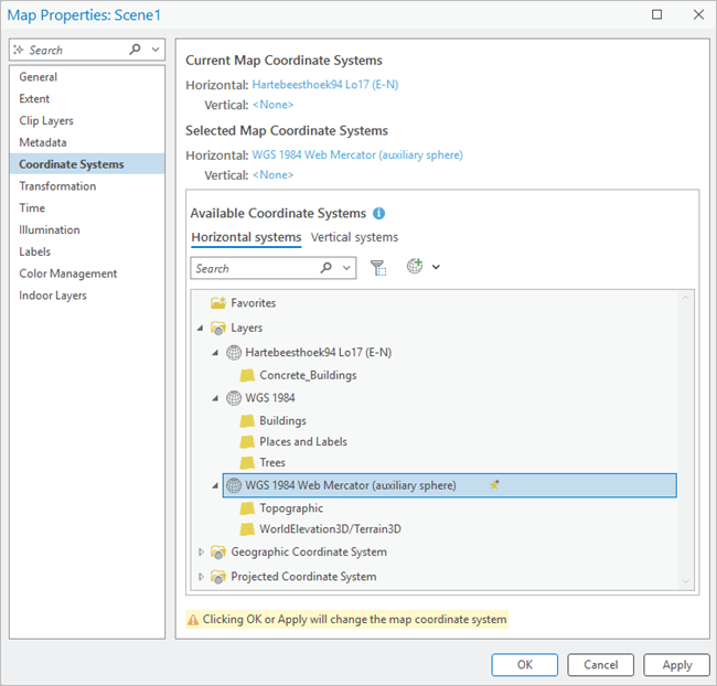

  12. Click the Coordinate Systems tab.
    The scene's current horizontal coordinate system is Hartebeesthoek94 Lo17 (E-N).
  13. Expand Layers and expand each of the three layer headings.
    The layers are in different coordinate systems.
    • The Concrete_Buildings layer is in the Hartebeesthoek94 Lo17 (E-N) coordinate system.
    • The Buildings, Places and Labels, and Trees layers are in the WGS 1984 geographic coordinate system. These layers are part of the 3D basemap.
    • The topographic basemap and elevation surface layer are in the WGS 1984 Web Mercator coordinate system.
    These different coordinate systems are reconciled through on-the-fly projection so that the data aligns properly. However, when you share a local scene to the web, its coordinate system must match the coordinate system of the basemap and elevation surface layers.
    At this point, the scene's current horizontal coordinate system has been reset to WGS 1984 Web Mercator, assuming this system is selected under Layers.
    Map Properties dialog box with Coordinate Systems tab settings
  14. Confirm that the current horizontal coordinate system is WGS 1984 Web Mercator (auxiliary sphere). Click OK.

  15. On the Map tab, in the Navigate group, click Bookmarks . Under Strandfontein Mall Bookmarks, click the Mall bookmark.
    Buildings with shadows
    Your shadows may look different depending on the time of day you chose in the illumination settings.

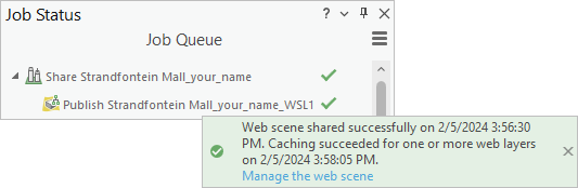

  10. Optionally, click Jobs to monitor the sharing status in the Job Status pane.
    When the web scene is successfully shared, a blue message appears at the bottom of the Share As Web Scene pane. At this point, you can open the web scene in Scene Viewer; however, the web scene layer is still being cached and may not draw fully. When the web scene layer finishes caching, the blue message is replaced by a green message to show that the process is complete.
    Job Status pane showing the completed job and success message on the Share As Web Scene pane

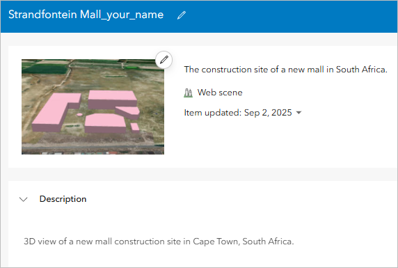

  11. When the green success message appears, click the Manage the web scene link in the message.
    A browser tab or window opens.
  12. If prompted, sign in to your portal to open the web scene's item details page.
    Item details page for the web scene
    The metadata you added in ArcGIS Pro appears on the page. You can edit this information on the item details page if necessary.

  16. Click a few buildings to see their pop-ups.
    Web scene with pop-up of building attributes

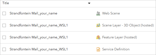

  18. At the top of the page, next to the scene name, click the options button and click Content.
    Web scene items in My Content
    You see the content that was created when you shared the scene: a web scene, a scene layer with its associated feature layer, and a service definition, which contains publishing specifications for the scene layer. You can add the scene layer to other web scenes.
