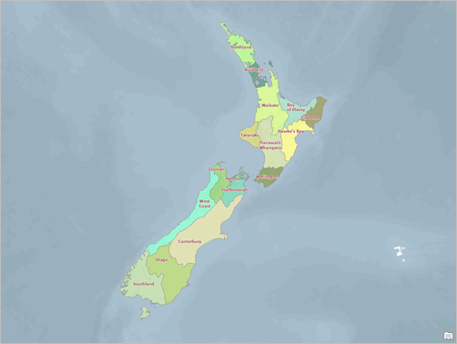

    The project opens with a map of New Zealand's regions labeled with their names.
    Regional map of New Zealand

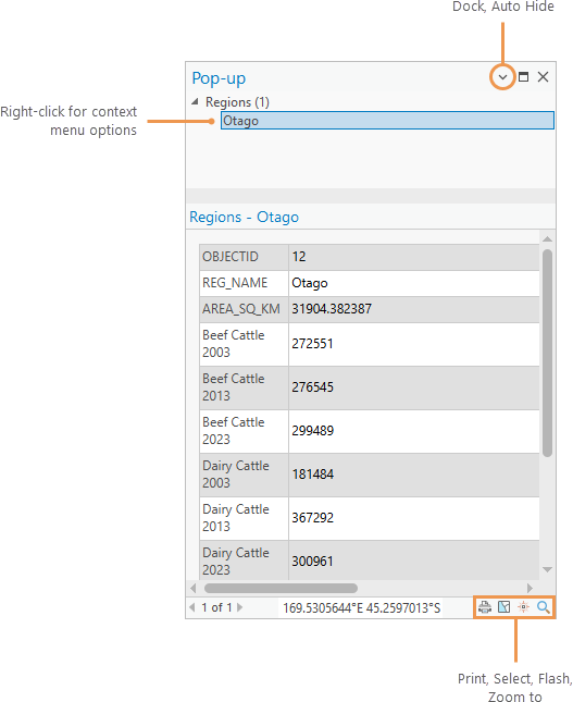

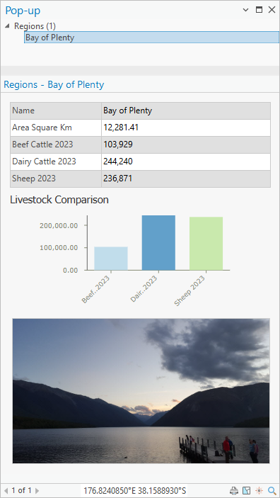

    Pop-up for Otago region
    The Pop-up pane displays attributes for the region. They include the region name, its area, and livestock counts for various years. These attributes are stored in a table associated with the Regions layer.
    Learn more about pop-ups
  4. In the Pop-up pane, scroll down, if necessary, to see all the attributes.

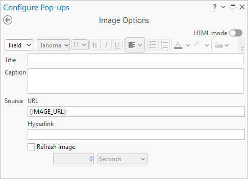

    The IMAGE_URL attribute stores a link to an online image. Later in the tutorial, you'll configure the pop-ups to display the images referenced by this attribute.
  5. Click another region on the map.
    The pop-up updates with the attributes for the region you clicked.

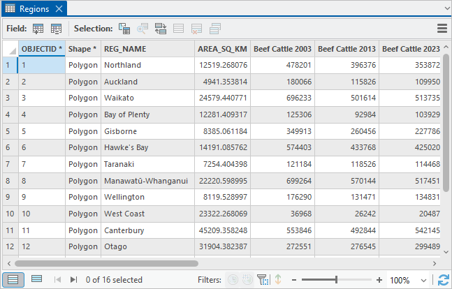

  7. Click the Data tab. In the Table group, click Attribute Table .
    Regions layer attribute table
    The Regions table opens. Each row, or record, in the table represents a region on the map. Each column, or field, represents an attribute.
    Note:
    Some regions have null values for certain attributes, but this does not impact the tutorial workflow.
  8. In the Regions table, click any row header (the numbered gray square at the start of a row) to select a record.
    The record is highlighted in the table, and the corresponding region is selected on the map.

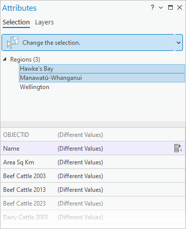

  14. On the ribbon, on the Map tab, in the Selection group, click Attributes .
    The Attributes pane appears. In the Attributes pane, you can view and edit attribute values for selected features. The currently selected features are listed in the upper half of the pane.
  15. One by one, click the regions listed at the top of the Attributes pane.
    The region you click flashes on the map, and its attributes are shown in the lower half of the pane.
  16. Press the Ctrl key and click a second region at the top of the Attributes pane.
    Attributes pane
    The Attributes pane compares the values of the two selected regions. In this case, the two regions have different values for all of their attributes. If they shared an attribute value—for example, the same number of beef cattle in 2003—that value would be displayed instead of the (Different Values) text.

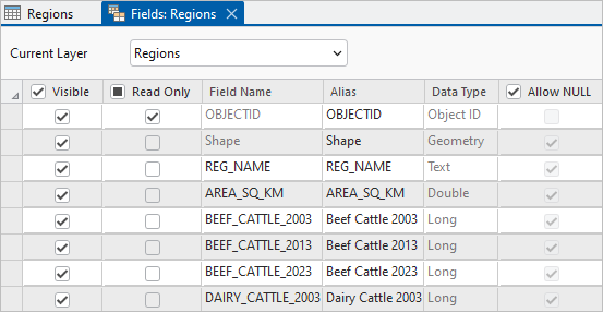

  1. If necessary, in the Contents pane, click the Regions layer to select it.
  2. On the ribbon, click the Data tab. In the Data Design group, click Fields .
    Fields view of the Regions table
    The Fields: Regions view opens, allowing you to work with the fields of the Regions table. In the fields view of a table, each row represents a field and each column represents a field property, such as the field name or data type.
  3. In the Visible column, uncheck the box in the column heading to turn off visibility for all fields in the table.
  4. Scroll down through the fields view. In the Visible column, check the boxes for the following fields to make them visible:
    • REG_NAME
    • AREA_SQ_KM
    • BEEF_CATTLE_2023
    • DAIRY_CATTLE_2023
    • SHEEP_2023
    Fields that are not visible do not display in the attribute table, the Attributes pane, or pop-ups, and are not available for table operations. You can make these hidden fields visible again at any time.
  5. In the Alias column, double-click the REG_NAME alias to make it editable. Replace it with Name and press the Enter key.
    Caution:
    Be sure to change the alias—the display name for the field—and not the field name itself. Both are editable.
  6. Double-click the AREA_SQ_KM alias to make it editable. Replace it with Area Square Km and press the Enter key.
    Fields view of the Regions table with aliases applied
    The fields containing livestock attributes are already aliased.

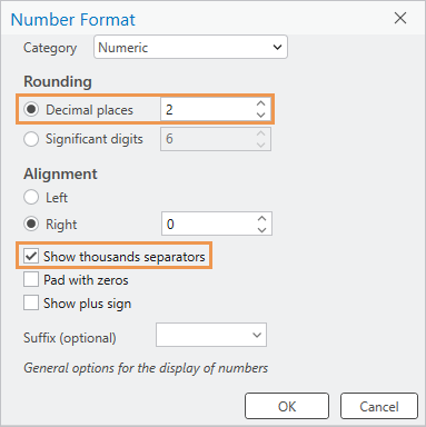

  7. In the Number Format column, double-click the cell for the AREA_SQ_KM field. In the cell, click the Determine display formatting for numeric and date field types button that appears.
  8. On the Number Format dialog box, under Rounding, change Decimal places to 2. Check the Show thousands separators check box.
  9. Click OK.
    The formatting will make the numbers easier to read.
  10. In the Number Format column, double-click the cell for the BEEF_CATTLE_2023 field. In the cell, click the Determine display formatting for numeric and date field types button.
  11. On the Number Format dialog box, check the Show thousands separators check box. Click OK.
  12. Change the number format for the following fields to show thousands separators:

  15. In the Regions table, right-click any row header (the numbered gray square at the start of the row) and click Pop-up .

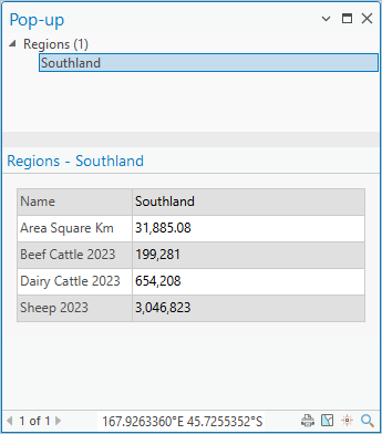

    Pop-up for Southland region
    Your field design changes are reflected in the pop-up. However, the changes have been saved only to the current ArcGIS Pro session. To make them permanent, you must save the project.

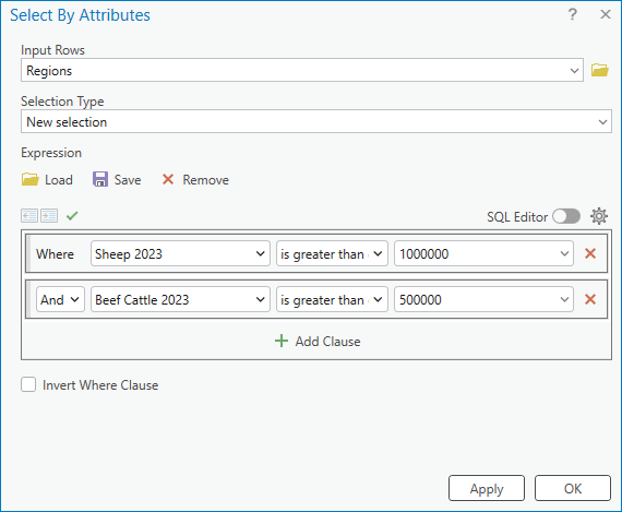

  1. On the ribbon, click the Map tab. In the Selection group, click Select By Attributes .
    The Select By Attributes window appears. The Input Rows parameter is correctly set to Regions. The Selection Type parameter is correctly set to New selection.
    Note:
    For convenience, some geoprocessing tools open in a floating window. These tools can also be opened in the Geoprocessing pane. In the Geoprocessing pane, this tool is called Select Layer By Attribute, but it is the same tool.
  2. In the clause builder, click the Where drop-down arrow and click Sheep 2023.
    When you select a field, two more text boxes appear.
  3. Click the drop-down arrow next to is equal to and click is greater than or equal to. Click the empty text box and type 1000000 (1 million).
    Clause in the Select By Attributes window
    You can hover over a parameter to see its full text as a ScreenTip.
    This clause selects regions that have 1 million or more sheep.
  4. Click Add Clause to build a second clause.
    A second clause is added with a logical operator to connect the clauses. The operator defaults to And, which is what you want in this case. Both clauses must be true for a region to be selected.
  5. In the second clause, click the drop-down arrow to select a field and click Beef Cattle 2023. Click the drop-down arrow next to is equal to and click is greater than or equal to. Click the empty text box and type 500000 (five hundred thousand).
    Select By Attributes dialog box
  6. Click OK.

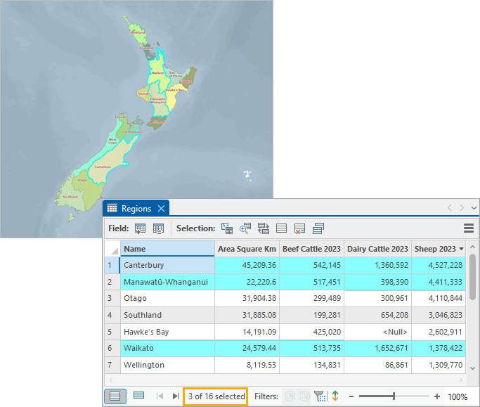

    The operation runs and three regions—Canterbury, Manawatū-Whanganui, and Waikato—are selected in the table and on the map.
    Map and table showing selected regions

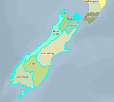

  1. On the map, make sure that you can see all the regions on the South Island.
  2. On the ribbon, on the Map tab, in the Selection group, click the Select drop-down arrow and click Polygon .
  3. On the map, draw a polygon that encloses or intersects all the regions on the South Island and no regions on the North Island. Click to begin drawing the polygon, click to change direction, and double-click to finish.
    Regions on South Island selected on map
    Seven features should be selected on the map. The message Selected Features: 7 appears in the status bar. If you have a different number, clear the selection and try again. A small region that's easy to miss is Nelson, which lies between Tasman and Marlborough.

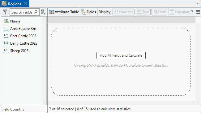

    The Data Engineering view for the Regions layer appears. It is composed of a fields panel and a statistics panel.

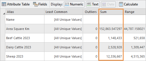

  7. In the statistics panel, click Add All Fields and Calculate.
    The fields from the Regions table are added to the statistics panel and calculated. In the status bar, you can see that the statistics are based on the seven selected records.
  8. In the statistics panel, right-click the Alias column heading and click Freeze/Unfreeze .
    The Alias column becomes the first column in the table and stays in view as you scroll.
  9. In the statistics panel, scroll to the right and locate the Sum column.
    Statistics panel showing total livestock values for the South Island
    In the Sheep 2023 row, you can see there are 12,336,667 sheep.

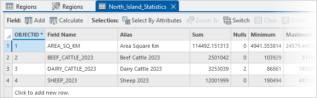

  12. Make the Data Engineering view active. In the row of tools at the top of the view, click Calculate to update the statistics.
    The total number of sheep on the North Island is 12,001,999. The South Island has more sheep, but the difference is fairly small.

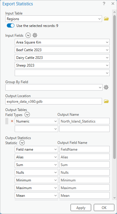

Export statistics as tables
You'll save the North Island statistics by exporting the statistics in the Data Engineering view to a stand-alone table.
Tip:
You can also use the Summary Statistics geoprocessing tool to get statistics for a table.

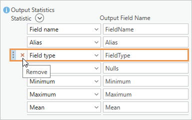

  1. In the Data Engineering view, in the row of tools at the top of the view, click Statistics Panel Settings and click Export Statistics As Table .
    The Export Statistics geoprocessing tool appears in a floating window. This tool can also be opened in the Geoprocessing pane, where it is called Field Statistics To Table.
    On the tool, most of the parameters have default settings. Under the input table, a toggle button indicates that only the nine selected features are used. The default output location—explore_data_v360.gdb—is the project's default geodatabase.
  2. Under Input Fields, hover over the Name field and click Remove to remove the field.
    Input Fields list with Name field indicated
    There are no useful statistics for the Name field.
  3. Under Output Tables, click the Field Types drop-down arrow and click Numeric.
    Field Types drop-down list with Numeric option indicated
    This ensures that all fields in the output table are formatted as numeric fields.
  4. In the Output Name text box, delete the default name and type North_Island_Statistics.
  5. Under Output Statistics, hover over the Field type statistic. Click Remove to remove the statistic from the table.
    List of output statistics with Field type indicated
  6. Remove the following statistics in the same way. Be sure not to remove the Sum statistic.
    • Mode
    • Least common
    • Outliers
    • Interquartile range
    • First quartile
    • Third quartile
    • Coefficient of variation
    • Skewness
    • Kurtosis
    Tip:
    If you remove a statistic accidentally, click Add Many at the top of the output statistics list. In the drop-down window, check the box for the statistic and click Add.
  7. Hover over the Sum statistic. Click the row identifier button and drag the row to the position under the Alias statistic.
    As you drag the row, its current position is indicated by a horizontal gray line.
    Export Statistics tool with completed settings
  8. Click OK to run the tool.
    When the tool completes, the North_Island_Statistics table is added to the Contents pane under Standalone Tables. A South_Island_Statistics table already exists.
  9. In the Contents pane, under Standalone Tables, right-click North_Island_Statistics and click Open .
    North Island statistics table
  10. Optionally, format the fields in the North_Island_Statistics table to show thousands separators and fewer decimal places.
    1. In the Contents pane, right-click North_Island_Statistics, point to Data Design, and click Fields .
    2. In the Number Format column, double-click the cell for the Sum field. In the cell, click the Determine display formatting for numeric and date field types button that appears.
    3. On the Number Format dialog box, check the Show thousands separators check box and click OK.
    4. Change the number formatting for the other fields to show thousands separators and change the number of decimal places to 2, as needed.

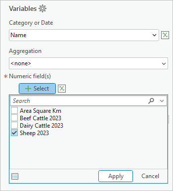

  3. At the top of the Chart Properties pane, confirm that the Data tab is selected. Click the Category or Date drop-down arrow and click Name.
    In the chart view, the region names appear on the chart's x-axis. At the moment, the chart displays the number of region names per region (which is 1). You must choose the field values that you want to chart.
  4. In the Chart Properties pane, click the Aggregation drop-down arrow and click <none>.
  5. Under the Numeric field(s) heading, click Select and check the Sheep 2023 check box.
    Data tab of the Chart Properties pane with Sheep 2023 field selected
  6. Click Apply.
    The chart's y-axis and data bars update to show the number of sheep in each region.

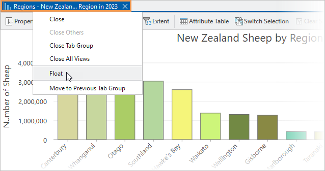

  13. In the chart view, right-click the view tab and click Float.
    Context menu for the chart view tab with Float option indicated
    The chart view is undocked from the application window.

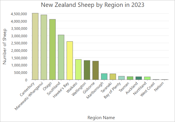

    Bar chart
    The regions are labeled on the x-axis and data values are labeled on the y-axis. The orientation of the region labels depends on the best fit. It is probably diagonal, as in the image above, but may be horizontal or vertical. The number of data values you see depends on the height of the chart.

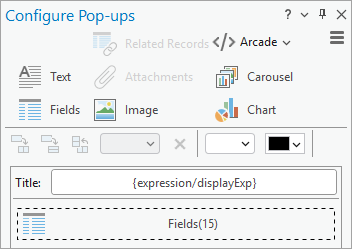

  1. In the Contents pane, right-click the Regions layer and click Configure Pop-ups .
    Configure Pop-ups pane
    The Configure Pop-ups pane appears. It consists of the following sections:
    • Commands to add elements to a pop-up
    • Tools to arrange elements
    • Current pop-up elements (by default, these include a title and a fields element)
    • Buttons to disable pop-ups, add expressions, format fields, and reset the configuration.

  3. On the map, click a region to open its pop-up.
    The upper part of the pop-up is a tree view that lists the identified features (in this case, there is only one). The lower part shows the currently configured pop-up elements: the title—made up of the layer name followed by the region name—and the five visible fields of the attribute table.

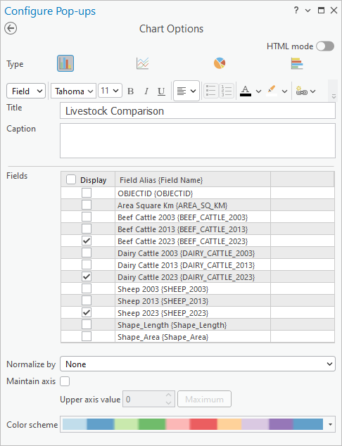

  5. At the top of the Configure Pop-ups pane, click Chart to add a chart to the list of elements.
  6. Hover over the Chart element and click Edit pop-up element .
    Chart element with Edit command indicated
    The pane shows options for working with charts.
  7. In the Title text box, change the default title to Livestock Comparison.
  8. In the Caption input box, delete the default caption.
  9. In the Fields list, check the boxes for the following fields:
    • Beef Cattle 2023
    • Dairy Cattle 2023
    • Sheep 2023
    Chart Options in the Configure Pop-ups pane

  11. At the top of the pane, click Image to add an image to the list of elements.
  12. Hover over the Image element and click Edit pop-up element .
    The pane shows options for working with images.
  13. In the Title box, delete the default title.
  14. In the Caption box, delete the default caption.
  15. Click in the Source URL input box. At the top of the pane, click the Field drop-down arrow and click IMAGE URL {IMAGE_URL}.
    Image options in the Configure Pop-ups pane
    Note:
    The Field drop-down list shows both the alias, IMAGE_URL, and the name {IMAGE_URL} in curly brackets. In this case, the alias and the name are the same.
    When you click a region on the map, the linked image in the corresponding table record is displayed in the pop-up. Since a different link is stored in each record, you'll see a different image for each region.

  17. Click a region on the map to see its pop-up.
    Configured pop-up
  18. Click some other regions to see their pop-ups.
    You can hover over the data bars on the chart to see the exact numbers of beef cattle, dairy cattle, and sheep in each region. You can also hover over the x-axis values to see the full field names.
