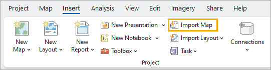

Import a document
You can import an ArcMap (.mxd), ArcGlobe (.3dd), or ArcScene (.sxd) document using the Import Map tool on the Insert tab of the ribbon.
