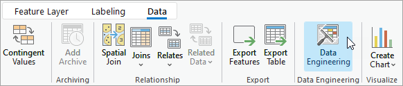

  1. Select the layer in the Contents pane.
  2. On the layer's Data contextual tab, click Data Engineering.
    Data Engineering button on the Data contextual tab
    Alternatively, right-click the layer in the Contents pane, and click Data Engineering.

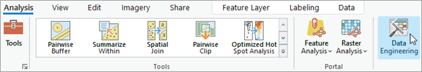

  2. On the Analysis ribbon tab, click Data Engineering.
    Data Engineering button on the Analysis ribbon tab
    When accessing the view from the Analysis ribbon, the Data Engineering button is not available if no layer is selected in the Contents pane or if the layer is not a supported layer type.

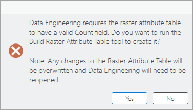

    If the raster layer does not have a raster attribute table, a pop-up appears.
    Data Engineering pop-up to build a raster attribute table
  3. Click Yes, and use the Build Raster Attribute Table tool to build a raster attribute table.
    Once complete, re-open the Data Engineering view.

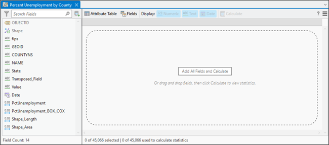

A Data Engineering view contains two panels: the fields panel and the statistics panel. The fields panel lists the fields in the layer you used to open the view. Use the contents of this panel to explore fields, change symbology, produce charts for fields, or go to fields in the attribute table. Use the statistics panel to explore the values and distribution of the data by viewing statistics and data quality metrics. The panel's statistics table is empty by default until you add fields from the fields panel.
Data Engineering view with fields panel and empty statistics panel
