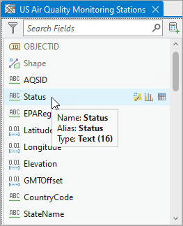

Display a list of fields
After you open the Data Engineering view, the fields panel displays field aliases of all the visible fields of the selected layer. Each field listing includes an icon corresponding to the data type for each field. Hover over a field to see the field name, field alias, and field type.
Fields panel
The data type icon indicates when a field is sourced from a joined table .
You can specify which data types are displayed by applying filters using the filter button at the top of the panel.
You can search for specific fields by providing text in the Search Fields text box .
A count showing the number of fields in the layer is displayed at the bottom of the fields panel. When a filter or search is applied, the number of fields matching the filter or search is also shown.
To change the displayed field aliases to field names, click the Filter button and change the Display Field by option to None.
